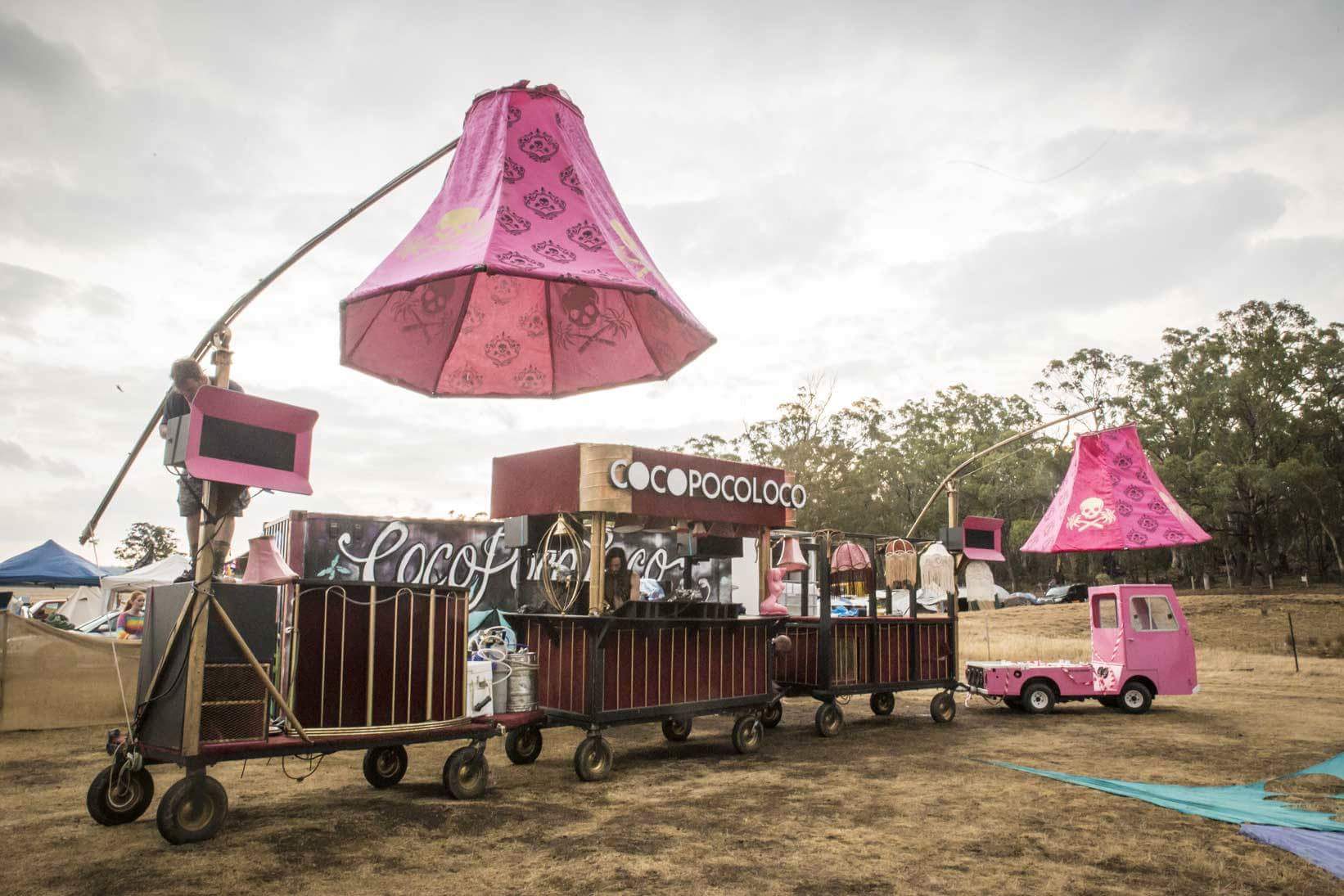

Glad you were able to finish in time for the event, the picture makes me want to head "down under" again, looks like a good time!

Any louder and it got uncomfortable to listen too. You dont realize how loud they are because they are so clean...and I didn't want to blow the compression drivers so I went easy.
We also ran out of power on the sub-woofer amplifier, which limited the sub output. Though the balance of volume was just right over all.
I didn't measure them, but I estimate the subs run about 6db louder than the syntripps. We like big bass so we add some extra.
Subs are 35-100 - 24db BW both ends.
Syntripps 80 - 950 / 950 to infinity (and beyond) with 24BW on the lower, 18LW on the mid-high.
Need a new sub amp. Got a friend who has access to Crown and Lab Gruppen at wholesale! He may be able to help us out!

There were two funktion one arrays nearby, which by comparison sounded terrible after listening to the syntripps.
People would leave, then come back in about 20 minutes noting it was way nicer at Coco Poco Loco.
Perhaps the track selection did help alot! 🙂
Although I had a small part in helping Art model the Syntrippi and believe it to be a great sounding speaker, like a lot of pro sound reinforcement systems, proper setup is important in getting the proper sound quality out. Are you certain the F1's were setup properly? Not sure if fair comparisons can be made at face value.

Setup of the Artcar.
