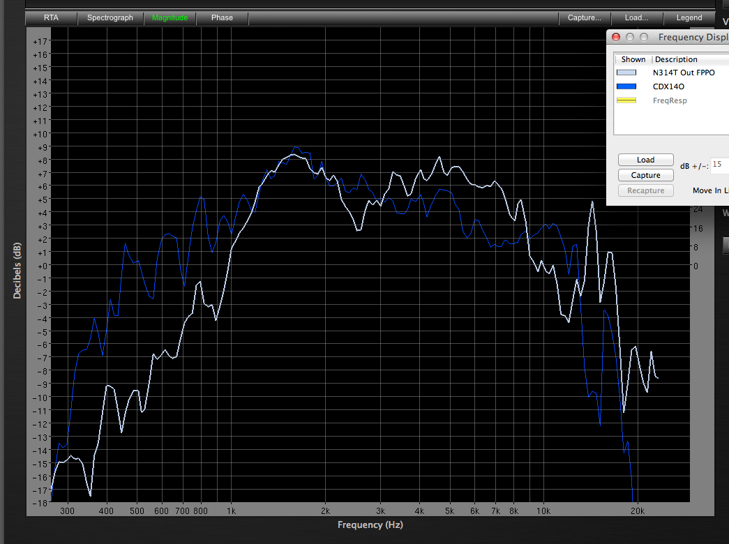

Art: Have you had a chance to test that Eminence compression driver yet?
Fin,
Yes, reported findings in post #165.
Below is the response of the Eminence N314T compared to the (first purchased) Celestion CDX14-3050 both on a Maltese conical horn.
Art

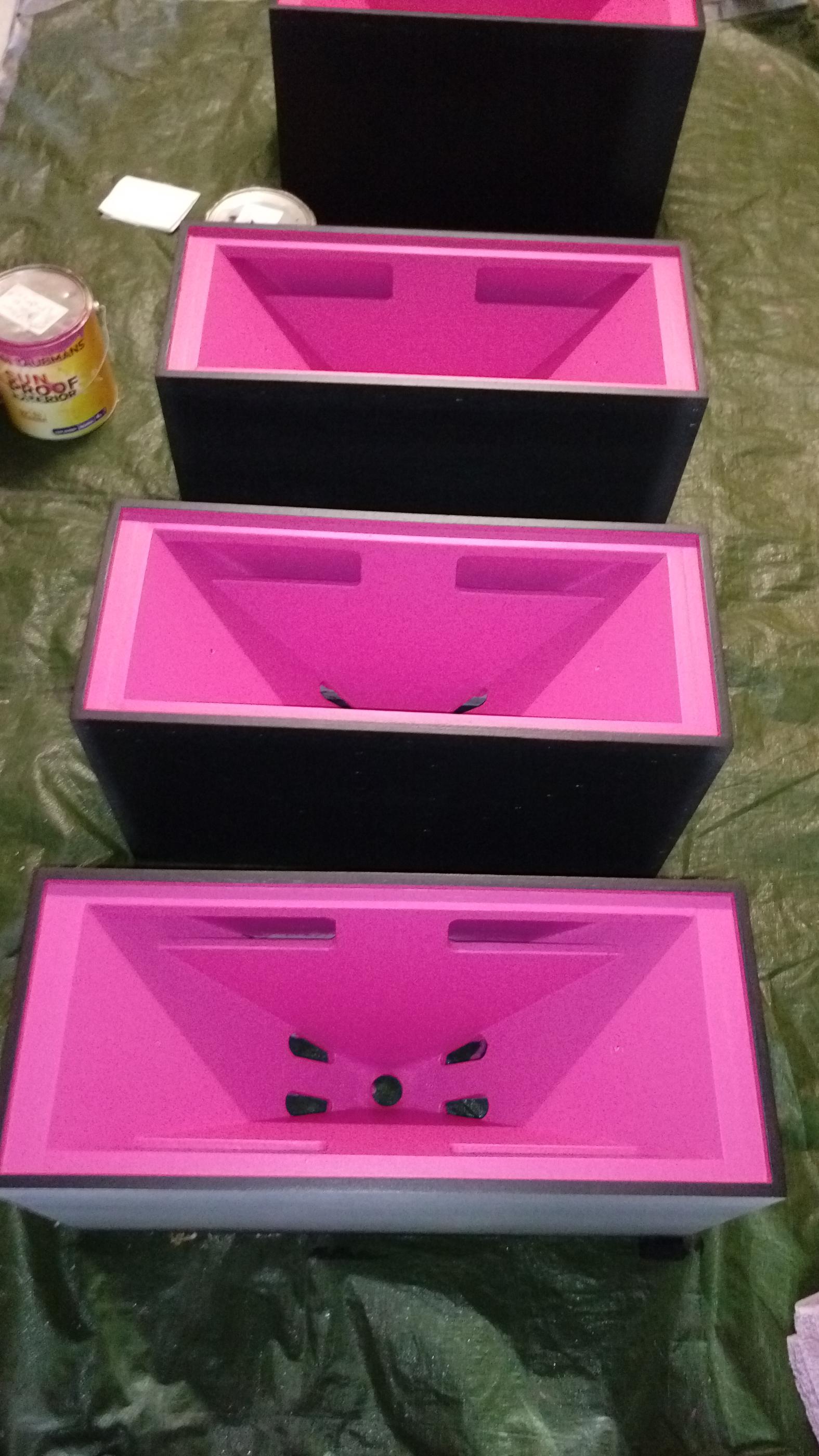

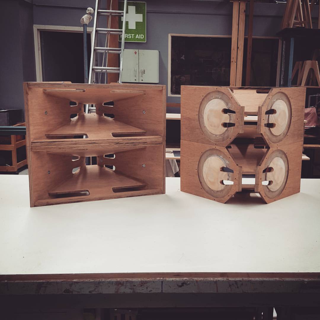

Hi All!
The build is going well. I was going to hold off posting anything more so as not to make a mess of the thread for those who will read this in future.
We are paining now, all parts have arrived, and we are working on mounting them. (our mounts are different in requirement, we are actually flying two of them!)
The plans will be revisited in Feb when the festival is over.
For now, its busy time finishing the build, and getting ready to roll out!
Will post pictures of the artcar with the SynTripP array on board late Jan!

WOW!
They work amazingly...!!!
We had 600 people stay for 5 hours. We watched the moon set in front of us, and half an hour later the sun rise behind us!
Emancipator came and played sunrise!
Our system was louder than a four way single stack Funktion One, and was substantially cleaner. Far less distortion. Superb sound. We made the huge F1 arrays sound crap by comparison.
We used two for mains, and two for the DJ fills. Supported by two XoC1 TH18's Loaded with B&C 18SW115 drivers.
The Fills were running at a lower volume to fill in the front section of the dancefloor where the main horns were unable to reach. Beautiful sound everywhere, though I need a second DSP for the fills to align the timing...
They roll off at 80hz naturally, but even at 115 db the mid drivers are still only moving a few mm p-p. At painful volume levels It's quite remarkable how little the drivers move. I think 4mm p-p was about it at program power of the drivers, and far louder than I dared to stick my head near.
They need 4" of fiberglass to get the resonance out of the box, but other than that they are flawless. They looked great panted pink and black!
As usual, I am slack at taking pics....waiting for others to put some up!
