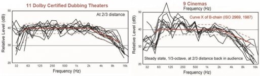

And then there's the movie industry which is so proud of their "standards":
attachment.php
