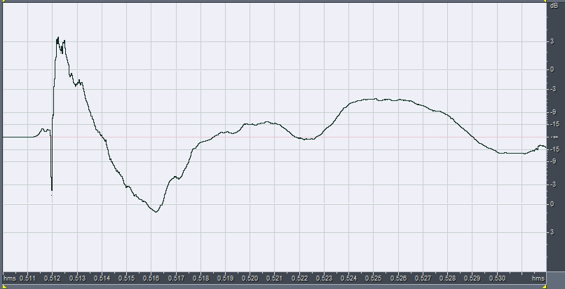

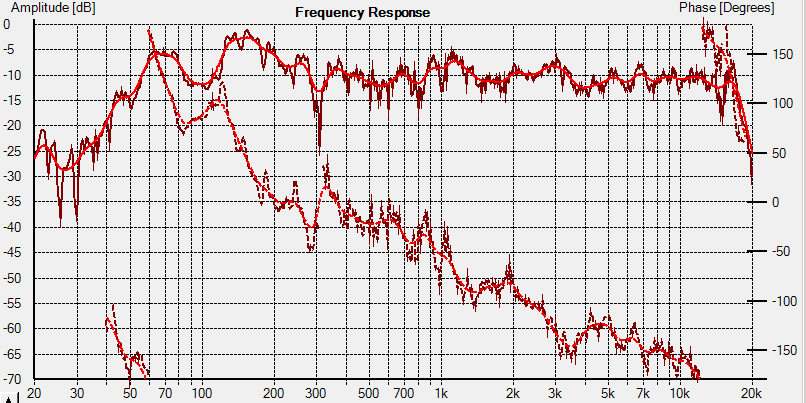

OK, here the promised plots for the SH50, frequency response (incl. phase) and step response, using the "1m livingroom" file that Tom provided.
To me, after adjusting the phase reference to give a quite flat picture in a lin. frequency plot (no overall slope of a dead time), it looks even better than the original plot, only about 180 shift from the XO alone, the range below 200Hz is dominated by the bass rolloff.
One trace is the unsmoothed raw response while the other has a frequency dependant windowing applied, with a 1/4.5 octave smoothing. This gives a cleaned up trace with still enough detail (1/3 is too much smoothing).
The step response (1msec/div) is correspondingly nice, only the very HF is "inverted". Also not the initial rise of the woofers which is modified after ~3ms by the other drivers "kicking in the right way" to keep the response close to zero upt to the point the HF driver's edge emerges.

Thanks for the plots, KSTR. What do you mean by "frequency dependant windowing" ? Just the normal gate in HOLM, or something else?

Even at a relatively close 1m and with high directivity in a well damped room, the phase response will be affected by reflections so that it really does not show the phase from the speaker itself - typical phase response measured in-room are usually useless due to this, as the difference is so large that the curves does not represent anything close to what the speaker response really is.
That is the typical case, and may or may not be applicable for this specific measurement, I am sure Danley knows exactly the answer for that.

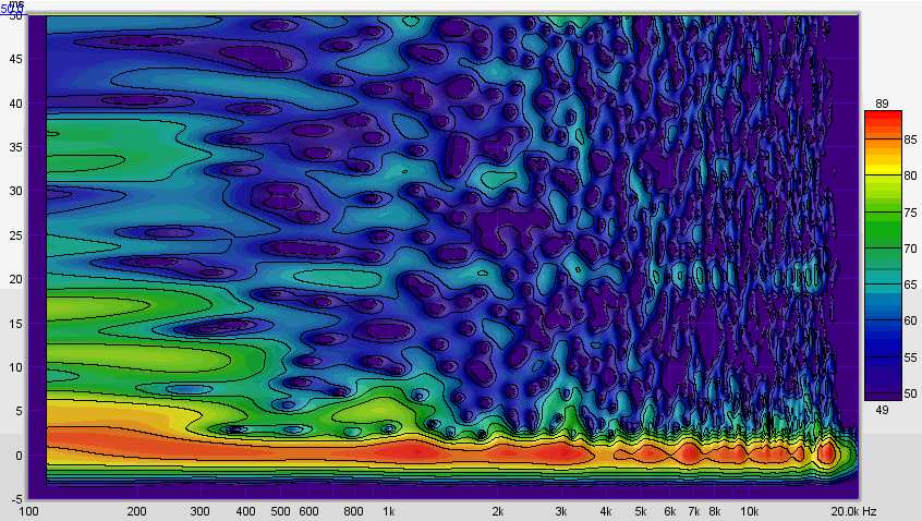

It is not applicable, as you would have seen yourself if you had inspected the pulse's decay.
For a single reflection to alter the unsmoothed phase significantly it must be 10dB or less down from the main pulse. Again you could have tested that yourself by analysing a dirac and a copy of it, say, 10ms later and -10dB down, before making broad generalizations.
As for myself, I've compared anechoic pulses of speakers on infinite baffle extensions with in-room measurements (maximised distances to walls, of course) and when it comes to extracting phase -- for reverse phase correction that I often apply to get minphase or even linphase behaviour -- there is no significant difference, notably after proper (frequency dependant) windowing, that's why it is used.
Your statement is true, though, for very strong modal effects at very low frequencies.

I just checked, and indeed even indoor measurements can provide usable phase information, provided the window is set properly short.
Comparing measurements I know are more reliable to some taken in reflective surroundings I see the phase responses match.
When the reflected sound becomes large enough compared to the direct sound, the phase will shift all over the place because the measured sound will be delayed, due to summation of the direct and the reflected, where the reflected will be delayed.
The problem is, as I see it, that it may be difficult to make sure that the phase response derived from the measurement really is that of the speaker itself, not affected by reflections.
