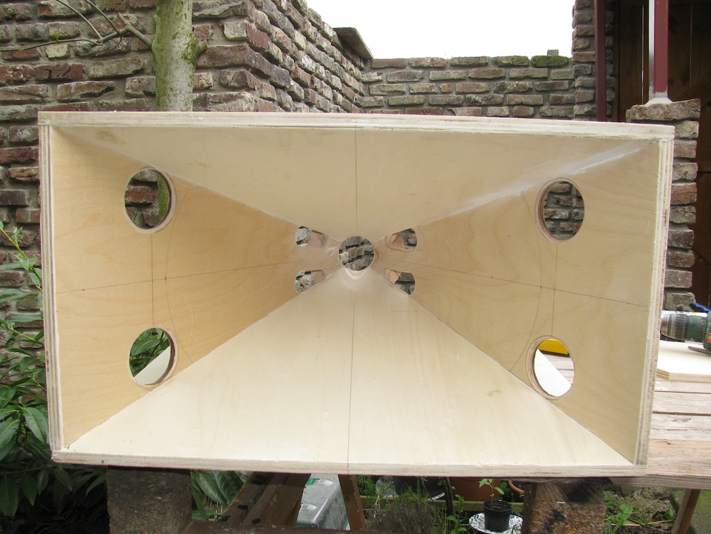

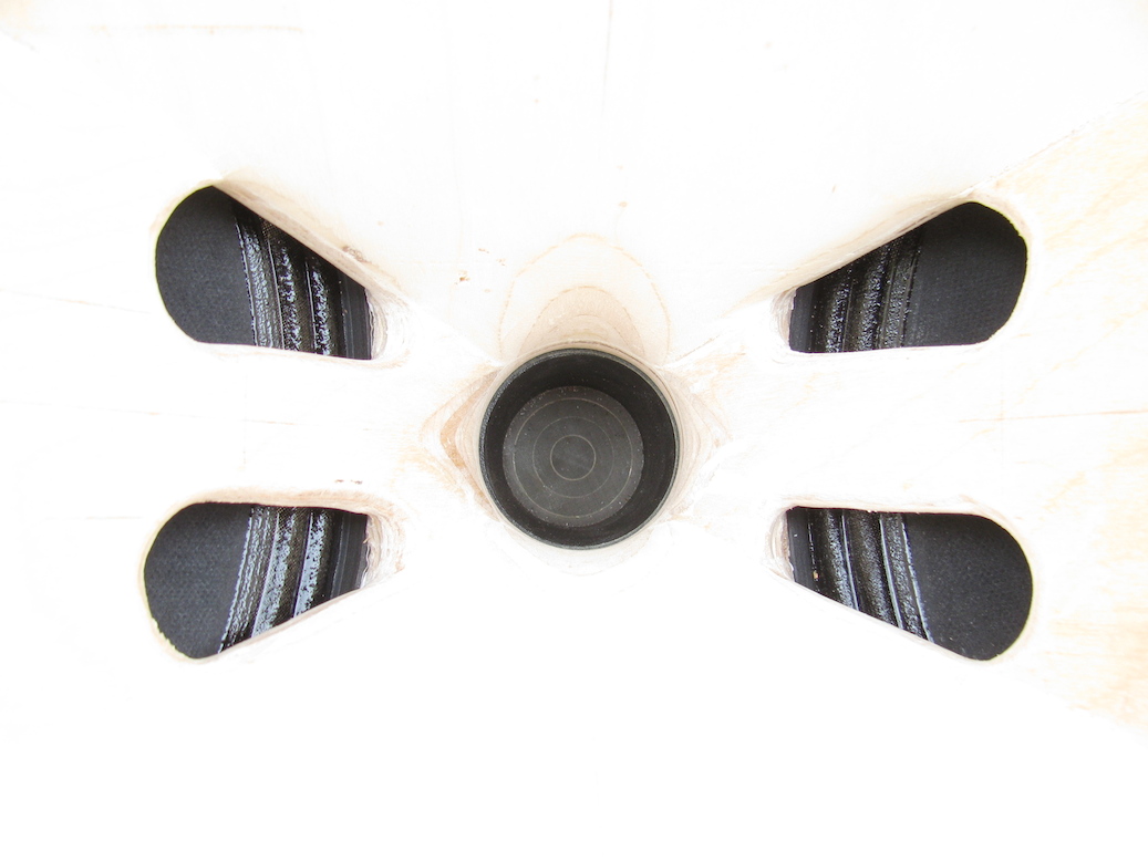

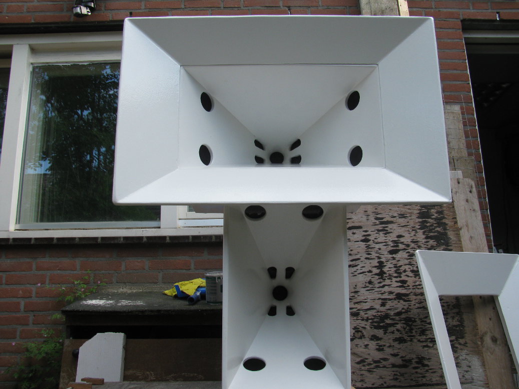

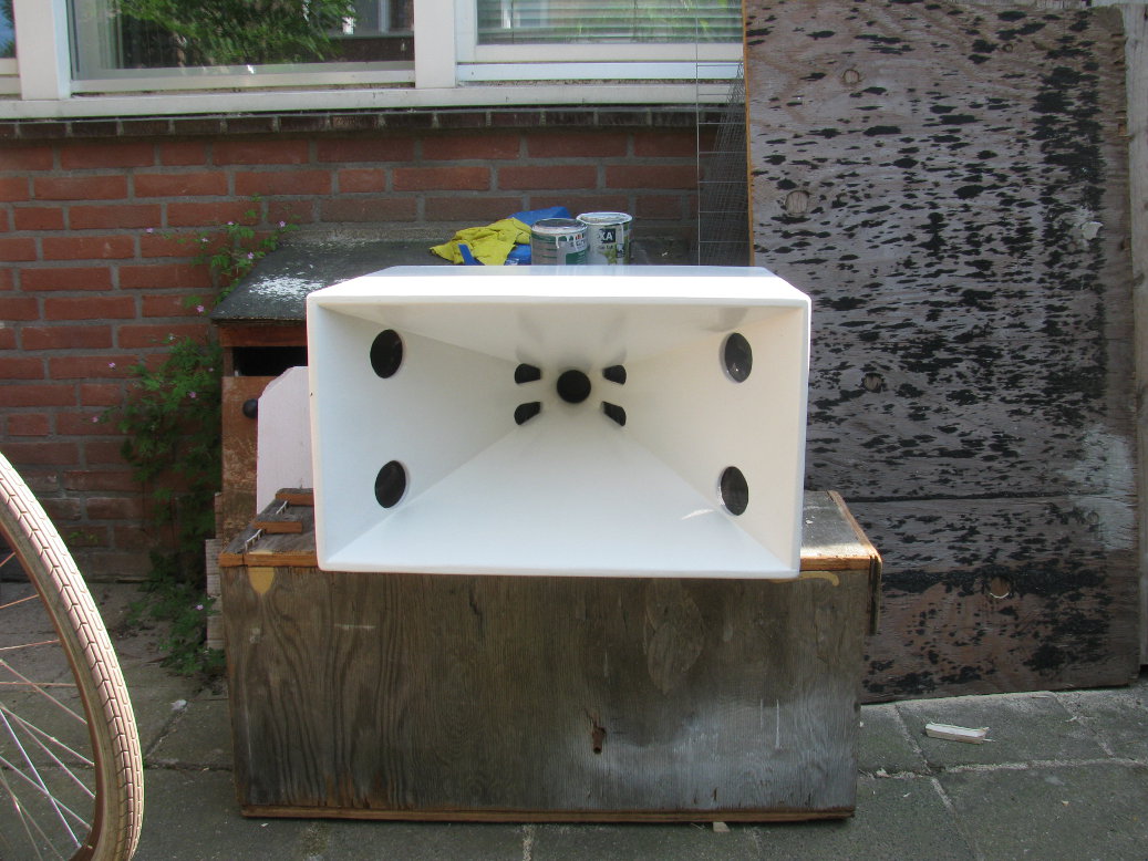

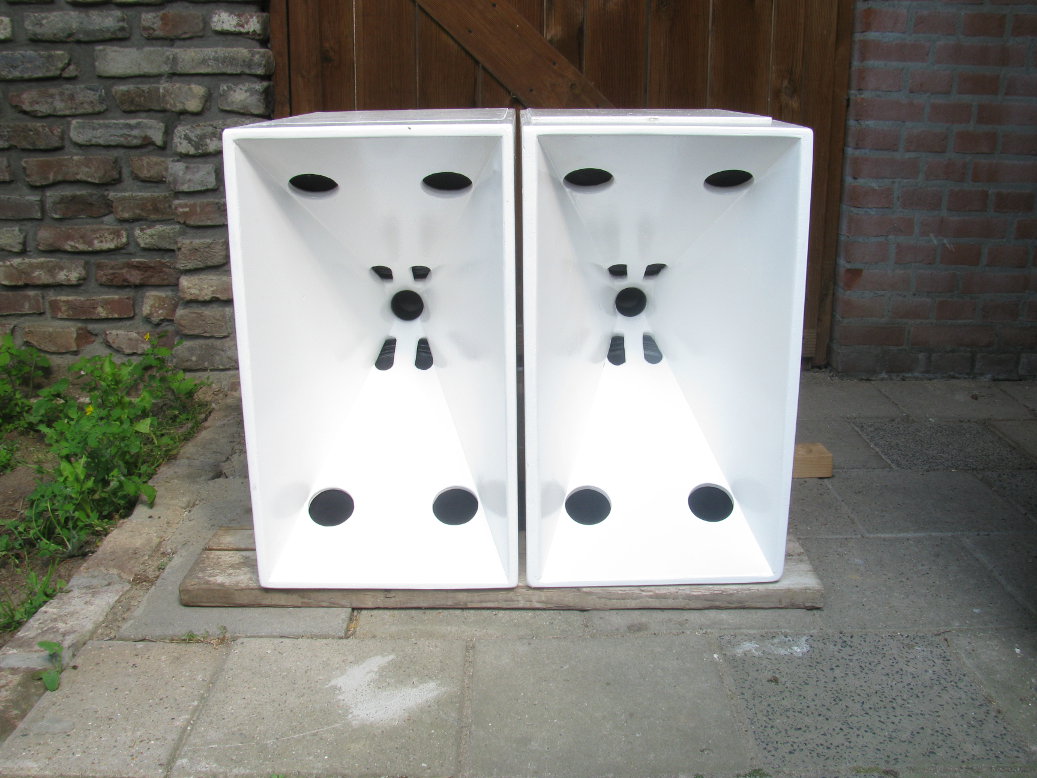

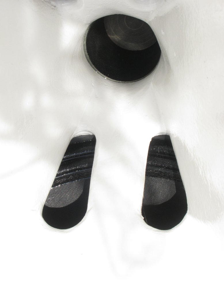

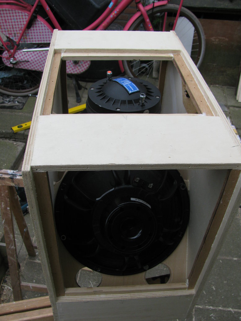

I have been working on a second prototype. It has smaller horn entry ports, so the center is a little closer to the throat and the bass reflex ports are located differently because I suspected the internal structure of the 1st proto type to form a longer bass reflex tunnel than intended. Here are some photos:
Yesterday I got a chance to take everything outside and take some measurements without the room influence, although I live in a city and it is not exactly quiet with traffic background noise... But still better than inside the room.
Measurement setup: speaker on household stairs, about 1.8 m from the ground and pointed upwards; measurements mic at 1.6 m above the mouth exit (more extension and my mic stand would fall over).

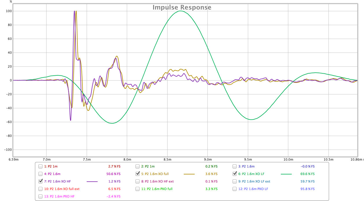

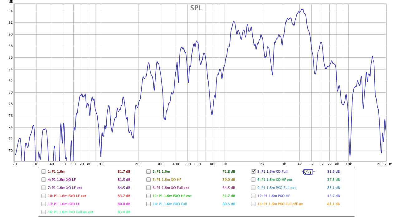

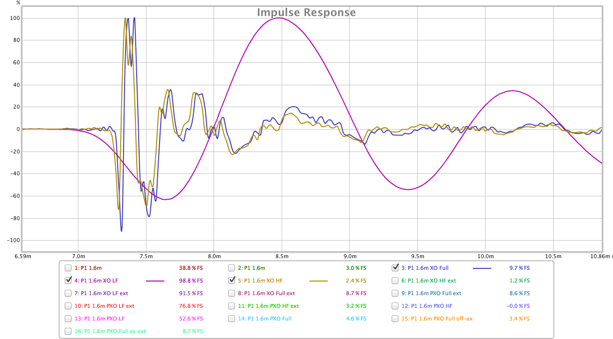

First, we're interested in the individual driver impulse response with the cross over filter enabled:
*no delays or EQs applied, just the crossover (But24 @ 840 Hz LP for the woofers, But48 @878 Hz HP for the HF driver)

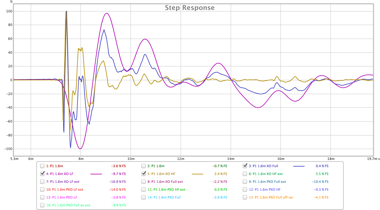

Proto 1:
Legend: P1 = prototype #1; 1.6m = measured @ 1.6 m; XO = active crossover enabled; full = full system; LF = only the woofers playing; HF = only the HF driver playing; ext = with horn extender added; PXO = passive crossover.
Looks like the HF driver is just a little bit behind the woofers and could use a delay of about 250 microseconds, right?
The step response for the same measurement says timing is alright, right? 😕
But there is a big dip at the crossover frequency...

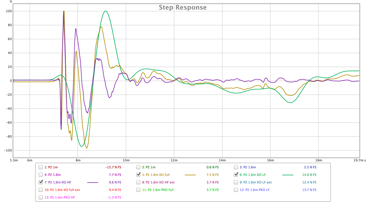

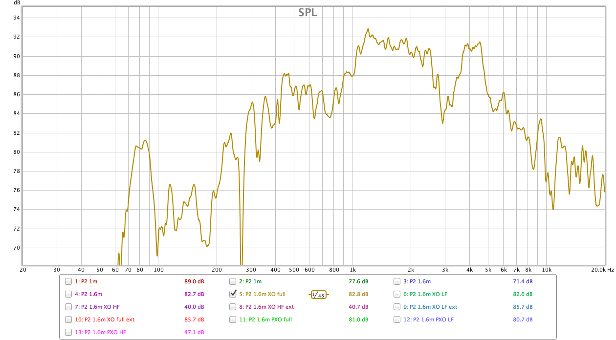

Proto 2:
...not sure what to make of it 😱...
Timing still looks ok, right?
Yay, no dip in the crossover region 🙂

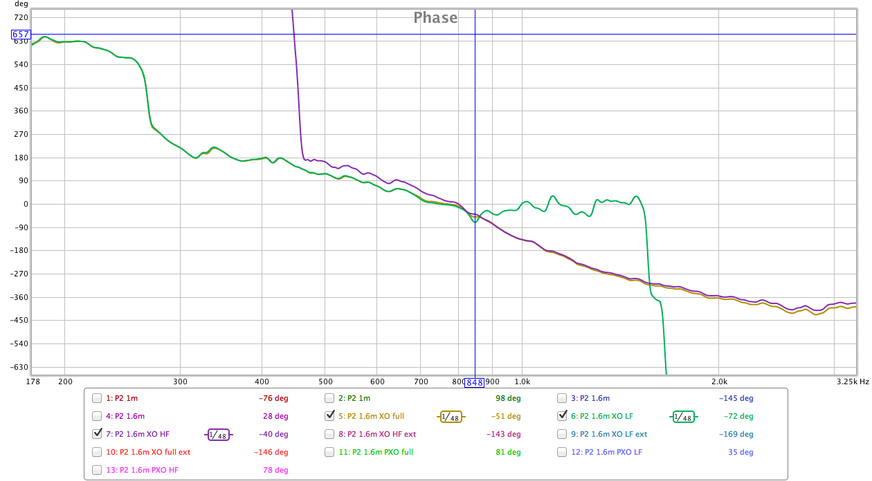

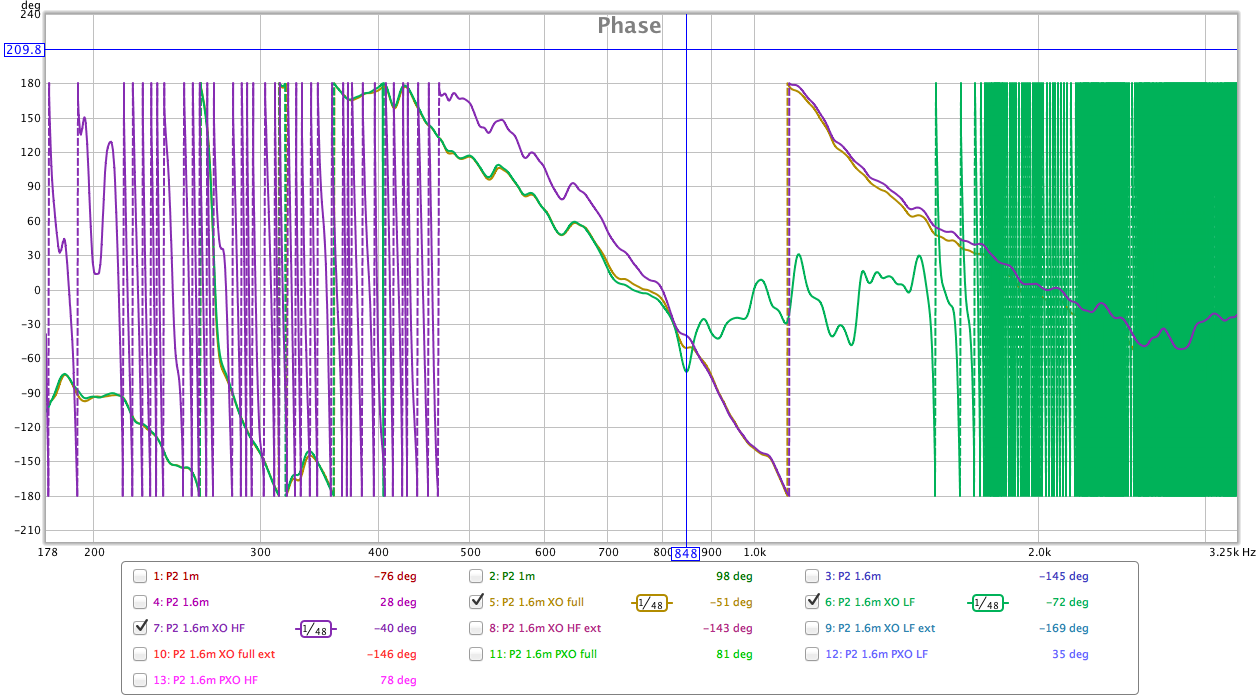

Let's have a look at the phase (after I removed the delay in REW, all IRs moved by 7.292 ms).

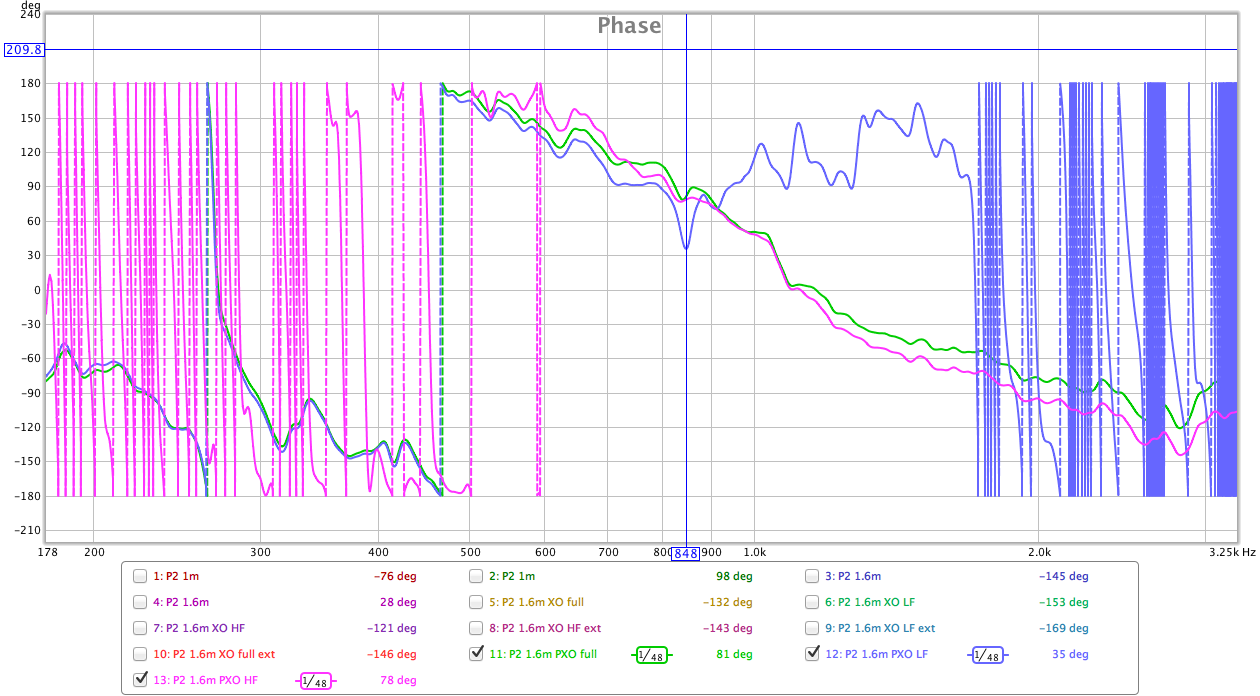

Here is the phase response of the second prototype (which I think is better than the first proto):
And unwrapped:
Looks to me that's all good 😎. Or isn't it? Am I correct when I think this looks like a passive crossover is still a good option?

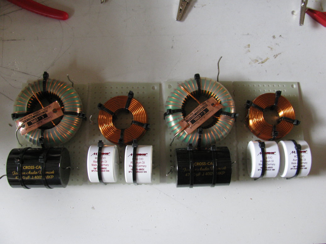

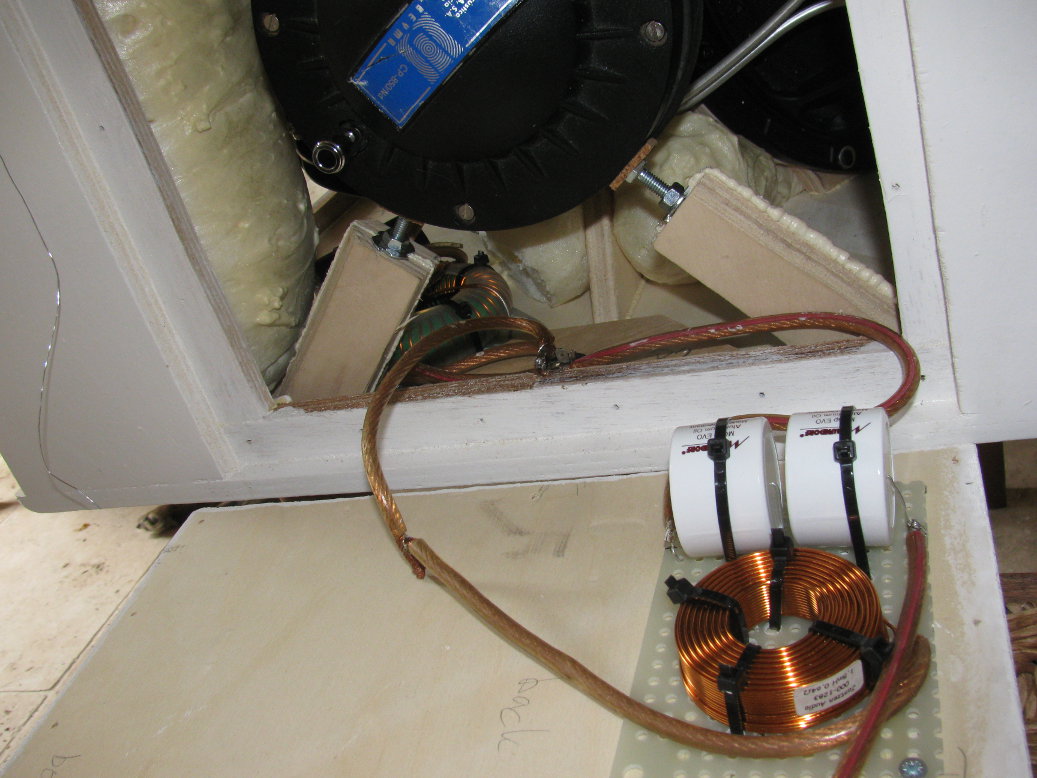

Since I still had my passive crossover laying around, I also took some measurements with it:
(On Proto #2)
Looking at the crossover region, that's not too shabby, isn't it? Am I correct when I think this looks like a passive crossover is still a good option?

I think the crux of the issue is understanding the woofer IR. What is the true IR peak, whose start you want to align the CD with? That is a curious stretched out IR with a tall central peak flanked by negative peaks and some pre-ringing.
You have been aligning on that that first negative peak which suggests a polarity inversion. That first negative peak might also be pre-ringing. Consider that the bigger positive peak further out might be the true peak. Do a trial alignment on where it starts up and see what you get.

The phase in the later graphs does look to track pretty well particularly above the crossover point. I'm not sure which ones are which as I need to view them on a bigger screen.

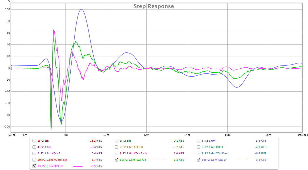

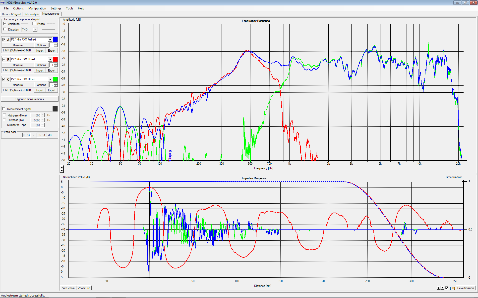

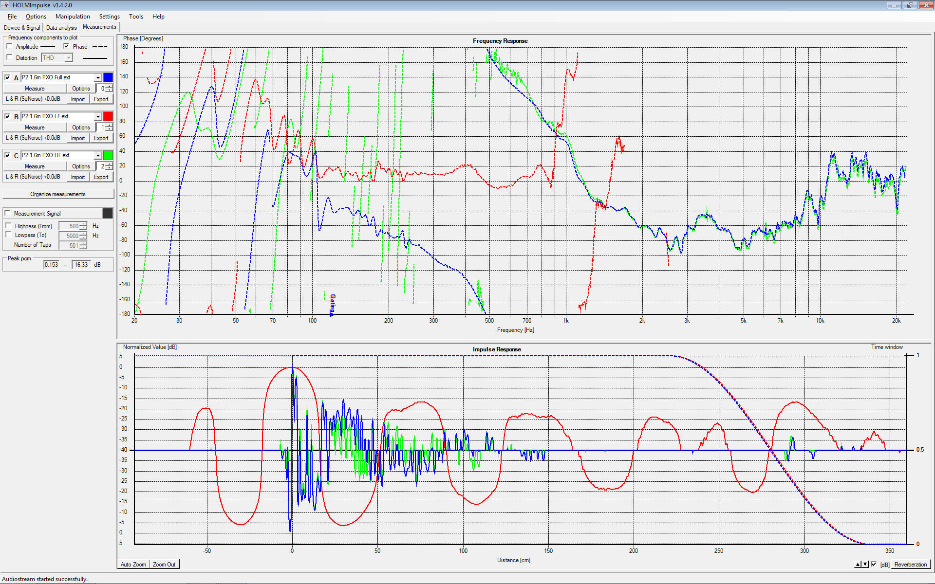

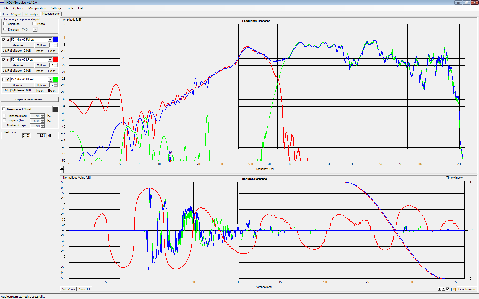

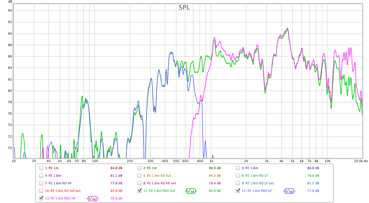

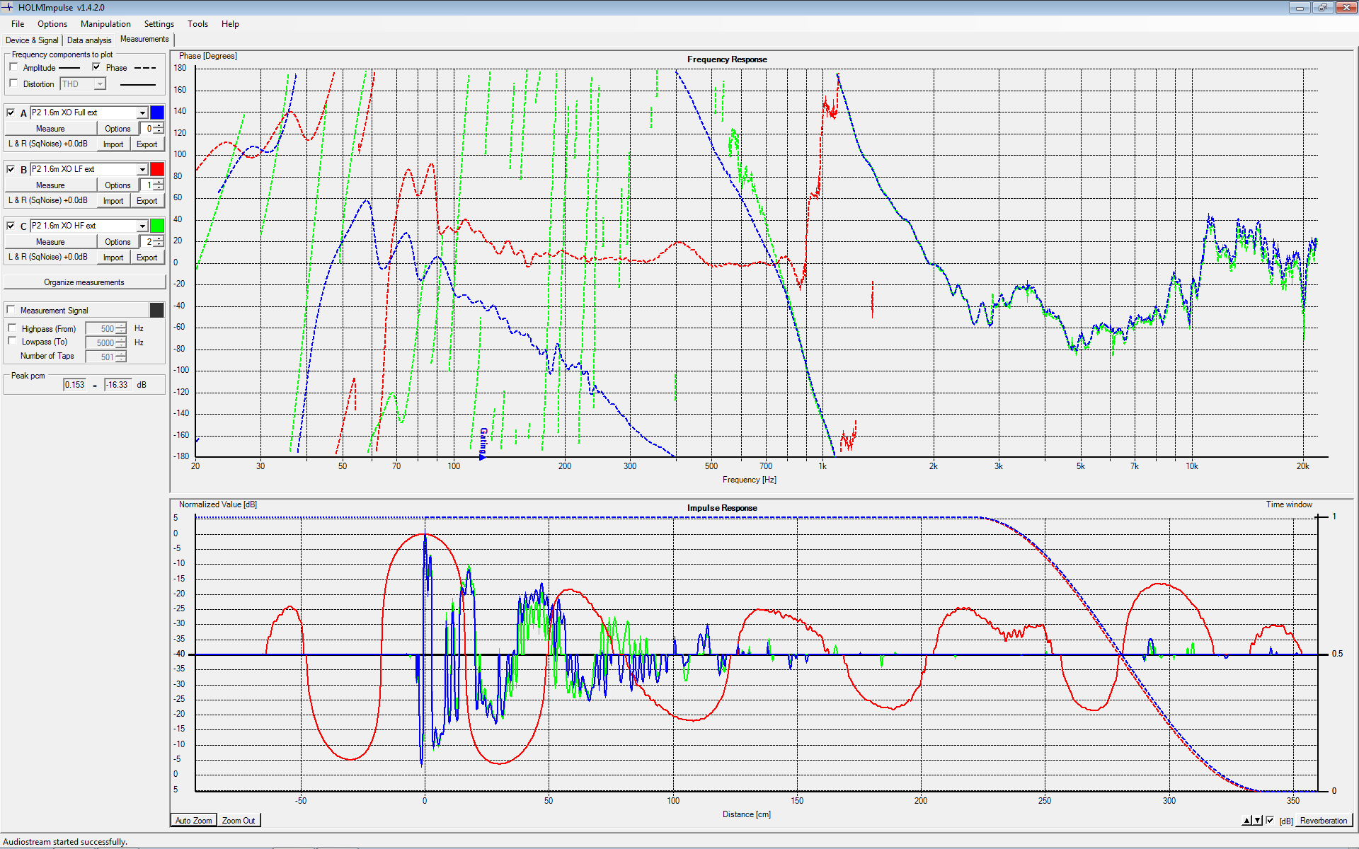

During the same measurement session I also measured with HOLM's Square Noise (improved MLS) measurement signal (on a different system). Here are some results.
Proto #2 with active crossover and horn extender:
I set the window at about 2.75 m, as there seems to be a reflexion at 2.90 m. There is a slight dip in SPL at the crossover range, but the phase seems quite smooth, although I think it looks like Holm has trouble deciding the correct IR peak as well, which results in a LF phase response that might be incorrect.
The passive crossover looks even better:
The SPL show less dip in the crossover region due to a little bit of attenuation of the 1-2k region. Phase response is quite smooth and has 360 degrees less turning in the 400-1k Hz region.

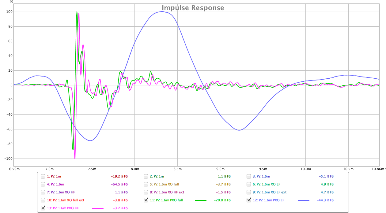

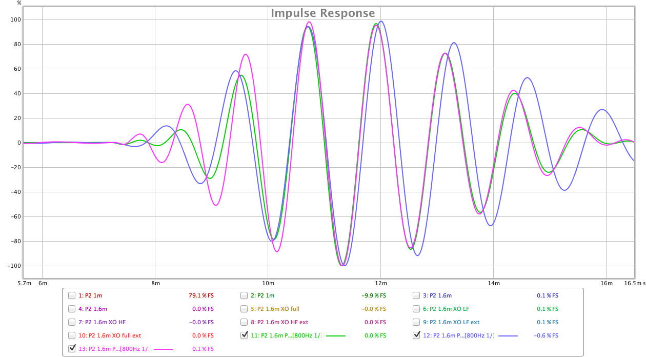

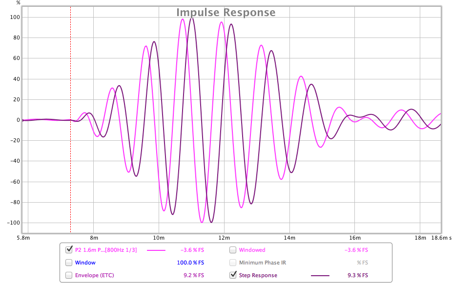

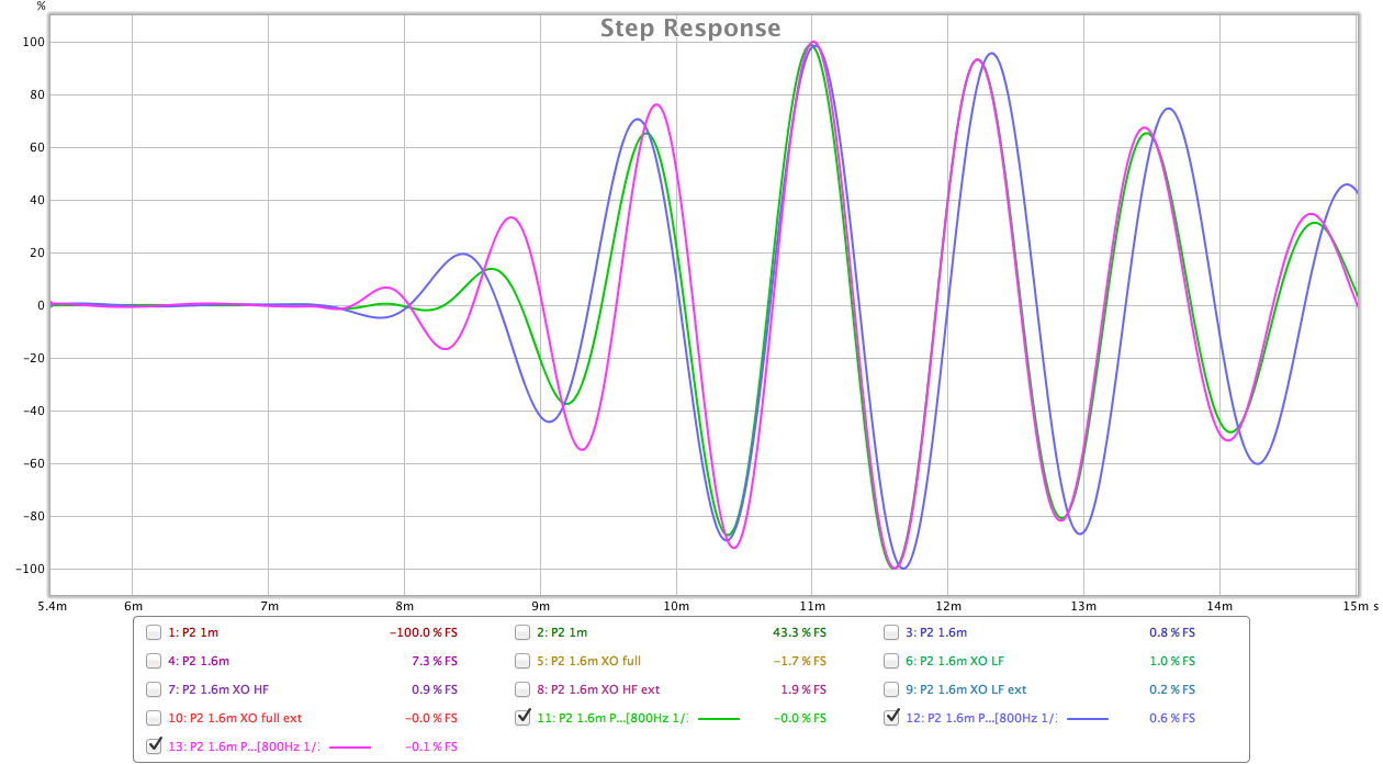

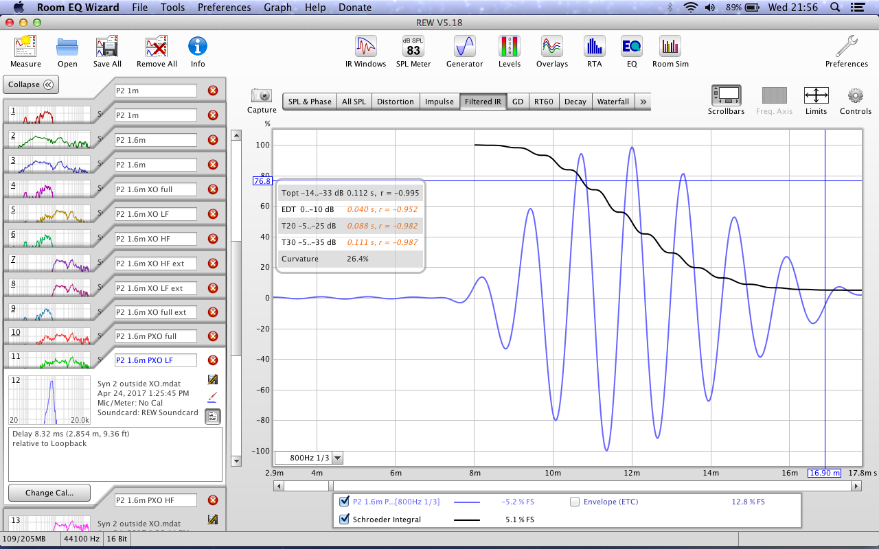

I'm not sure whether I get what you mean 😱. I went to the Filtered IR tab and selected 800Hz 1/3 for all three PXO measurements (LF, HF and full). Is that what you mean?Another thing that you can do is to filter the IR with a 1/3 Octave filter at or around the crossover point. That can make it easier to see if the traces line up there.
This results in the following IRs:
And step response:
Yes that is what I meant 🙂
You can use frequencies around the crossover to see what is happening. The closer the wave shapes fit on top of each other the better the tracking is at the crossover. Choosing a higher or lower filter frequency will show how well it tracks further out from the crossover point.
You could use a small delay to see if you can line them up even closer. Concentrate on the middle of the graph to get the best match, then see if your other measurements are better.

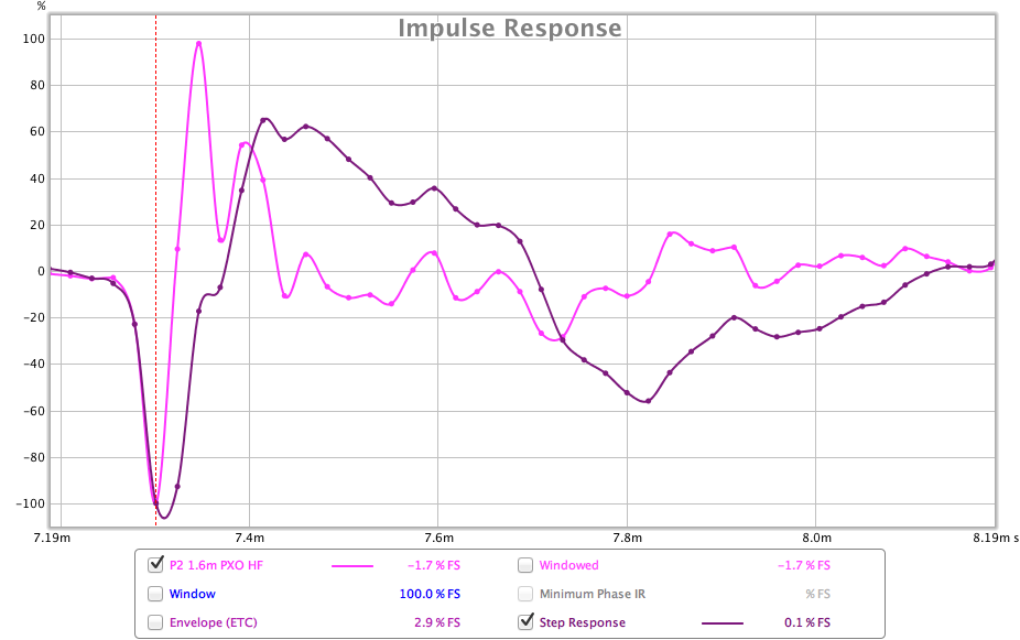

Can you make an impulse and step graph with just the compression driver and nothing else?

Looking at the last two graphs I would say they're already quite close in the middle. Or am I seeing it wrong?You could use a small delay to see if you can line them up even closer. Concentrate on the middle of the graph to get the best match, then see if your other measurements are better.

Sure! Here is filtered with 800Hz 1/3:
And here is unfiltered:
No problem just passing on something I saw wesayso suggest as it seemed relevant to this.That is good to know! Thanks! 😎
Yes they look close which makes sense as your phase looked close. I meant more if you wanted to use an all pass or delay to get the time alignment spot on.Looking at the last two graphs I would say they're already quite close in the middle. Or am I seeing it wrong?
Hmm that is a weird response. I really cannot tell if there is a polarity inversion or something else. What is the time between the negative and positive peaks ? Work that out as a distance and see if there is anything in the horn throat that corresponds to that distance.
You could also try and plug the ports of the woofer and tape over to see if they are affecting the response.
The time between the sharp positive and negative peaks in the IR is 46 microseconds. That would translate to ~1.6 cm. 😕 The only thing in the horn that is around that size is the width of the entry ports for the woofers at a certain distance, as they very in width, as you have probably seen in the photos. The shortest distance between the ports is about 3 cm (the sides of the horn wall).Hmm that is a weird response. I really cannot tell if there is a polarity inversion or something else. What is the time between the negative and positive peaks ? Work that out as a distance and see if there is anything in the horn throat that corresponds to that distance.
I will look into the apparent phase inversion and maybe try to plug the ports and see if that is where this comes from, although there would be no real solution then...
The time between the sharp positive and negative peaks in the IR is 46 microseconds. That would translate to ~1.6 cm. 😕 The only thing in the horn that is around that size is the width of the entry ports for the woofers at a certain distance, as they vary in width, as you have probably seen in the photos. The shortest distance between the ports is about 3 cm (the sides of the horn wall).Hmm that is a weird response. I really cannot tell if there is a polarity inversion or something else. What is the time between the negative and positive peaks ? Work that out as a distance and see if there is anything in the horn throat that corresponds to that distance.

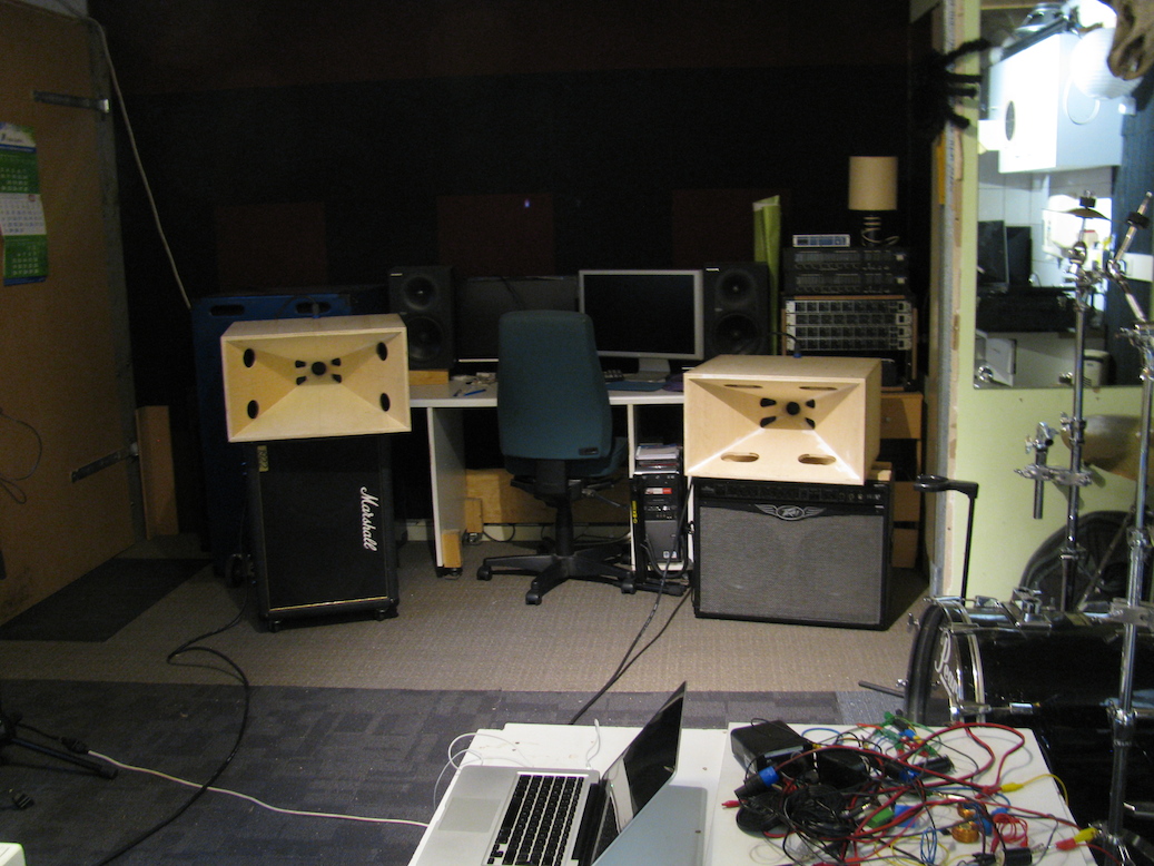

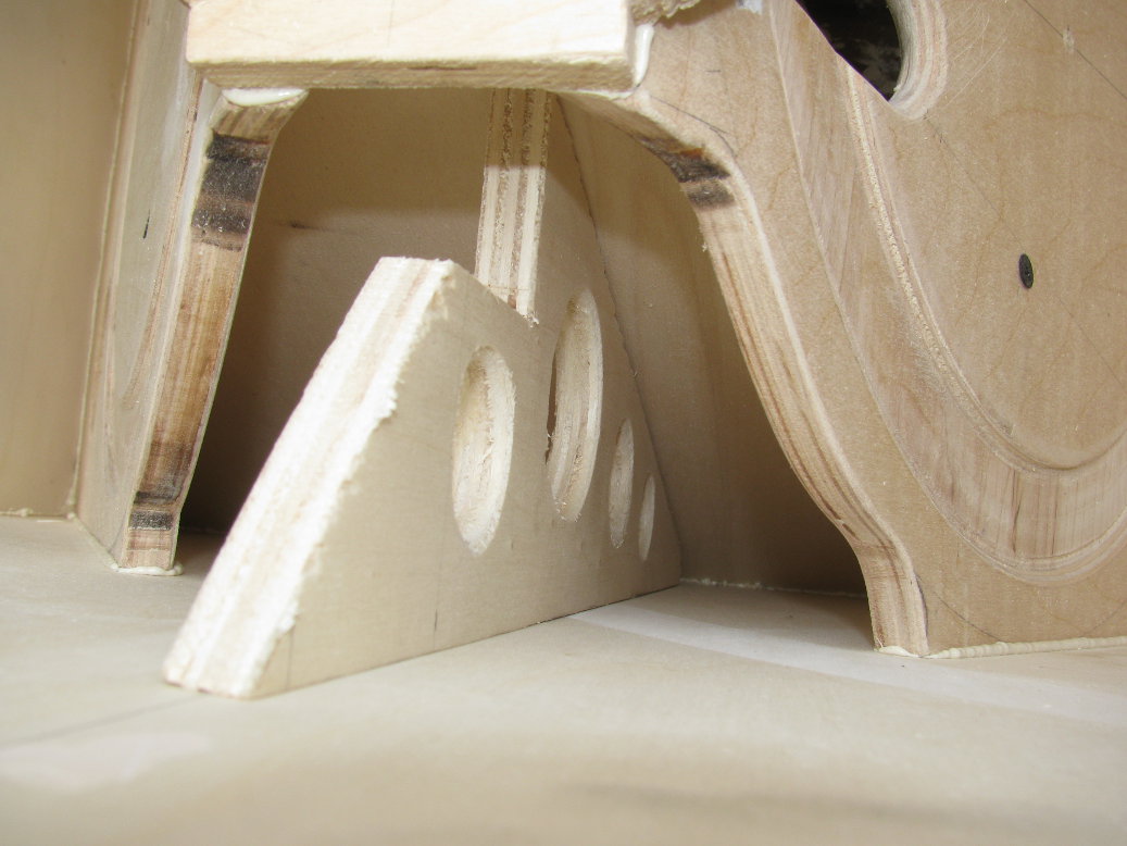

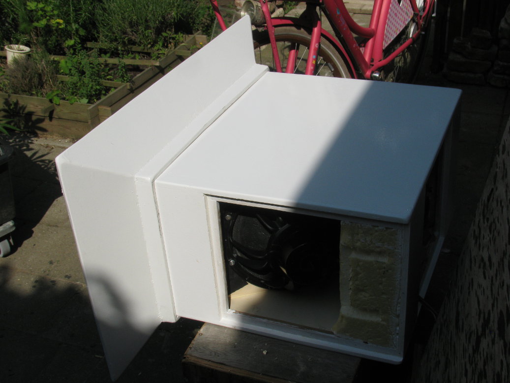

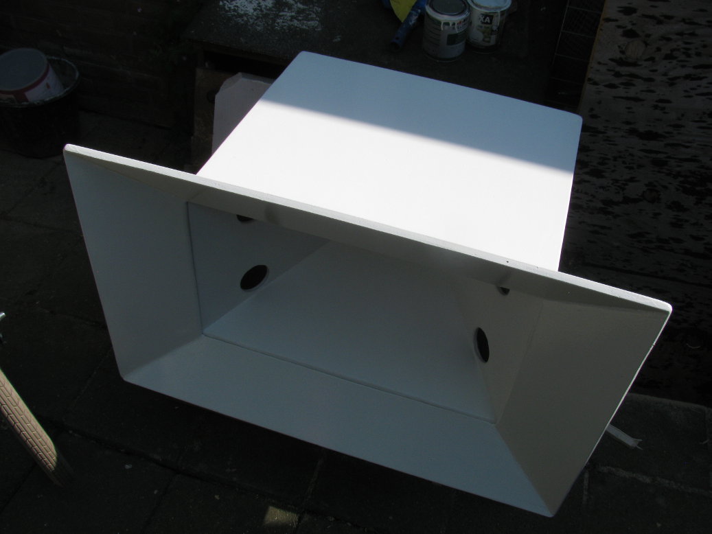

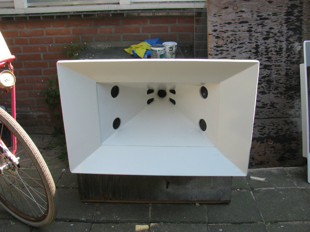

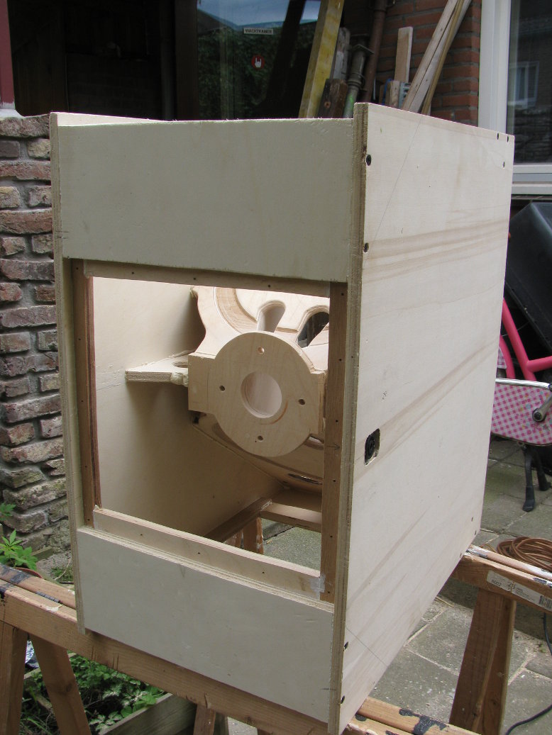

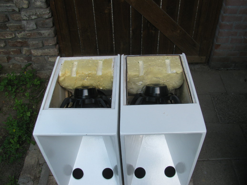

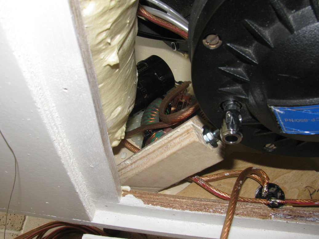

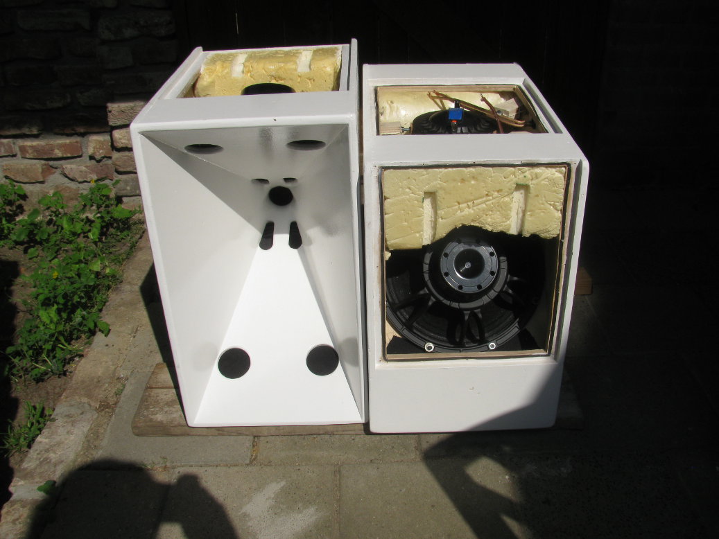

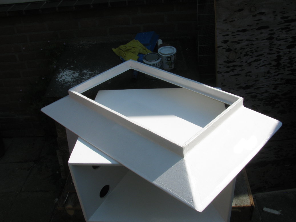

It's been a while since I updated this thread. I had a few things important to take care of. But here's where I am now...

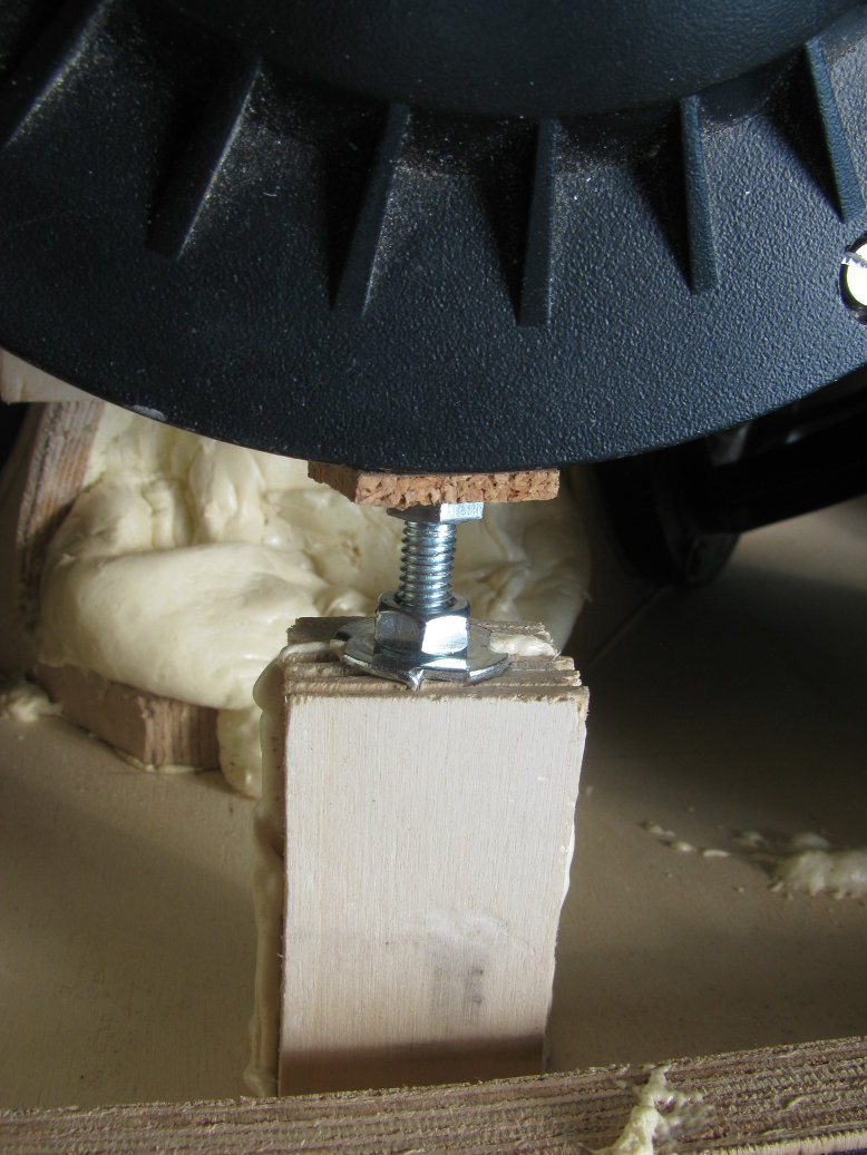

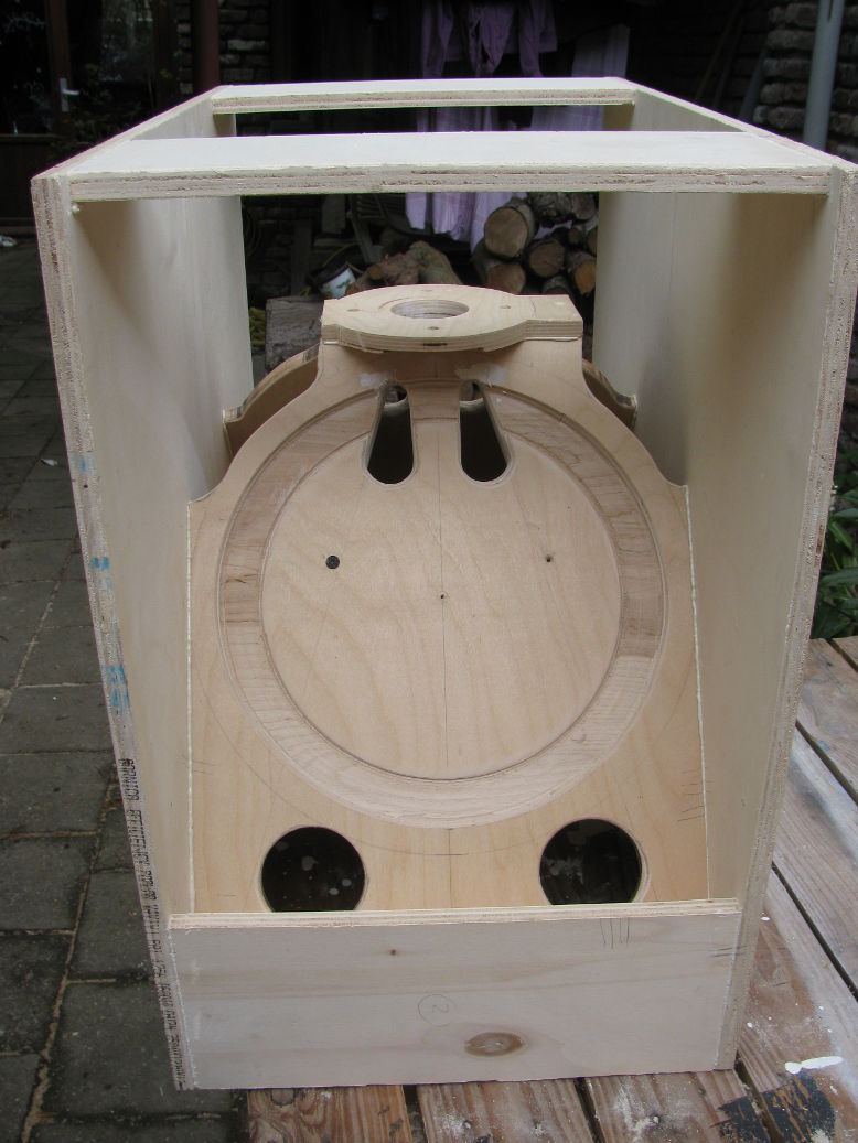

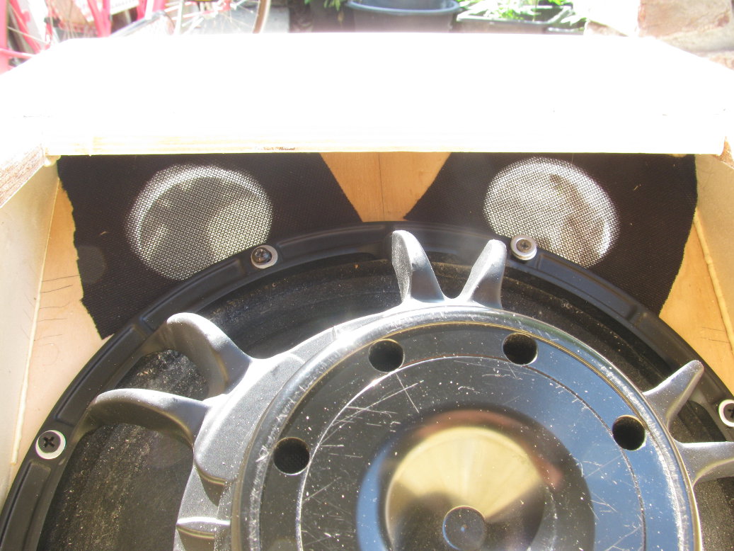

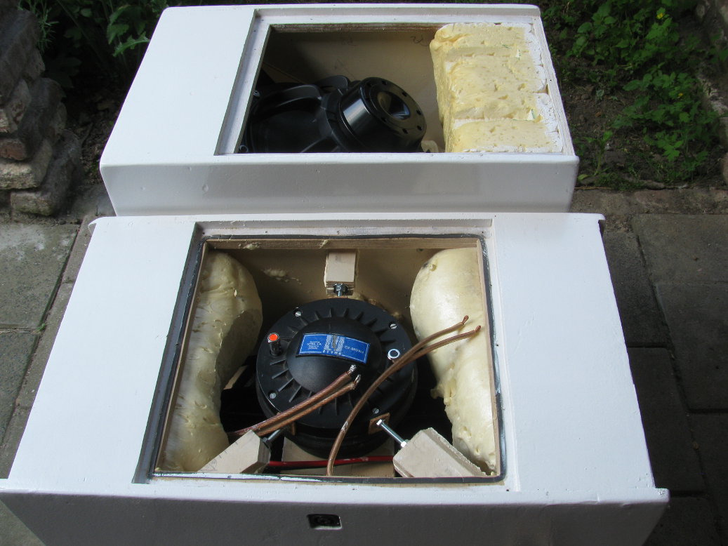

After realising I couldn't buy a separate amp of decent quality for the CD and go active for the price of the crossover components, I chose to stay on the passive path. I decided on 3rd order for the CD and 2nd order for the woofer section. After trying different values I settled for 10uF - 1.5mH - 10uF for the CD and 0.82mH - 47uF for the woofer section. This configuration resulted in 'fairly' flat phase and frequency responses through the crossover range without any amp killing impedance dips. EQ was going to be needed, but that is nothing new in the PA world.
I still needed to shift the bass reflex port tuning up from 80-ish to 100-ish, so I filled some corners and cavities of the cabinet with PU construction foam. To make the enclosure any smaller is not really an option, as it would be near impossible to get the drivers in or out of the cabinet. Maybe it is possible, but I didn't feel like starting all over again
Photos will follow 😉.

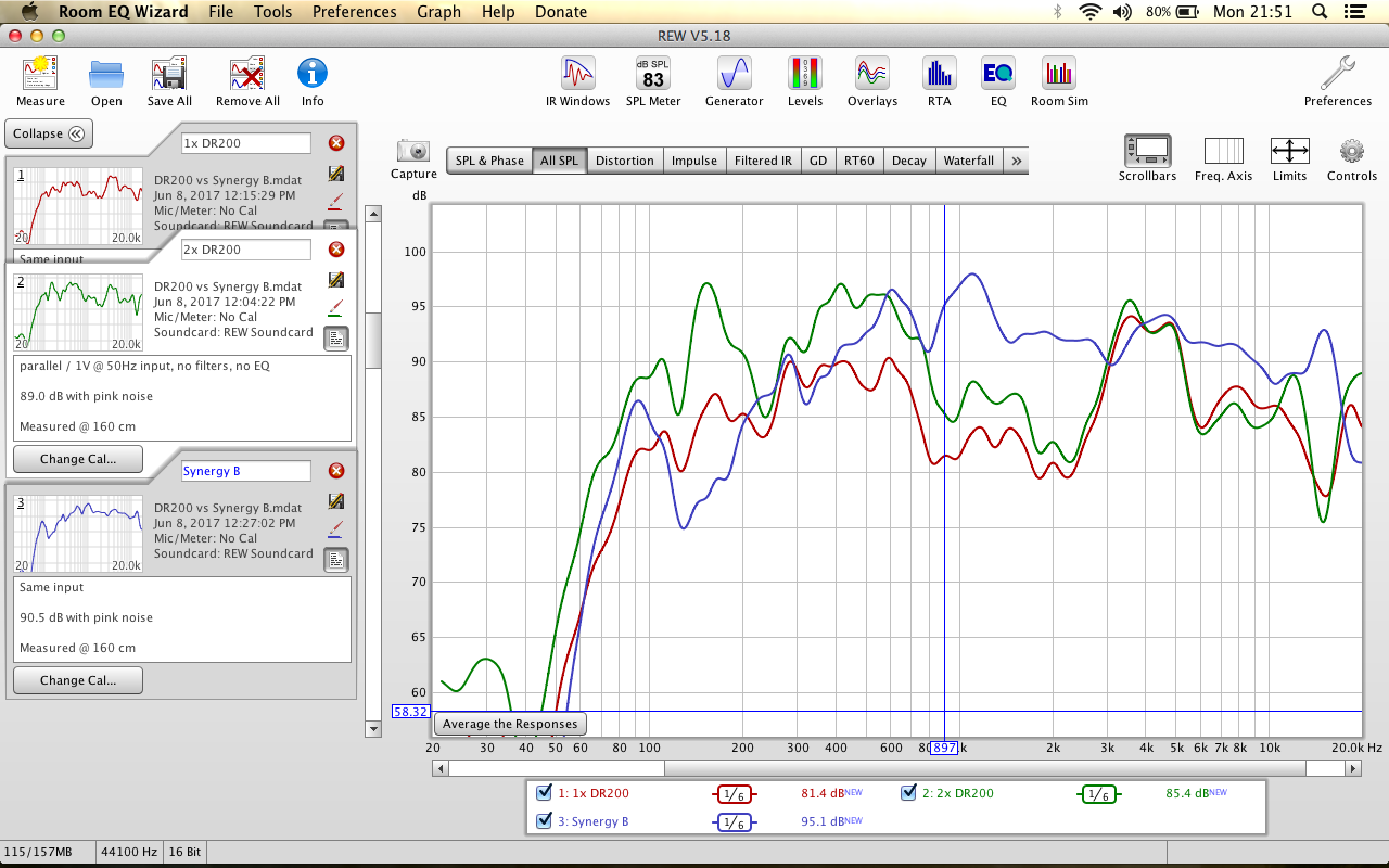

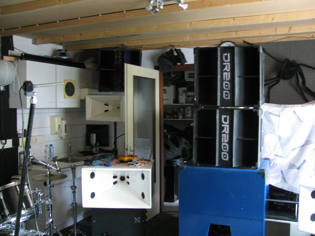

I did some comparison measurements between my DR200 tops (Bill Fitzmaurice design) and my 'Synergy B'. Measurement was with 1V @ 50Hz input, no filters, no EQ, measured @ 160 cm. Settings were unchanged. I just plugged from one box to the other (2x DR200 is 2 of them in parallel) and repositioned the mic (yes, there are some room influences visible, dip at 120 Hz...).
My aim was to replace 4 DR200 tops by 2 Synergy horns. More compact, better coherence and quality. I'm not really done yet, but it's going to be close (SPL wise) 😎. The DR200s are loaded with an 8 ohm Eminence Beta 8a and will take up to 225W RMS (450W program) each (so 450W RMS @ 4 ohm for two of them), while the Synergy B uses two 8 ohm B&C 12NDL76s good for 800W RMS @ 4 ohm and 1600W program @ 4 ohm. Above 800 Hz the Synergy B has the two DR200s beat, but below that you can see the unloading of the woofers having a big negative impact on SPL...
I hope to be able to do a big measurement/tuning session outside in the open somewhere end of July with most of the PA stuff I have built so far. Then I will be able to make a final conclusion.

I think you can 'fill' in that hole at 150Hz by tuning the woofers higher.
The woofer alignment on the real SH50s is kind of bizarre, it's tuned much higher than you would use for a 'conventional' QB3 alignment.

I almost forgot: in the above graph the Synergy B was measured WITHOUT the horn extender, so when added you can add around 3 dB down from (roughly) 1000 Hz 🙂.

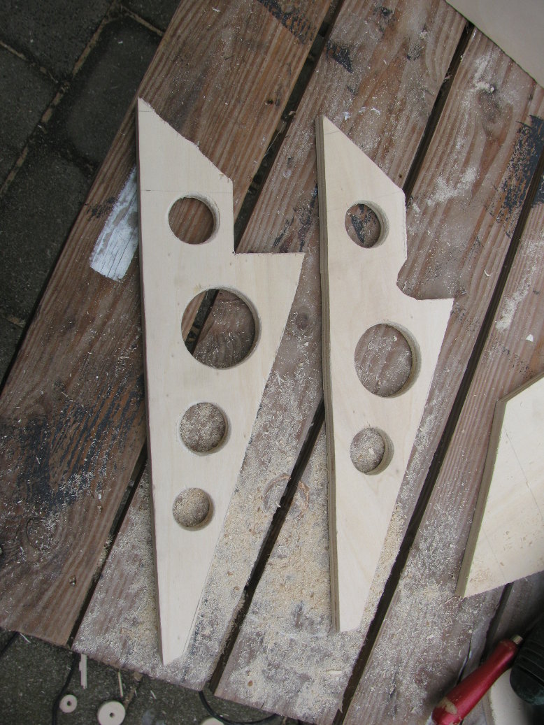

As promised, some photos 🙂
