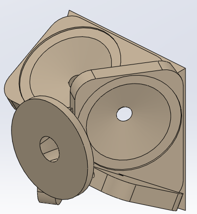

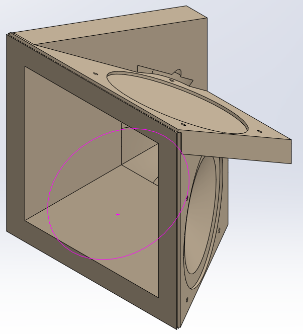

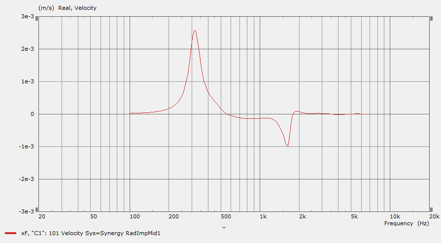

I have played with the idea of a Synergy horn for a while, and while it´s going to be a while until it´s completed, I thought I could share the process with you guys, and perhaps get some help along the way. Part of my motivation is to increase the interest of ABEC3. No commercial association what so ever (I have a Student licence for non-commercial use), but it´s such a powerful software that I´d really like to see it spread - so I can get advice on how to use it from other members. 🙂 If there is interest, I can post the scripts used - just let me know. I should also mention that there I have "stolen" from various Akabak scripts made by others, read up on DIYaudio forums etc, so if somebody feels like it looks too much like something they did, let me know and I´ll be sure to mention you here (if you want 🙂).
In another thread (see http://www.diyaudio.com/forums/multi-way/88237-suitable-midrange-cone-bandpass-mid-unity-horn-187.html#post4152484, and http://www.diyaudio.com/forums/multi-way/88237-suitable-midrange-cone-bandpass-mid-unity-horn-188.html#post4158855 i put some preliminary results of the simulations. I probably shouldn´t contaminate that thread anymore.. 🙂

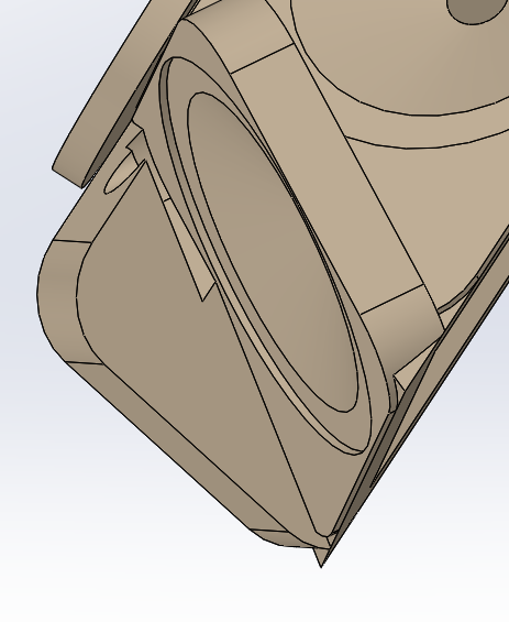

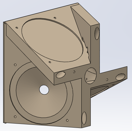

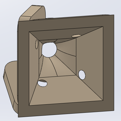

Another thing I´d like to try with this build, is to make a CD+Mid horn stub using a 3D printer. Now I haven´t checkout how expensive it will be to print something like this, so it´s a hypothesis still. The compression driver I imagine using is a DE250, while the mids are the Visaton M10s. I intend to put "pilot holes" into the print itself, and tap M3 or M4 holes into the printed ABS (or whatever material is best suited) to mount the drivers.
It seems that to get the smoothest response for the mids, a frustum without a cylindrical compression chamber first is the best choice. Now, in the sims I did not include the volume under the cone, as I don´t have the drivers yet and haven´t figured out how big that is. If anybody wants to measure the volume under the cone for the M10 mids, I´ll include that in the sim. Otherwise, I´ll order the drivers and adjust the model as required.
I think this configuration allows for maximum extension of the midranges, as it will have minimum cancellation compared to having the driver offset compared to the entry hole. The mid taps are 55mm from the CD entry, which seems to give (with an arbitrary 1" compression compression driver simulated) a first null at slightly below 2kHz. The frustum diameter is 9cm, the depth is 1.7cm and the entry holes are 1.5cm diameter.
The 3D-printable part now looks like this (if it _can_ be printed - I don´t know, perhaps someone will chip in). It still need some refinement - adding pilot holes for tapping, checking for thickness, adding something to allow it to "strap on" to a wooden horn section etc. But I think it will be something like this.

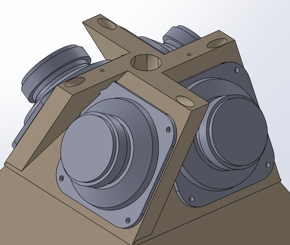

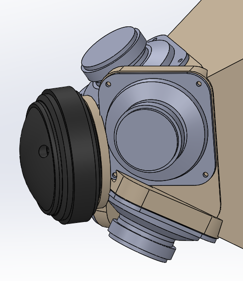

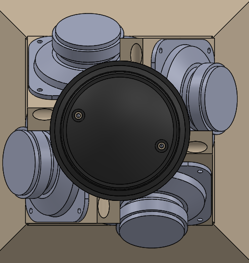

Including the drivers:

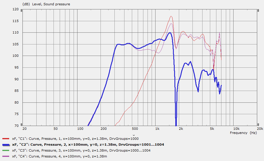

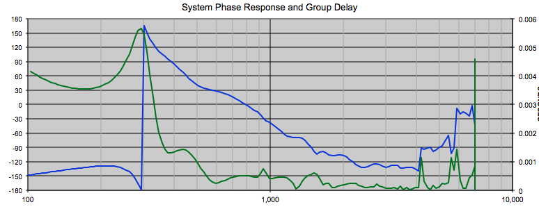

The simulated response (no crossovers, as this is cumbersome) with the big frustum instead of a cylindrical chamber first, and before adjusting for the "under the cone" volume:
I think the simulated response looks pretty good, but it´s obvious that the driver has to be highpassed around 3-400Hz, and will cover a rather narrow range.

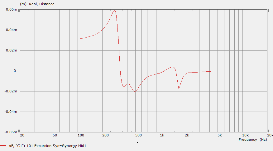

The next step will be to add woofers. I have room for 10 inchers (or will make room), but was hoping to get by with two woofers per side and still reach 100hz. I would really like to make this a sealed build, to keep things simpler. Any suggestion for a suitable driver?

2014-12-29 20_58_24-VacsViewer - (new) - [Velocity mid ports].png30.5 KB · Views: 3,111

Why would you need this to be made of metal? ABS plastic is perfectly fine for this app.They now do a lost wax, where you can 3D print it and take it to a foundry to have cast, which would work out way cheaper than printing in steel.
The question you need to ask yourself is how many iterations you will need to print before you are satisfied with the results. For example, I'm on the 3rd iteration of mid holes and bandpass chamber for mine and I need some form of phase plug as well because I'm doing a 2-way with 8" drivers. I'm sure you will do better but I did do a lot of simulation.
So yes, print that round to rectangular transition section but do as much of the rest of it in wood as you can so you can tweak it without breaking the bank!
I see in your simulation that you have a wide, extended BW for your mids. That was my initial goal as well. That is actually the easy part (unless you are using a big driver but getting high BW sim was easy with my 8" drivers because the reason I didn't realize that high BW wasn't modeled). The hard part and I think a difference maker is fine tuning the acoustic low pass filtering of the throat chamber and ports so that you have just enough BW and no more. If you can get that right with ABEC simulation and not need multiple tweaks, then my hat is off to you and I will be tempted to learn the tool.
Good luck with this project. I look forward to following your progress.

Great work here - have you found the ABEC3 results similar to Akabak? I haven't quite been able to find time to immerse myself into the ABEC3 learning curve.

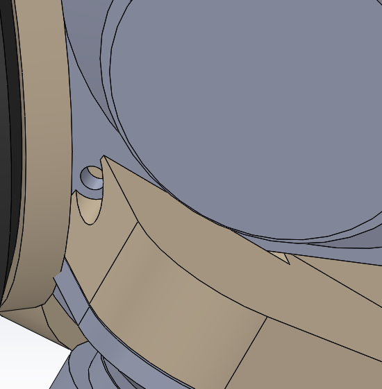

Your 3d model above looks tight - there are visible interferences on the driver mounting flange etc. you may want to move things out tad. I am in same camp with NC535 above in the use of larger mid-bass drivers to get the range from 100Hz to 1kHz with a single driver and use a two way. For example,
using a good mid like B&C 6MDN44 covers the 200Hz to 1kHz range nicely. An 8in works too as well as a 15in! I think Legis did this on his Synergy and has 80Hz to 1kHz with 15in Deltalite.
@ nc535: Yes, i understand there is a risk of an interation or three. But the advantage is, that once there is a "fit" for the particular drivers, it can be reused, also by others if they want. With my wood working skill level, it´s unlikely I can get the precision needed. Also, I figure the shorter wavelengths for the mid and CD are more sensitive to uneven surfaces, leaks etc than the woofer. So the precision for the rest of the horn can be lower without any negative effects.
@xrk971
Yes, it´s tight! I had to cut away a part to be able to "slide" the driver under the mounting plate for the next driver, and also cut out an area to be able to reach the mounting screw -- see pictures.
Did you notice any other discrepancies? I do need, as mentioned, to check for material thickness around the frustum, as I suspect it´s a bit thin, but worst case I´ll make the frustum throat a bit smaller. I do need to verify if Akabak gives the same results, but haven´t gotten around to it yet...
I think a good start to learn ABEC is to just do a LEM simulation. Copy one of your akabak sims over, and learn how the different files configure different things. (One for the LEM script, one for the BEM part/solving config, one for the measurement spectra, one for the 2D fields etc). I actually tried to import the DE250 script I found online, and it was 99% compatible - there is just one keyword that is deprecated in ABEC, and I haven´t been able to dig into it to see how it should be replaced with an ABEC equivalent.
Just before posting this, I did a check for "collisions" in the model - and there is indeed one, but easily fixed. Of course - a more spacious way of mounting these mids would be to do it at 45 degree angles. But that would use more material, and cost more in printing. If this turns out not to be possible due to wall thicknesses etc, I might try that, but so far I think it´ll work.
Another thing I thought about was making a "modular" entry, where you print the "body" and mounting areas, and then you can insert frustums of various shapes and entry points to see which response works best. Could be attached with machine screws and rubber seals. If it´s easy, perhaps I´ll see if the model can be modified for this.

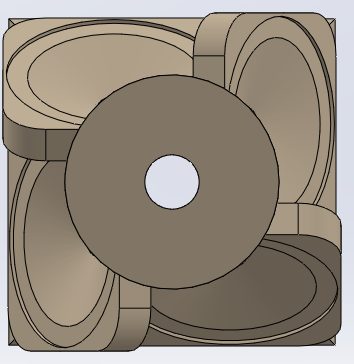

With 4 small mids instead of two large ones, your mids should be pretty much centered over the ports and yield their full BW, limited only by the bandpass chamber and port. I on the other hand have to struggle for just a couple of hundred Hz extension on the high end beyond where the mids "want" to roll off when just screwed down to the horn wall.
You are showing BW out to almost 2 Khz. I understand wanting to maximize this BW but in this case it may be misguided effort. The synergy constraints on mid entry point may dictate a significantly lower crossover frequency and using bandpass effects to limit the bandwidth to just that frequency will ultimately lead to a better phase characteristic, IMO.

@ xrk971 - yes, I suppose the more equal the path length from the cone to the port the less internal cancellations will occur. Right now ABEC is simulating a flat piston into the frustum, which should tend to give greater deviations in path length than if the cone had been modelled properly. It will also underestimate the air volume.
@nc535 - one of the reasons the 3d drawings look so "funky" is that the drivers are perfectly centered over the entry point while still getting the entry in the corner of the horn. I need to model the mounting plate "towards the horn mouth" because the transition from 13 degrees round exit of the CD to the 60x60 square starts there. Pushing it back would just shift the entire horn back I think, unless I misunderstand your point. However, I don´t think the mounting plate needs to be 100mm in diameter -- just need enough to keep it stable and something to screw the CD onto. So I´ll probably redo that later to get more space. The bandwidth seems to be limited to the first reflection notch. (half a wavelength @ 1800hz is about 10cm, quarter wavelength is 5cm. I have the mids entered at 55 mm from the CD exit, and then one has to account for the throat of the compression driver, another 28mm there. So it would seem from the distances that the reflection would appear lower in frequency, but i would think that the horn shape reduces the apparent distance).
I did try a crossover based on a previous version, with a smaller frustum, but with a cylindrical compression chamber instead. Everything else is the same. The extra bandwidth is a benefit, as I was able to model quite good phase coherency without too much fiddling. (Whether it will work in real life is another story -- I´m very aware of the comments made by Tom and others regarding how a simulation is garbage in-garbage out.). But it´s a good starting point I suppose. But if I understand you correctly, you suggest that I either 1) move the mid ports further out - to get a lower first notch, and/or 2) make the compression chamber more "cancelling" to reduce the high frequency output to better match the crossover frequency I´ll end up using?
The higher frequency notch is due to the compression driver modelled, not because of the geometry of the horn here. The big frustum gives a smoother midrange response, so I think the crossover ripply can be reduced compared to the images above (but of course, other sources of response problems could appear that haven´t been simmed..)
You obviously have a much more complete model than any of us have had so no doubt will encounter fewer surprises.
Yes making the CD plate thicker does push the entire horn back, which might require a lower crossover point or adjustment of the mid entry point, but is a way to relieve congestion. And if you do push it back, then your model has to change so of course you wouldn't do it without good reason. I was pointing it out as a possible solution for the congestion you noted as it helped me in that regard.
Yes you did understand me re' the BW and crossover point issues.
My point can be seen in the crossover frequency responses you posted above. That shelving of the mid response right around crossover can be likely be smoothed out by the means I suggested. And the further out you can move the mid entry point, the less effect the holes will have on the high end response...so long as the CD doesn't have to strain to reach down to crossover.
On second thought, I think acoustic low pass filtering via the bandpass chamber and port may be a different game with small sealed back drivers. The large drivers used in two ways trap a lot more air under the cone and it seems you need this to achieve acoustic low pass filtering. With the 8FE200s I need to add a structure under the cone to displace air. You may benefit from standing your mids off the horn wall on rings to add volume to the chamber - to the point where adding incrementally more air changes the slope of the rolloff. Ideally, you would get the acoustic rolloff from the bandpass chamber to roll right into the cancellation null slope eliminating the shelf I see in your posted response. Yes, you can do that electrically but if you do it acoustically you filter out driver harmonic distortion products as well.

@nc535: I tried adding some volume under the cone (i.e. spacing ring) as you suggested. It actually increased the peak in the upper midrange quite a lot. While I haven´t tried simming an open back midrange, I suppose you are right that these changes should be balanced with volume on the backside, which can´t be done with a closed back mid.

I started thinking about the mounting adapter, and how to make this 3D printable. One thing that´s difficult with 3d printers are overhangs. One rule of thumb I found is don´t make overhangs more than 45 degrees. So here is the latest iteration (see below. After uploading I noticed that I had forgotten to pattern the actual frustum around the horn, but you get the idea anyway). I think the untapped-tap holes (and access hole for the one tight corner) are the only thing that could cause an issue, so worst case I´ll do those after printing.
The entry holes are 2mm farther away from the throat now compared to the previous version. Now I need to add some bits to fasten this to the wooden horn.
