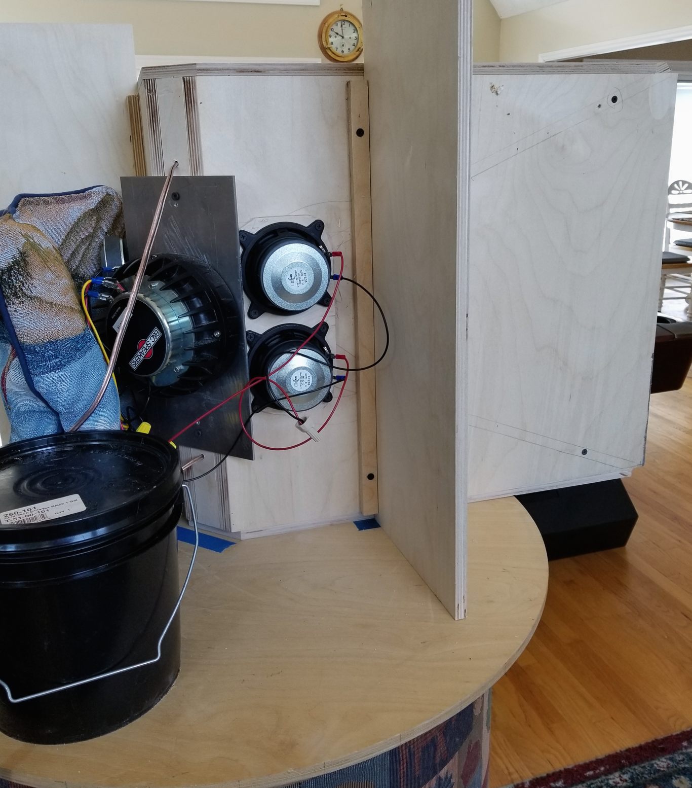

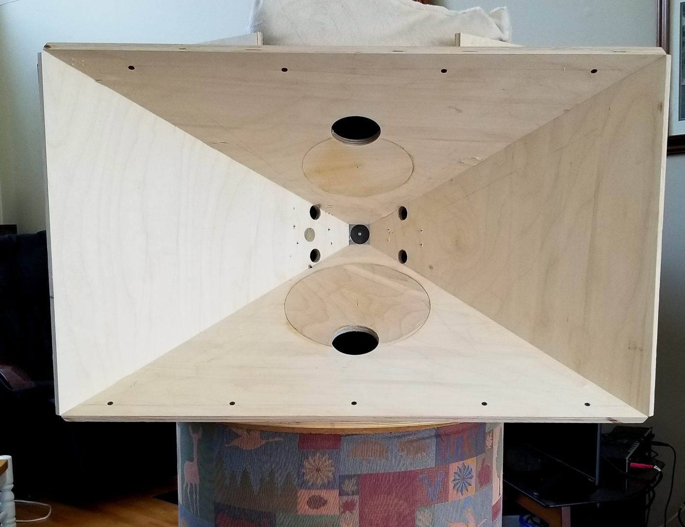

Well, I call her Syn 9 proto...a 90x60, 31"x19", test sled, with no secondary flares.
Port holes were made, tried, and plugged/patched.... re-holed, re-made, etc.
Using leftover cone drivers.
The small mids aren't even sealed...i just put a couple of wings on the horn to block forward radiation. The 10"s at least have their own sealed chambers.
No matching of CD exit to throat.... 😱
Piece of junk, albeit Millennium Falcon style! (With spot on tuning 😉)
DCX464 HF & VHF
four 4fe35 Mids
two 10fe200 lows
Xovers at 100, 250, 650, 3800Hz. All steep lin-phase.

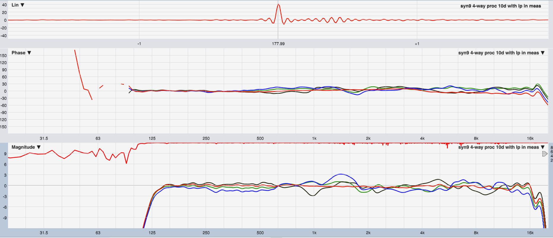

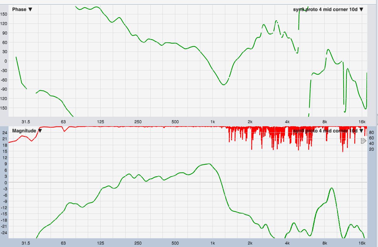

Thanks Ernie.
The mids can easily reach 1kHz or above...here's raw.
Yep, I've followed your CD threads with interest, knowing i might someday want to try a normal CD.
But it will probably be one of the last things i try because when raised to 650Hz, I have no complaints with either of the coax CDs. No bite ever then.
I will try raising xover some on this proto, probably all the way to 1.2kHz just to hear, and know what is usable in a normal CD. If listening get's any better than it already is at 650Hz, i might explode out of joy. Lol.

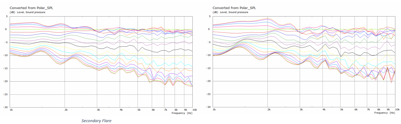

The polar response of a conical horn looks much better with a secondary flare added
Hi fluid, yep agreed.
So far, comparing all my builds which have had close to a 1.5 H-to-V aspect ratio, the biggest improvement in mid frequency and up polars, has been in the 1-2kHz range where i get a flipflop around flat tuning made at 10 degrees off-axis.
Like shown on this 0-20 degree set from the current proto.
Secondary's have mitigated about 2/3 the oscillation, but not eliminated it.
I've never been able to make an apples to apples comparison of a single flare vs a 2-flare, because i believe the mouth sizes would need to be the same to do so. (Do you agree?)
I've always just added secondary's to the already built primary and measured the change in polars.
The increased mouth size improves low-mid, upper-bass polars, through lower frequency directivity. It also changes the tonal a little, in a pleasing authoritative way.
But i'm guessing that down-low directivity increase is all due to mouth H-V dimensions and might not matter 1-flare vs two.
The current syn9 proto project has morphed into a pretty large 60x60 with a mouth circumference of 118Hz. Maybe (probably) directivity is all just about Keele's directivity formula, and not about mouth area...but it will be interesting to hear firsthand.

The XT1464 high frequency directivity rolls off considerably more at 30 degrees, than a 60H syn horn.
I can say, despite the fact the XT1464 is a little better at HF/VHF than the syn horns, the overall sound of the syns is better than than the XT1464 used over a single 12", or 18", or in a MTM with 12"s. (all using same xover to CD, same tuning).
The integration of drivers acoustic centers in the syns dominates i think...making the lower octaves foundation flow into the HF/VHF much better....with greater overall clarity.
It's like the integration improves the HF/VHF too.
It makes me wish for a big OS horn with port holes, and cone-driver mountable rear surfaces.

In principle if you change more than one thing then you cannot fairly decide what was the cause of any difference found.I've never been able to make an apples to apples comparison of a single flare vs a 2-flare, because i believe the mouth sizes would need to be the same to do so. (Do you agree?)
To avoid the low end directivity change the mouth sizes would need to be kept constant to remove that variable but I don't think it is necessary to see the benefit of the secondary flare. It is the same thing as properly terminating an OS waveguide. An abrupt termination is no good from the point of diffraction, reflection and consistency of the polar response. You can see all three get better in the graph I posted above as well as the extended directivity to lower frequency from the bigger mouth.
When I was simulating rectangular guides I found that if the aspect ratio was more than about 1.2 then odd things started to creep in that couldn't be tweaked away.
This sounds somewhat contradictory but I think I see your point 🙂 For me the reduction of reflection and diffraction from the better mouth termination is more useful but it does also seem to come with better polar control.An aside on my evolving take on the significance of polars....

I can't help but notice the similarities to my single flare conical. Mine is 29x12" mouth size and uss the 1" exit BMS4550 crossed at 1050Hz. It sounded great despite pretty terrible polars and waistbanding. Vertical pattern control was lacking.
I'm sure a secondary flare will make major improvement there but if you really want good polars, you should go the ATH direction. A 60 degree axisymmetric horn with optimized throat and mouth rollback would be just thing if you could figure out how to make one in a plus size 🙂
If you are adding mids you should definitely go to a 1" exit CD. I'm sure you will appreciate a CD whose top end is smooth prior to equalization. The BMS4550 does not sound harsh when crossed at 1050 with a 24 db electrical slope, which turned out to be 48 db acoustical.
I really like the 4NDF34; wish I had used them. I'll bet 4 of them are good for your SPL levels down to 200 Hz or so.

I did at least try curved secondary flares made out of 2" foamboard. Unfortunately they resonate above a certain SPL, with no way to eliminate it.
(It was a bitch to make them too....)

Hi grec,
What mid drivers are you using? Where crossed? Port(s) sizes and locations?
Interesting you found 2 more pleasing than 4.
I used four 4fe35s instead of two, because it was clear they would still be the weakest section in the proto synergy.
The 60x60 i'm working on now has four stronger 4NDF34s, and even those will be the first driver section to run out of headroom.
