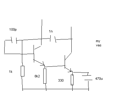

no, a normal input with darlingtonvasYours is now cfp-input with darlingtonvas ?
In the sim, my circuits is stable with 47p compensation capacitor but in the real circuit i must use 100p .But with 100p comcapacitor olbw is around 3kz
No, i mean like the 100k in my folded cascode. It's a fixed resistive
load to vasoutput.
I don't understand your 1nF, is it connected to collector of 1st bjt ?
Or is it a RC to supplyvoltage ?
How big is your feedbackcap ? (The one in the feedbacknetwork)
I think your 470uF is risky, charging this one at startup will give
very big current through the vas, this might blow outputstage,
and if these are not matched (assuming symetrical design), you get
big startupthump.
load to vasoutput.

oh! i see I used 10k instead of using 100k .The result is bad with a large of distortion. But in a normal vas 10k get a good result .I remark that folded cascode is not like some normal circuit
mikeb! with 470u ,the distortion is increased by many times
no . It is 2 pole compensate network .I use 2 capacitor 100p and 1nI don't understand your 1nF, is it connected to collector of 1st bjt ?
thanh said:I remark that folded cascode is not like some normal circuit
Yes, folded cascode is a bit different...
Hmm, if the distortion is increased by many times with 470u, why use it ?
I think this was a typo, it should increase openloopgain dramatically,
but also decrease bandwidth...

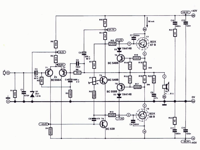

Hi, Mike,
I just got the "overbright" problem with this kind of design that I attached. I modified the final stage, using ordinary discrete darlington, and not putting the output limiter. So, lets just concentrate with the differential and VAS only from the attachment.
I experimented and seems these 3 solution can work to cure the problem (widen the OLBandwith?)
1. Put Degeneration Resistor on T1, T2, T4.
2. Put resistor from collector of T4 to ground (I tried 10k)
3. Put a resistor parrarel with C6 (Parrarel to miller cap in VAS) 220K.
But I don't like the sound change with option no1 and no2. This makes me left with option no3.
In DougSelf book, putting this 220k parrarel with miller cap is a cure for "linearizing VAS". But is this also helps in widen the OLBandiwith or not?

Hi lumanauw !
I think no1+2 simply reduce gain and widen bandwidth and linearize.
10k to ground for no2 was a bit much ? Try 47k or 100k...
I am not sure what exactly this resistor (no3) does, it should linearize
and reduce the effect of c6. Need to check. But it should also increase
bandwidth as it reduces gain.
I know what you mean with not liking the sound, i have this problem
with my last 2 amps. Optimizing them to behave "optimal" produces
unpleasant sound, it's some kind of too hard or dry. Very annoying...
So much about theory ?
Mike
