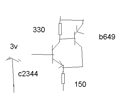

Hi, Mike,
Maybe putting CCS instead of resistor in your FC will change your final result one more time 😀
Have you tried my suggestion for your FC here ?http://www.diyaudio.com/forums/showthread.php?postid=482060#post482060 Suggestion no.3and the other uses a folded cascode (with active current sources rather than resistors).
yes , or I can use mr evil's topo😀OTOH, I may still choose the cascoded VAS, as the results are quite acceptable, and it is simpler and appears to be somewhat more bulletproof when abused
yes !as the cfp introduces more delay.
mike! this is my old vas .I have just removed it yesterday

I had not really better results with cfp in vas, seems that cfp is most
interesting for diffamps ?

- Symmetrical folded cascode.
