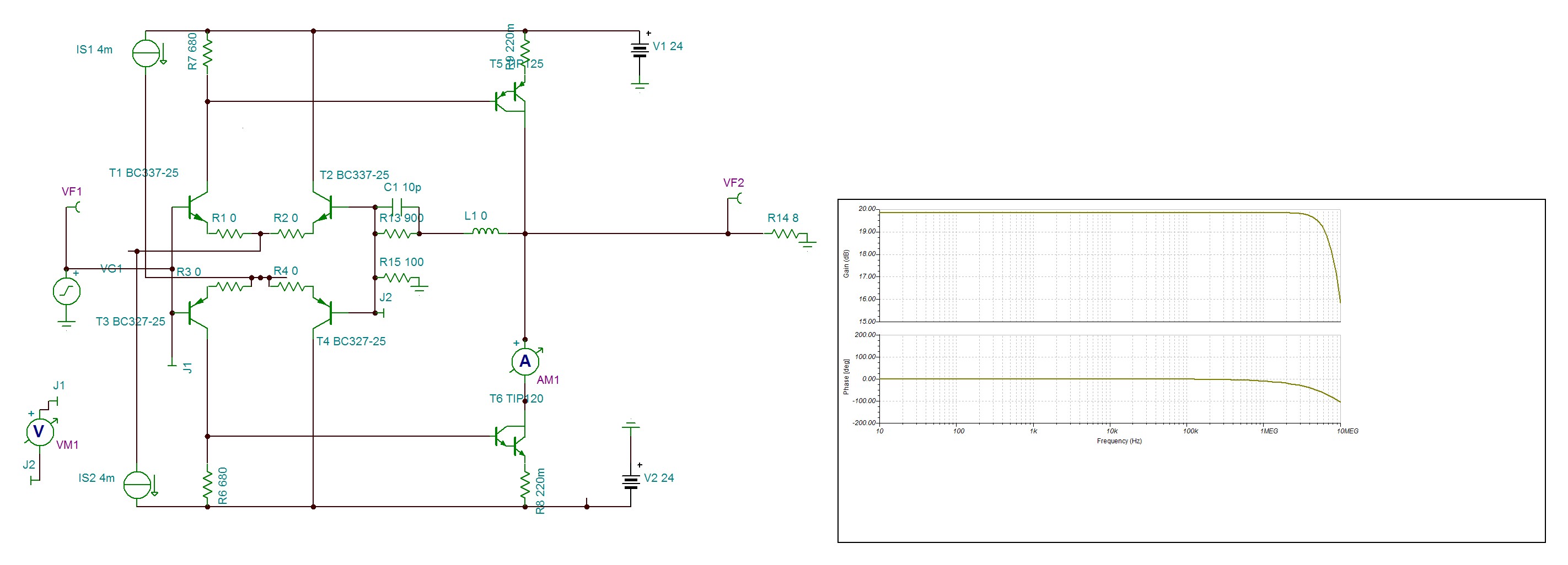

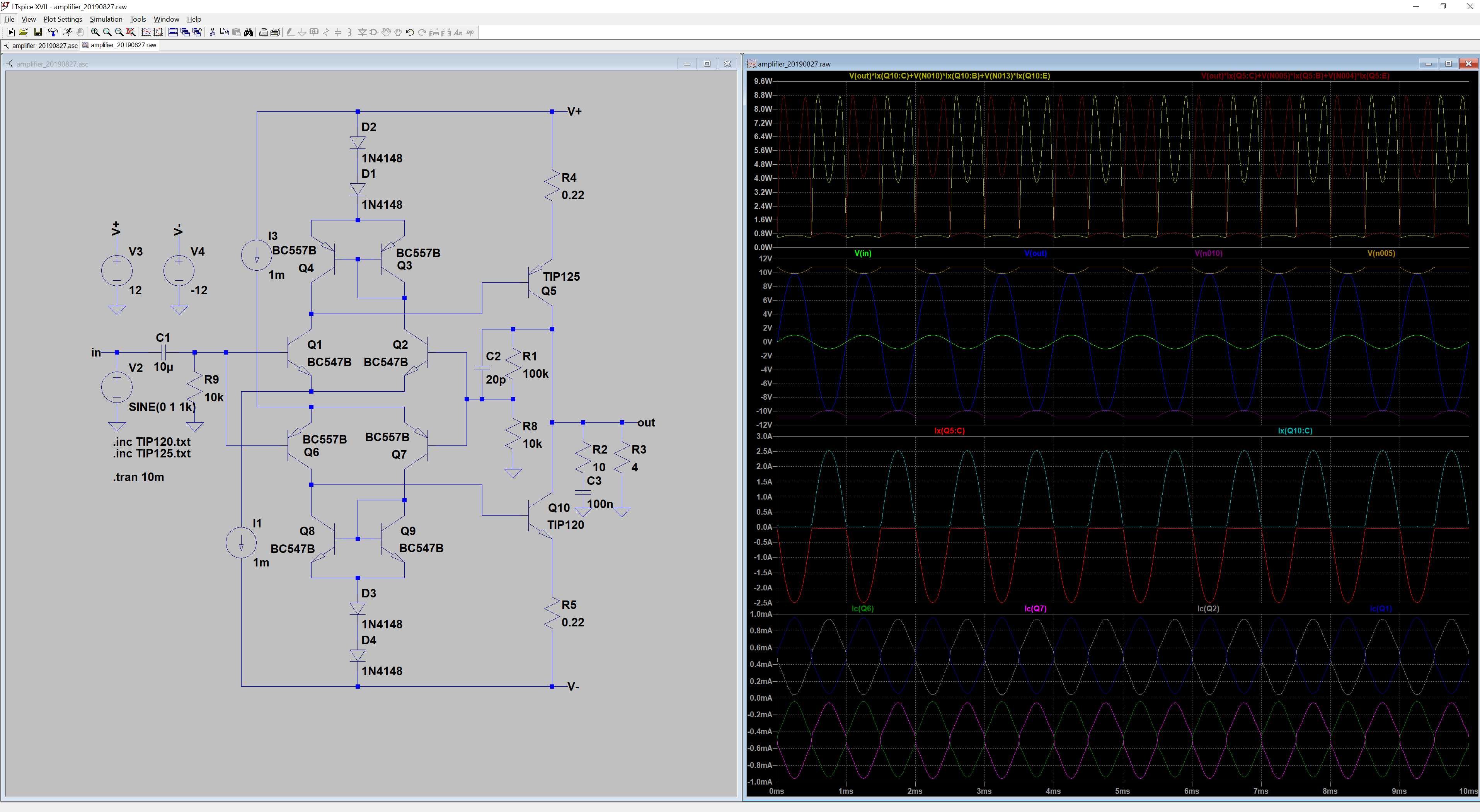

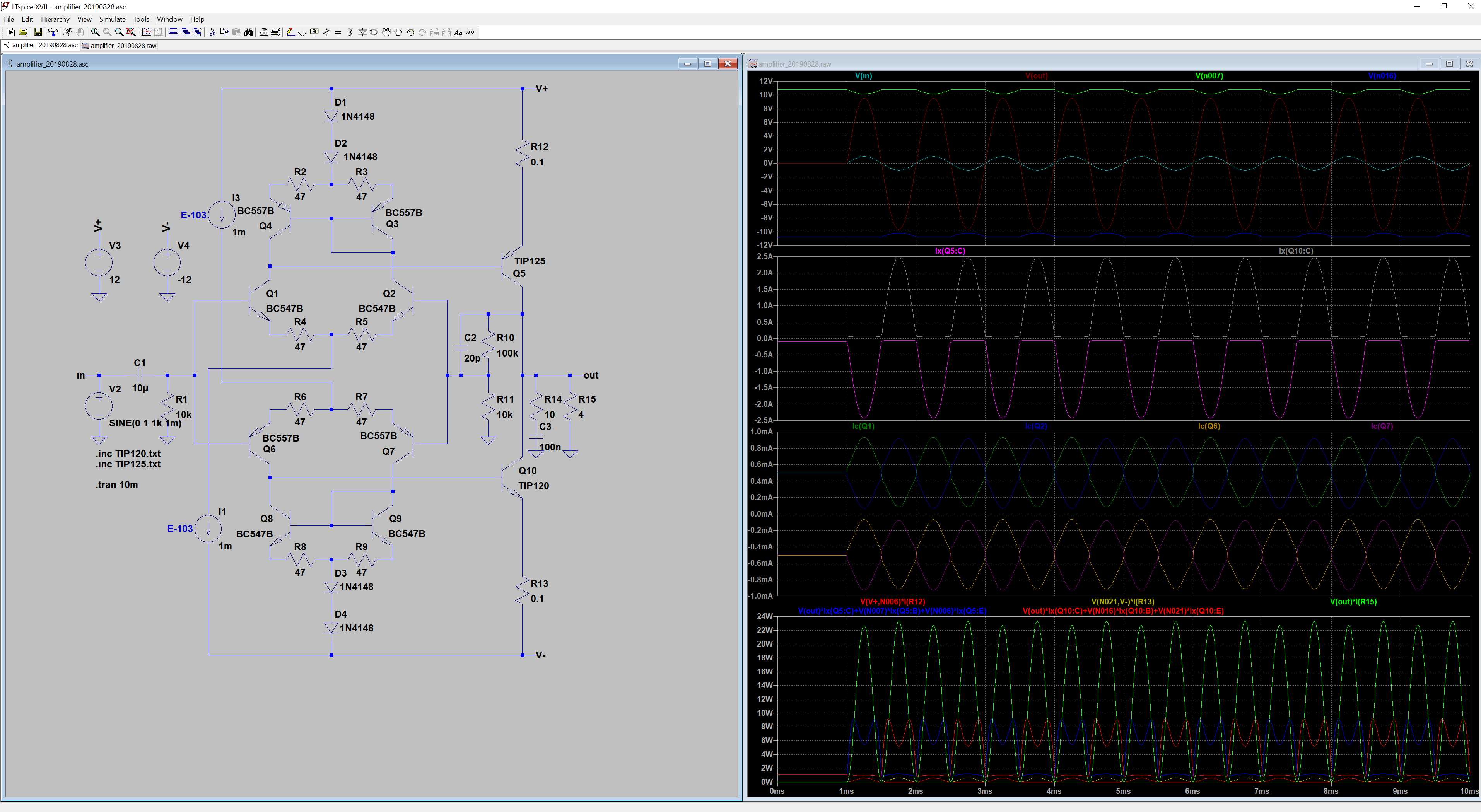

You are right , with identical transistor wired as diode the current mirror is near perfect . The problem is that to bias the outputs, the mirror must reflect a dc current less than it receives by 90uA to bias the output transistors . The reflected dc current with transistor ,as you read on the measurement 2.01mA, is 10uA more . With diode as you read is 1.85mA, 150uA less , by this I can adjust it to 90uA either by reducing the emitter resistor or increasing the base current of the mirror .D1-T7 and D3-T9 in post #30 don't match, as a 1N4148 is not a BC550C or BC560C (although the much increased emitter resistors and tail currents should make the circuit less sensitive to that).
I made an error . The supply voltage on precedent test circuit should be 1.2V instead of 12V. Then the currents are 1.99mA and 1.82mA .
Assuming that that 90 uA has to be accurate to within +/- 50 %, you can allow an error of 45 uA. You have differential pairs biased at 4 mA tail current with current mirrors. A mismatch of 600 uV between the VBEs of the differential pairs already gives you a 45 uA offset, if I calculated it correctly.
You will need very well matched transistors and accurate current mirror emitter resistors to have any chance to get this working, unless you come up with some clever self-calibrating loop.
You are forgetting that the bias current is adjustable by R10. If due to mismatch you have less than 90uA without any R10 applied than the bias can be adjusted in double transistor current mirror case ,or else the transistors in the differential must be swept if they are unmatched . In diode current mirror, R10 decreases the unbalance. If the differentials unbalance less than 90uA ,Than R10 can still decrease it. To remind that the feedback balances upper and lower unbalance.

Now the circuit (post 44) make sense to me. Endstage bias is set with R10 (mainly) to be modulated by the difference of current output of first stage differentials and current mirrors.
Without this bias fixing R10 the amp is totally dependent of this minute current difference from the first stage, hopefully completely temperature stable.
I wouldn't bet on such an extreme fluid design. Might work in class A in summer, to become B in winter. BJT's are nasty with temperature. Can you perform a temp-sweep simulation with your software? Let it run from -20ºC to +60ºC and bias current as output.

The output transistors work with unique type of bias , current instead of voltage ,this is the ingenuity of Günter's circuit . The bias normally depends on Ic/Vbe diode transfer function , here it is Ic/Ib that is Hfe dc curve that gives the bias . The temperature variation not only effects very little , but also the value of the bias itself is not very critical . The Hfe curves show it double or halves by +/-75°C. That is 15ma can become 7.5/30 ma . This is ambient temperature of -50°C to 100°C .

The IC-VBE characteristic of a bipolar transistor is very nonlinear (ideally exponential, current increases by a factor of e for each kT/q increase of VBE), compared to that the IC-IB characteristic is almost straight - although in this case we have Darlington transistors with internal resistors that may mess things up a bit at low collector currents.
Trimming the bias current will help a lot, but you have to be careful with temperature gradients or unequal dissipation. That 0.6 mV allowable differential pair offset I calculated corresponds to 0.3 K of temperature difference between the differential pair transistors.
Ian Hegglun has published some amplifiers with current-driven output stages, if I remember well. My MOSFET amplifier from the mid-1990's also has current-driven output devices.
Gunterflunder's circuit has the current mirror output transistors biased in saturation, so it is not really pure current drive. In fact that's what causes its non-switching behaviour, I expect that kokoriantz's circuit switches off the NPN side when the PNP side conducts large currents and vice versa.
