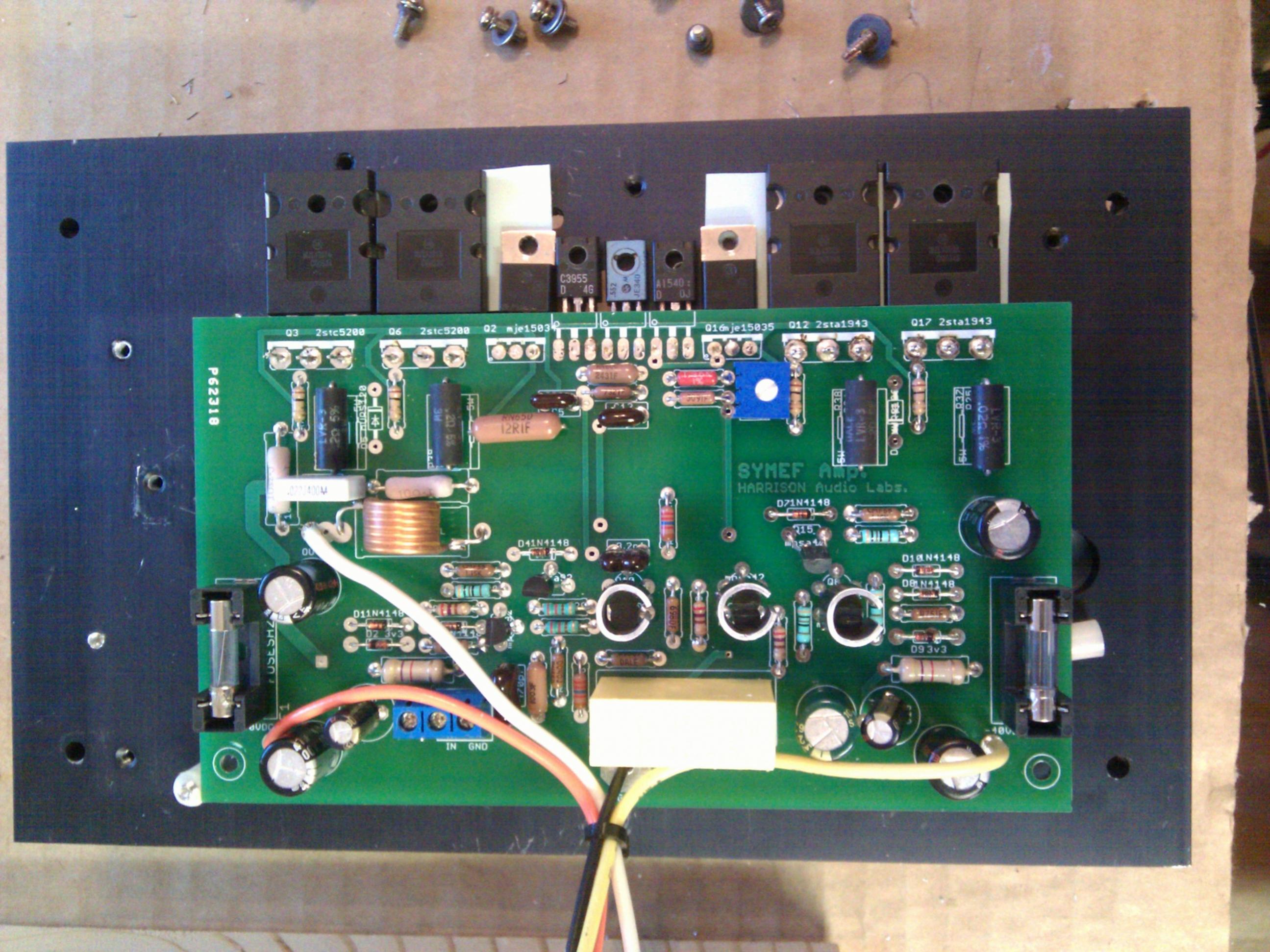

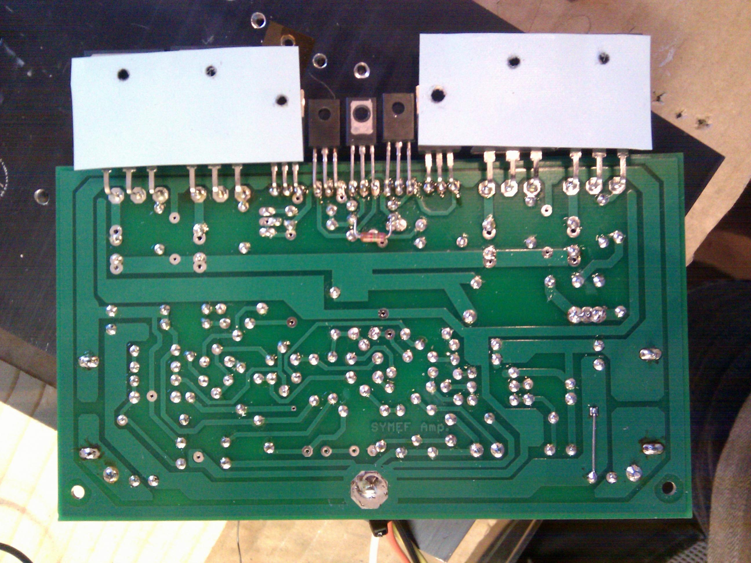

Got some free time during this weekend, so resumed my build again. The difficult part is drilling, tapping and finally aligning the transistors and bending them carefully so they are same height.
I've spent several hours on this. While tightening screw on one of the power transistor the screw head came off. Made a failed attempt to remove the leftover part, don't have patience to drill new set of holes. Luckily I had a L shaped object that I've used to keep the other transistor in contact with the heatsink.

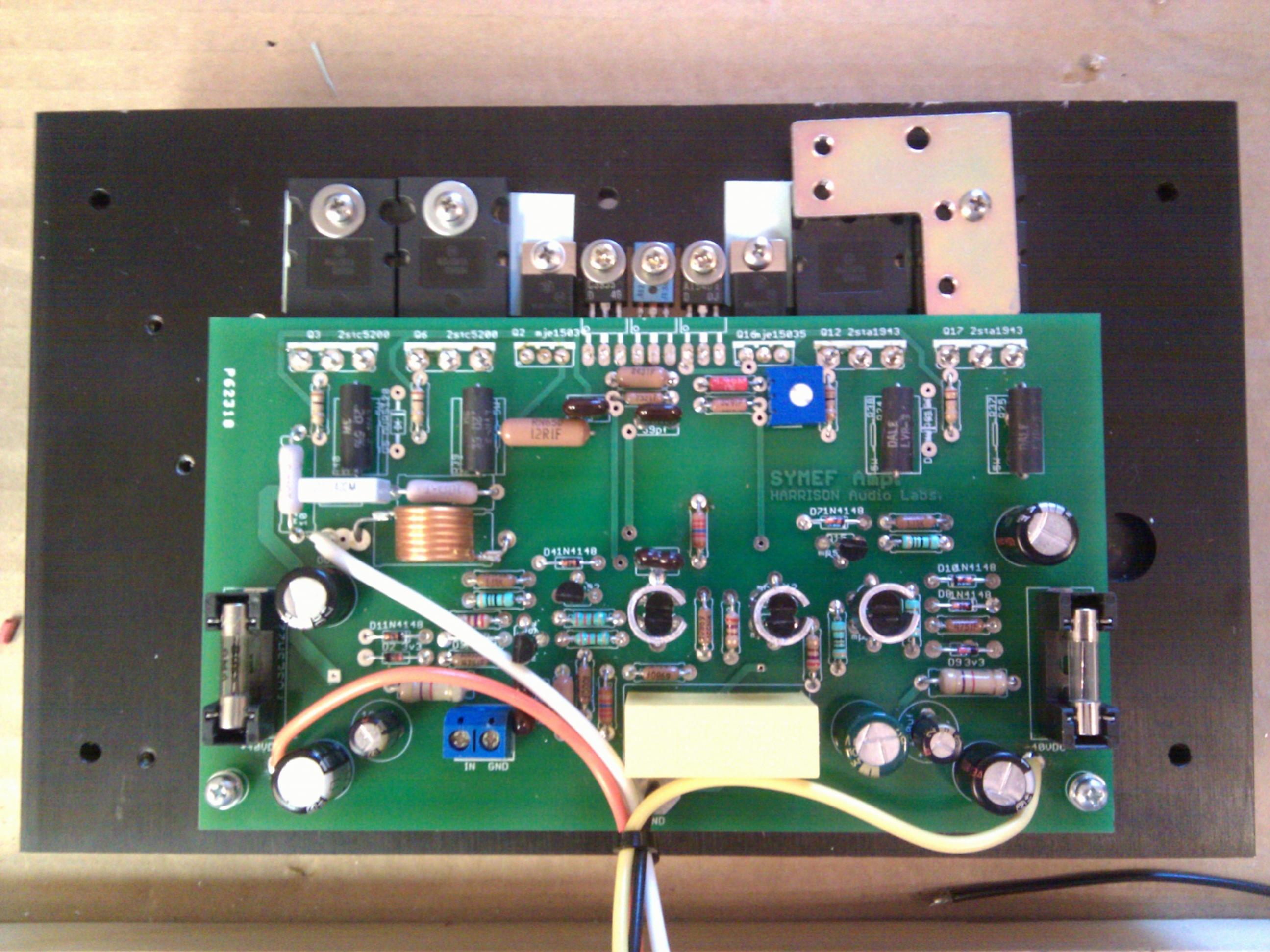

Fired up and measured all the voltages, they seems fine and the offset is only 2mv. Need to setup the bias, what is the recommended value of the output current for these transistors? May be I'll test with real speakers next week.

Very nice.🙂 Try keep the output wire away from the input. Ensure that the transistor where the screw head came off has enough contact with the heat sink.Its failure could lead to a cascade. Set bias by having 23mV across R14. Cheers.

Thank you Mr. Harrison, I've set the bias as you suggested. Amplifier build is finally complete over this weekend, ofcourse need a very good case to justify its performance. There is no hint of any oscillation, bias is quite stable, and vbe multiplier is quite responsive to heatsink temperature. Probably need to adjust the bias after it reached steady state.

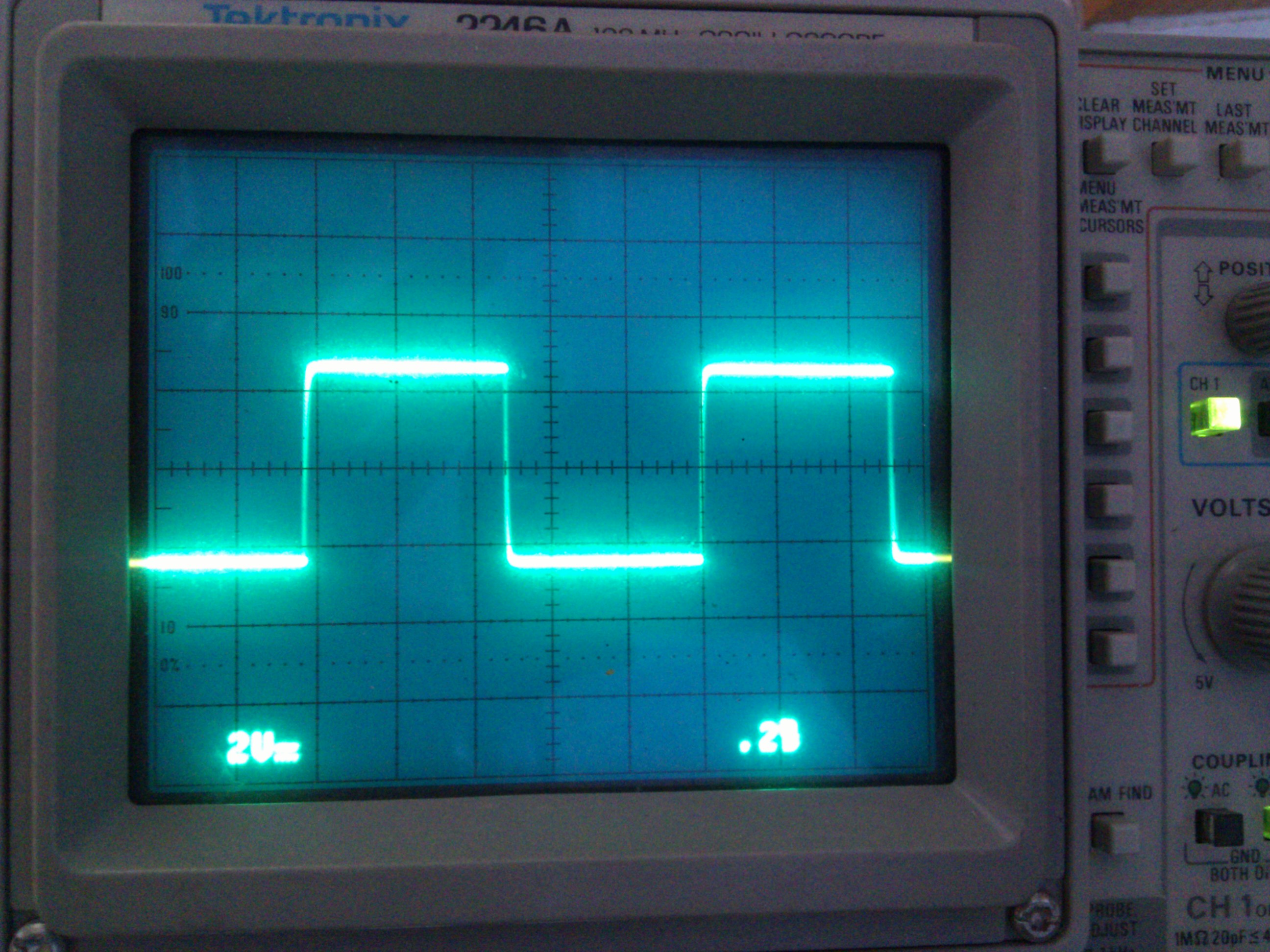

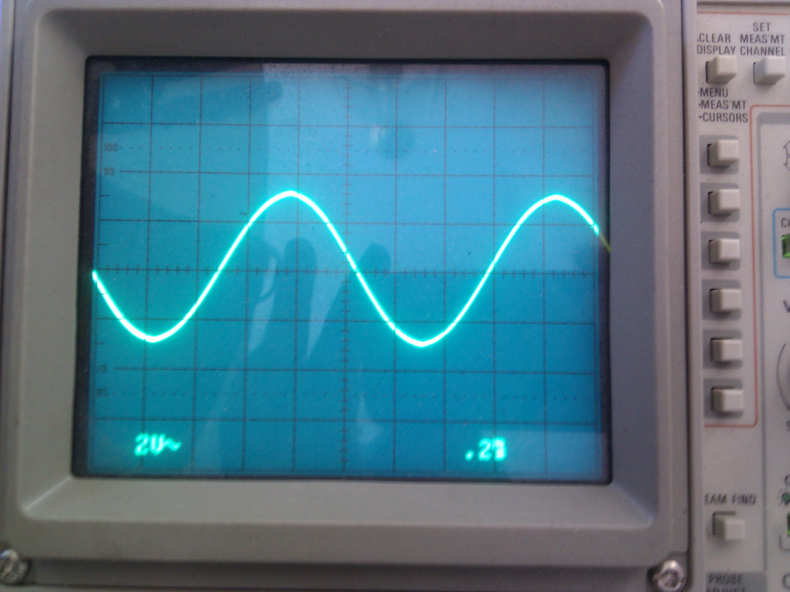

Measured 1khz and 10khz square wave and 10khz sinewave response, its clean and rounded edges on square waves.

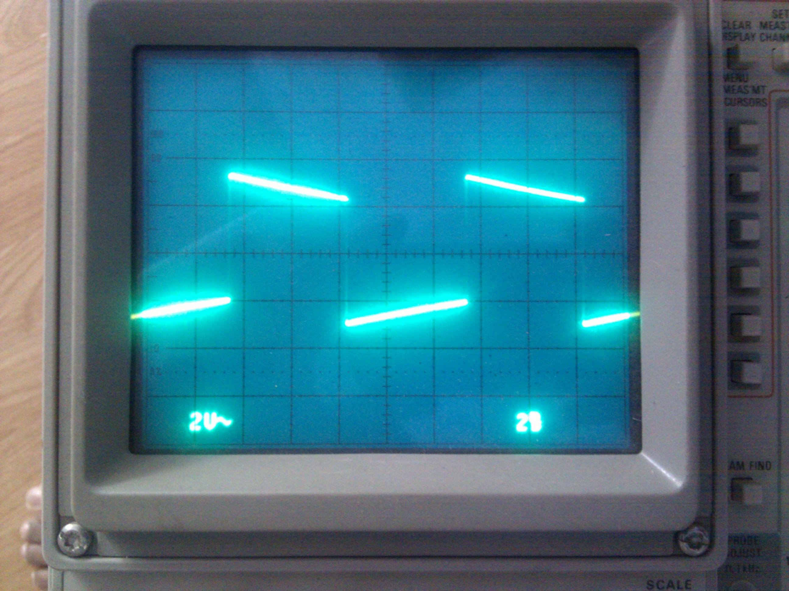

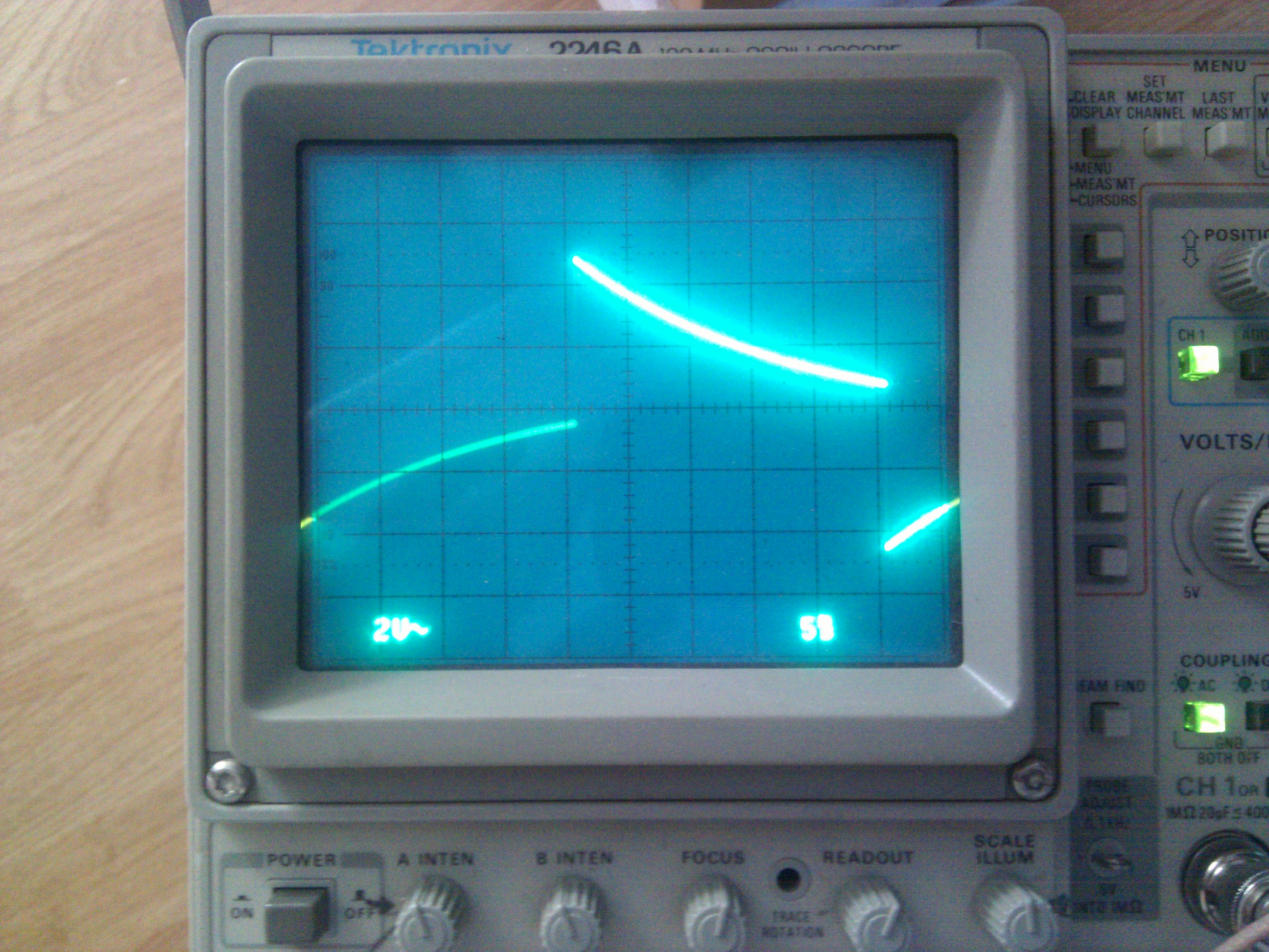

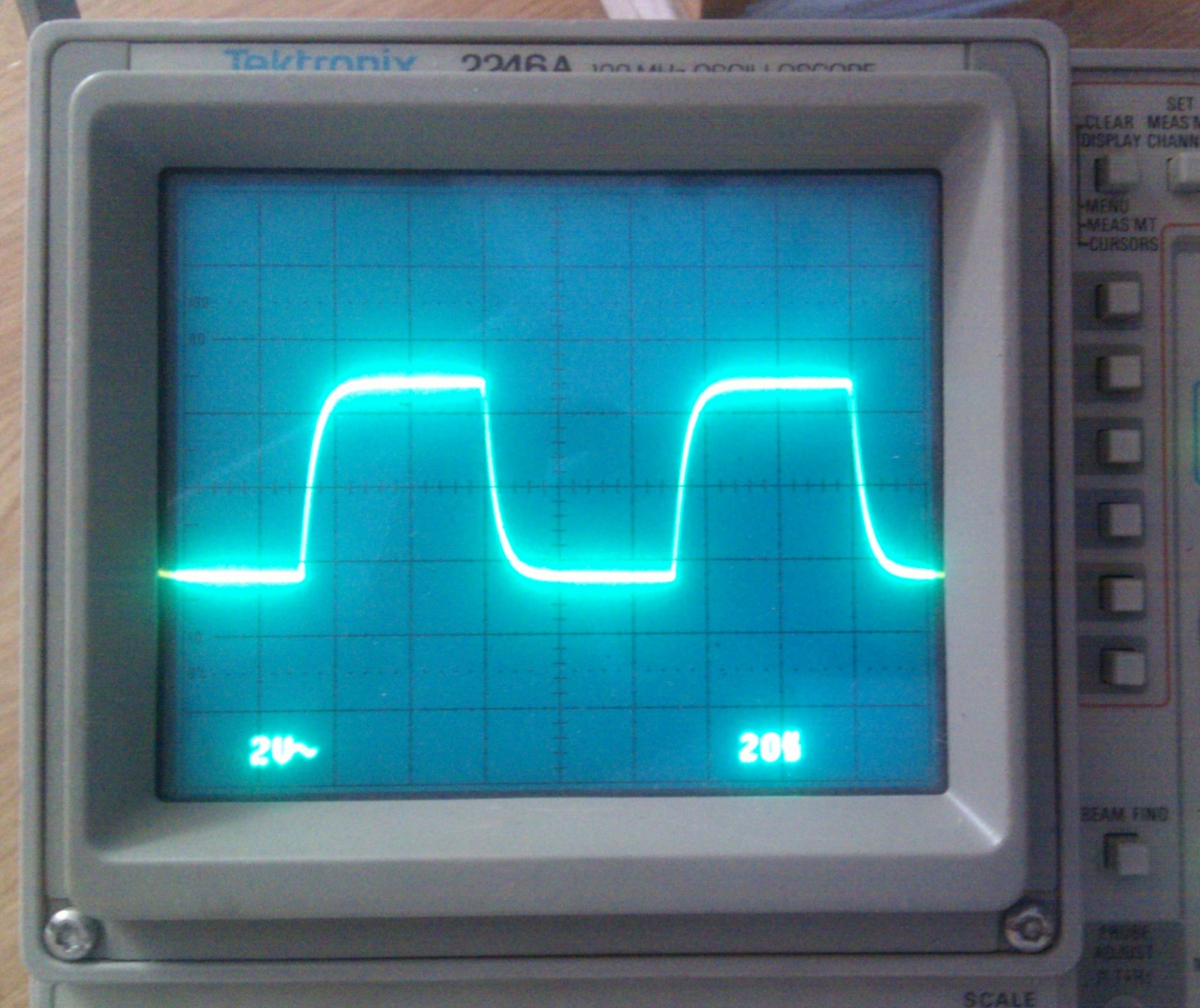

SYMEF measurements
Hi Nico,

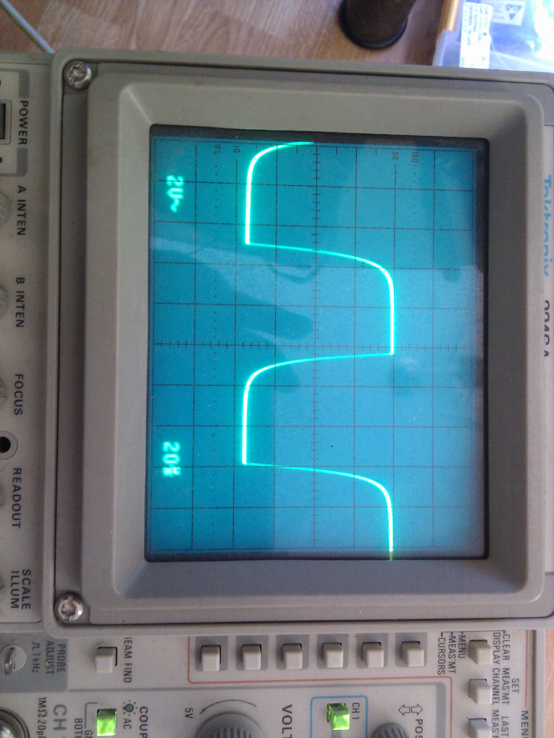

Here is the square response of SYMEF at 20hz, 100hz, 10khz and 20khz into 8ohms pure resistive load.
Hi Nico,

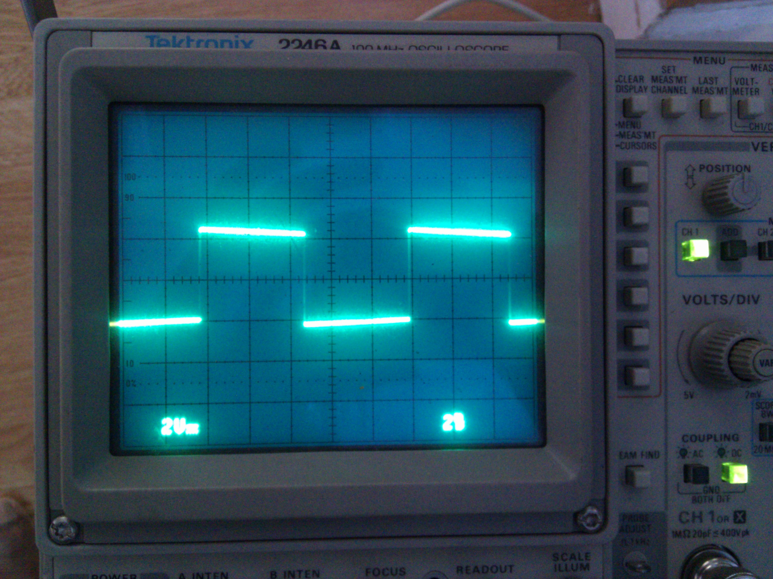

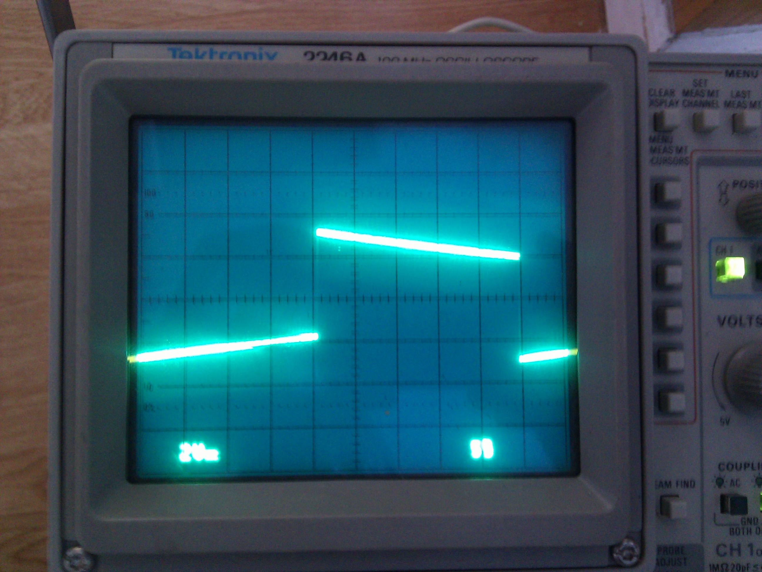

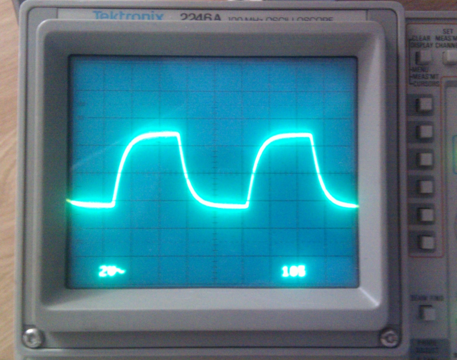

Thank you very much Routhun. I trust that you found this low frequency response both unexpected and puzzling. However, your scope is on AC coupled please use DC coupled else the effect is accentuated by the probes high pass filter. I would like to see your power supply's effect on the low frequency.
SYMEF measurements with DC mode
Hi Nico,
Thank you for correcting me it was my mistake, I was using the AC input mode thats why square wave response is not great at lower frequencies. Now I measured again with DC input mode, now the response looks much better.
Thanks,
Hi Nico,
