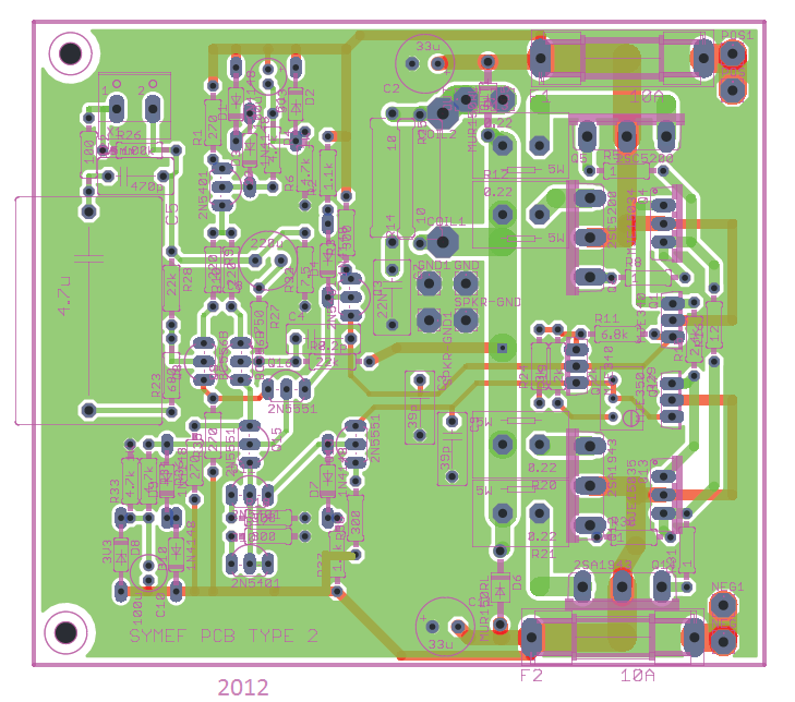

Thank you all who have contributed your time, ideas, expertise and investment. We have many PCB ideas in this thread including Alexmm, Drowranger and this draft of the type 2 which I post for your scrutiny(the clean version has minor mods). I am hoping Terry will also share his new layout with us. All the best.
Comments very much welcome 🙂

All I can ask for the new revision is that you first check the hole size with components before sending to fab. It was way too tight last time... Had to drill some and force components.
Do
Thank you Routhun. Yes this PCB is different, the power transistors, drivers, predrivers and bias transistor are all mounted under the board. They will first be mounted onto heat sink using a mounting document. Then the PCB shall be placed over them and soldered. Very compact. Measures 4 * 3.5. You could build a 7 channel amp with them 😉

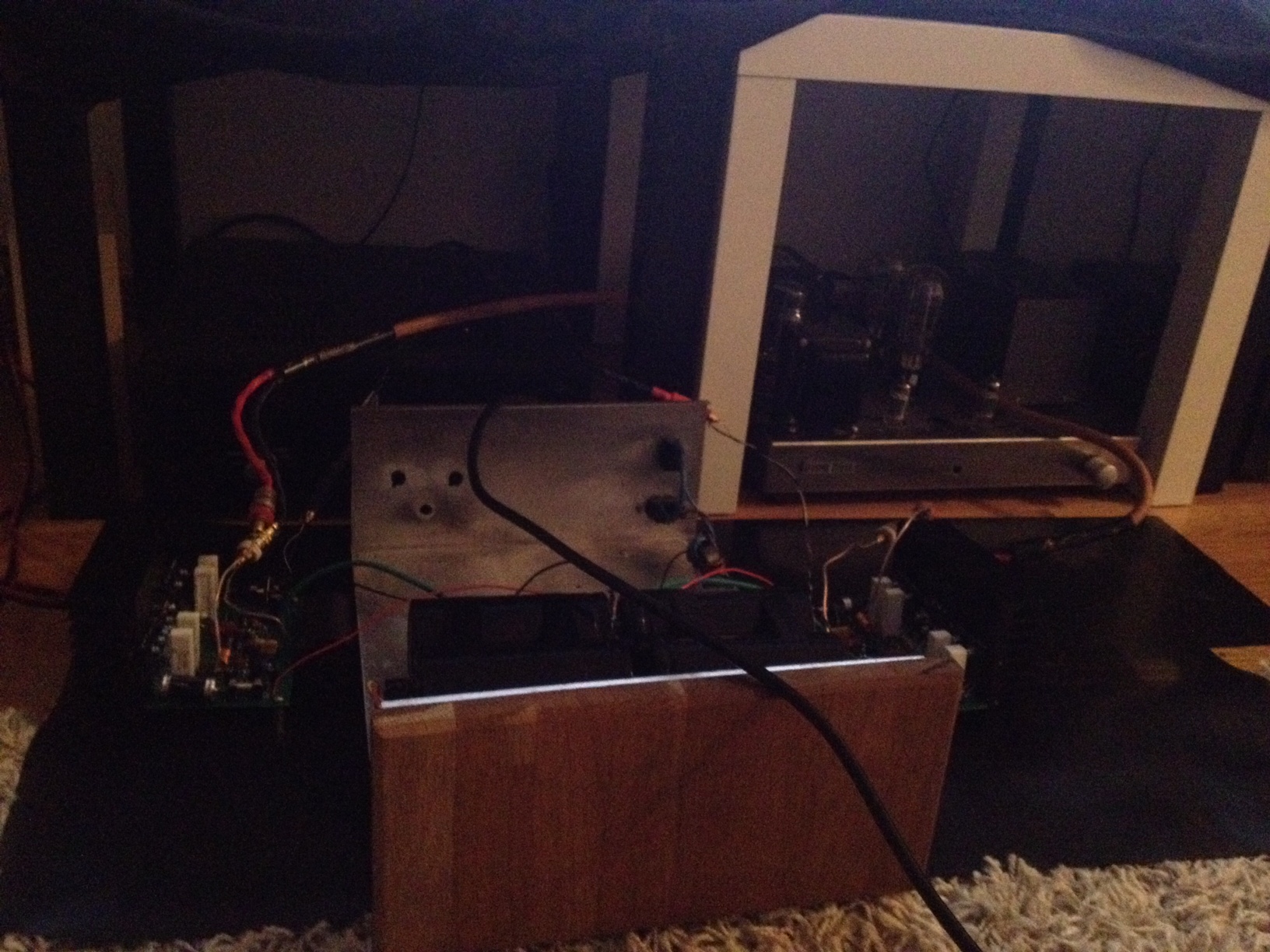

Almost there 😉 . I wonder what you will hear with the first few notes 😀
Hehe - one channel playing 🙂 That is one loudspeaker connected... Not my main speakers - yet...
So far so good... Extreme grip on the woofers....
Slight hum. Much more gain than my 300b amp..
I got 35Vdc on the rails... Will try to remove the power resistors in the psu..
Houston we have sound..
However with my main speakers (approx 97dB sensitive) the gain is just too much. I can barely touch the volume knob and it gets too loud.
I have to do something with that. Any suggestions?
Remenber I changed the input resistors some.. Not much but a bit..
And the input cap is 12uF.
Is it possible to bypass this BTW?
Soundwise - it got potential 😀

:cheers:Thanks for the update Bambadoo. Cheers, you have first note 😉 ......Extreme grip on the woofers...
Is the slight hum gone ?
Tell me more about your preamp. The amp reaches full power with approximately 1.3 V input . Does your preamp have a sensitivity control ?
Yes I almost fainted when i played Lee Ritenour as the first note. Holy crap - I felt the bass note right in my guts..
No the slight hum is there but I am not so concerned about that. It is a cable mess right now 🙂
And how hot should the heatsinks be? I can barely touch it.. I guess a bit above 50 degrees C?
I an hear hum (some hiss) for approx 3m away.
My preamp is an Audio Note l3 line.. With hi-B output transformers... Slightly (read very) modified.
I guess it has more or less the same data as audio note m8 (since I use e80cc-6463) tubes ... And a 33:1 OPT after that..
Under is the data for AN M8
Gain @ 1kHz 18dB
Input Sensitivity (for 1V output) 126mV
My setup looks more or less like this. The QuadIIs are gone...
Thanks Bambadoo. Does your preamp have both a volume control and a sensitivity control ? What input voltage are you feeding the preamp ? It seems you will need to feed it that 126mV. If the preamp does not have a sensitivity control you will need an attenuator. Good job. 🙂
