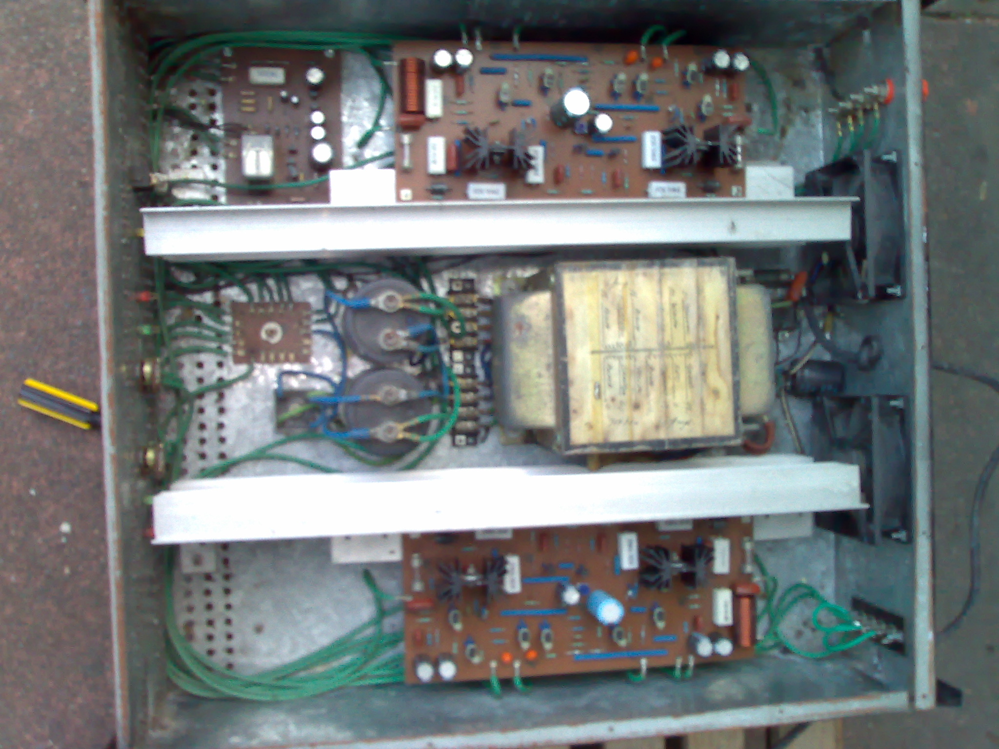

about grounding....
it is said, to prevent ground loop, star gnd. of pcb should be connected to chassis or HQG. in an absolute zero resistance.But it is impossible to have a zero resistance.One way of minimising the resistance is to use a thick wire from star gnd.(pcb) to chassis.
the second method I have used is that I have used a double sided pcb and all the gnd wires(input,decoupling,speaker gnd and etc.)are SOLDERED onto it. and pcb was bolted into chassis with eyelet between the screw and pcb.and placed it near the amplifier board reducing the lenght of wires.
Screwing the connectors and stacking it into one screw creates more resistance. it is said that current takes the least resistance.
here is photo that I have used in optimos.
regards,
joel

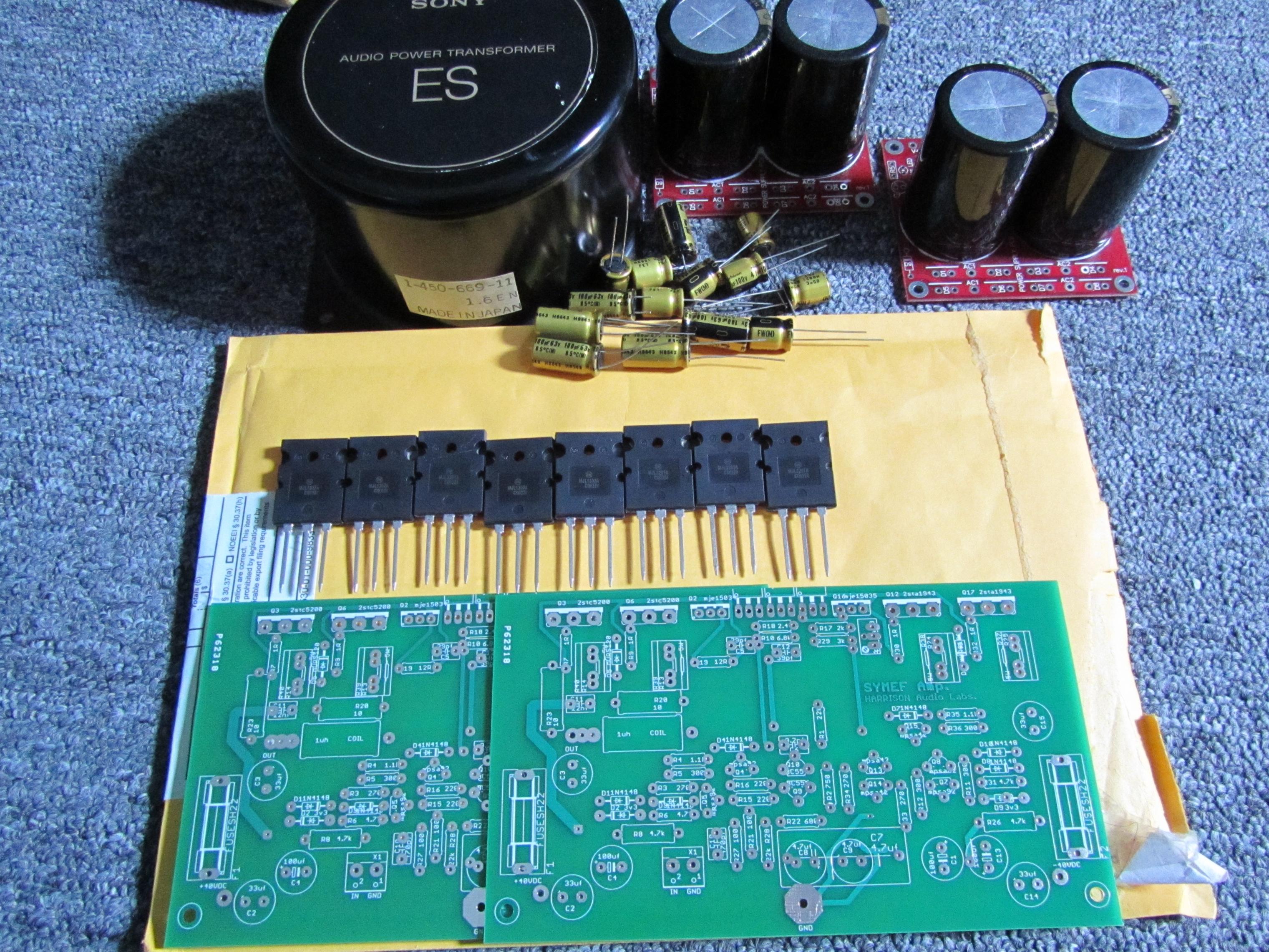

Hi guys, I started to gather the parts but I guess it will not be built as I will be moving houses again. As you see I have the PCB's with power transistors MJL3281 and MJL1302. Also Nichicon FW 47 and 100 µF caps are included and a nice shielded toroid and 2 power supply PCB's with 2 x 10.000 uF 63 V Nichicon KG each. If anyone wants this set please send me a PM. Considering the weight of the toroid shipping within Europe would be better. I am in a hurry right now but I think 120 Euro would be a fair price.
Sorry Harrison, but better an amp that will be built than an unfinished amp in a closet.

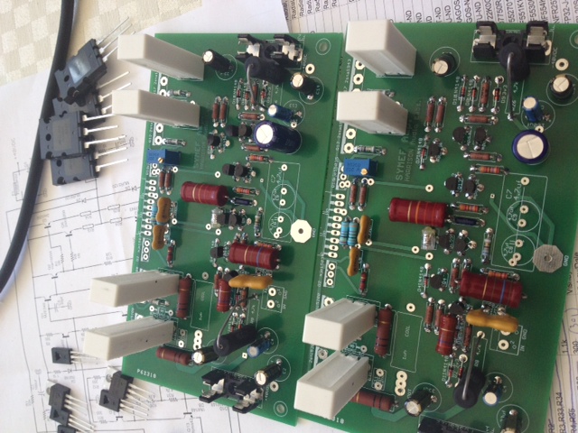

Quick question: (sorry about the double post. cannot delete the former)
Is it only the biggest 4 transistors that need to be connected to a heatsink?
Sincerely
Still missing: 1 power transistor (in transit)
mur120 diodes
some fuses
22nf caps
coil? (Is it necessary)
4.7uf caps... (forgot to order...) - will try to find some things in the closet.
