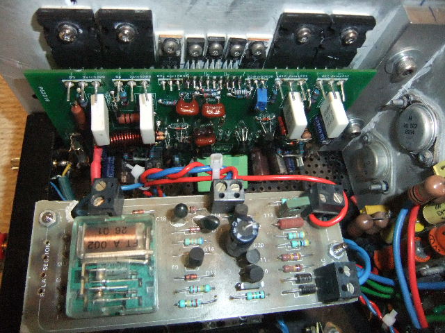

My PCBs are all done to the exception of the air core... How many turns on a regular philips #2 screwdriver with 1mm enamel wire to reach ~1uH required?

No you don't need a coil that's why the footprint is on the PCB 😉 Duh ! Why question such matters ?
I think a coil looks cool on an amp.. 🙂 Will make one.. Regarding number of turns. I think this was explained earlier in the thread..
Hi. I used 1.2mm (16 AWG) Wound around a 12mm (1/2 in) core. I first tried 18 turns as suggested, but I got almost 2 uH on the meter. Then I tried 14 turns and stretched it out to ca 1 in (to fit the two mounting holes that are closest on the PCB). That coil measures close to 1 uH. Note that you have to drill these holes as they are a bit tight. Don't solder some thin wire to the coil to make it fit. This component will carry upwards of 20 Amp! (worst case) Don't skimp on the wire thickness. As long as the length, diameter and number of turns is the same, using 1mm shouldn't have a great effect. Just remember that you will get more resistance and thereby more heat.

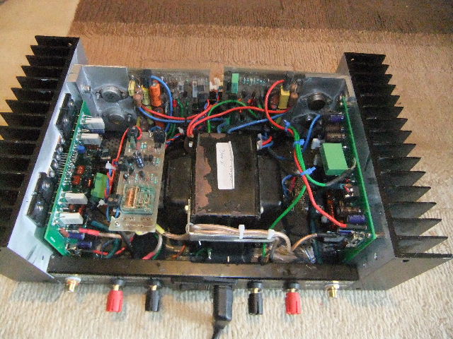

The construction went smoothly. My experiences and changes in relation to the original, I have described in the # 687 on this thread..
The problem with a distinct hum is resolved. My suspicion went quite early to two old capacitors. My PCB to the stabilized power supply is, as previously told, from a construction built in the mid eighties, that is a nearly 30 years old PCB. After the change of two capacitors (ellyt), SYMEF is completely silent to all kinds of noise.
A lesson to learn about capacitors: Use “fresh”.

Did you mill your Hafler heat sink???
Hafler's have ears on the heat sink for TO3 outputs. How difficult was it to remove the ears? I've always thought Hafler chassis would be great amps to work with if the price was right. Excellent build !!!
