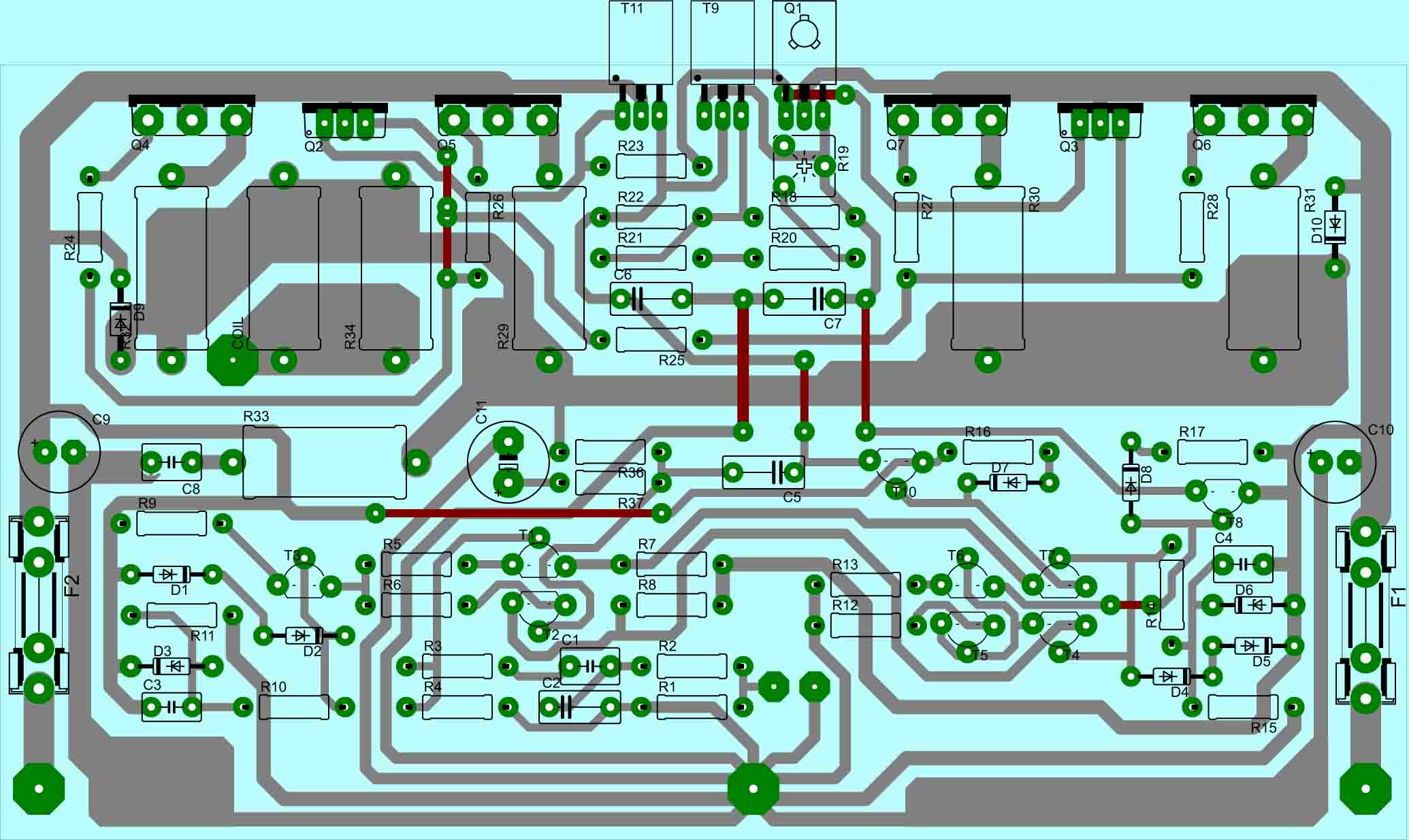

pcb for symef
Volunteer needed to do the pcb.
i have used different casing for the output transistor.goodluck to your amp.

Thanks for the PCB Joel,
You v done the Bias and the output network slightly differently.
I do hope you enjoy what you hear. Keep thread up to date with your progress. I am targeting at-least 30k builders. Then we will go world wide 🙂
i notice that also and read your note below the schematic.anyway it will be easy to edit sorry for that im just an enthusiast and not a designer and prone to mistakes.hope that you will post again the final schematic.

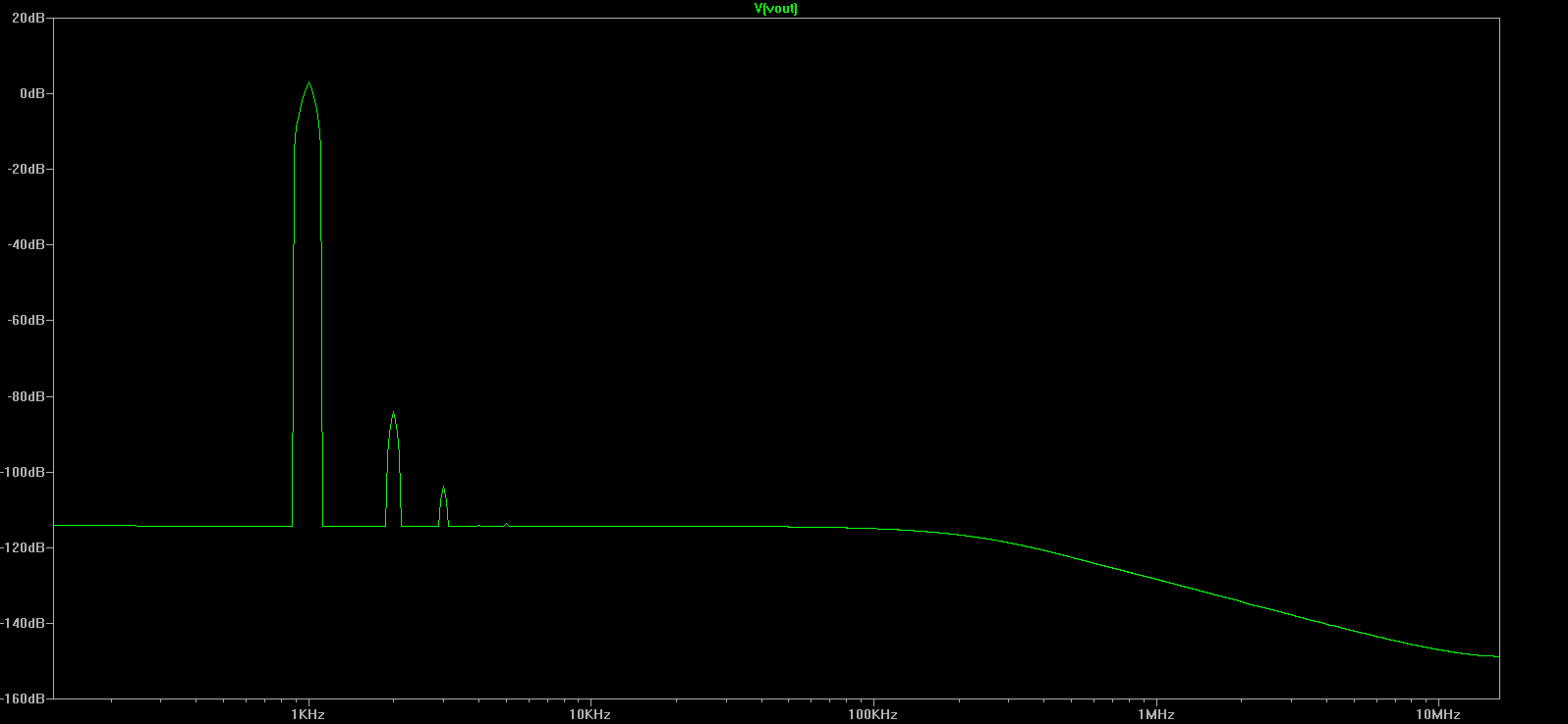

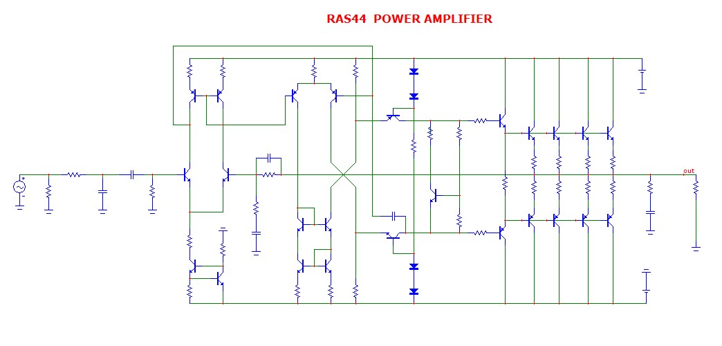

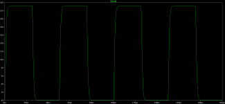

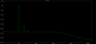

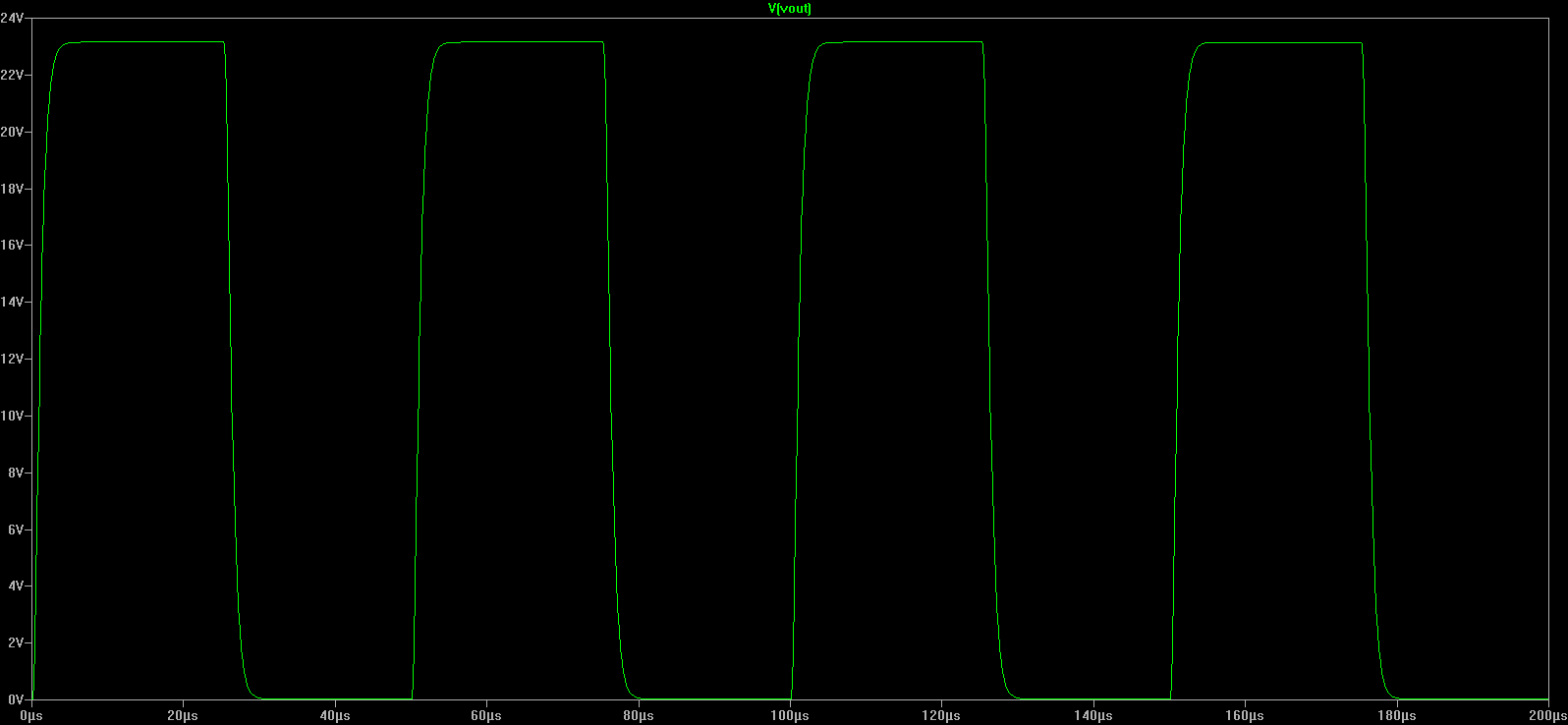

Hi Joel,
The amplifier in #20 has many hours of testing for all kinds of stuff. The ones in #28 and #32 should also be fine. Please find attached curves for #28.

There is something about the square wave curve that is a little confusing. How come it only swings positive. I also tend to agree with homemodder's comment about the harmonic content. Something does not quite gel. Also noise power density is almost a flat line.
