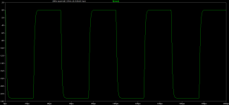

And its square wave response. However the front end filter cap I have changed to 220p instead of 470p

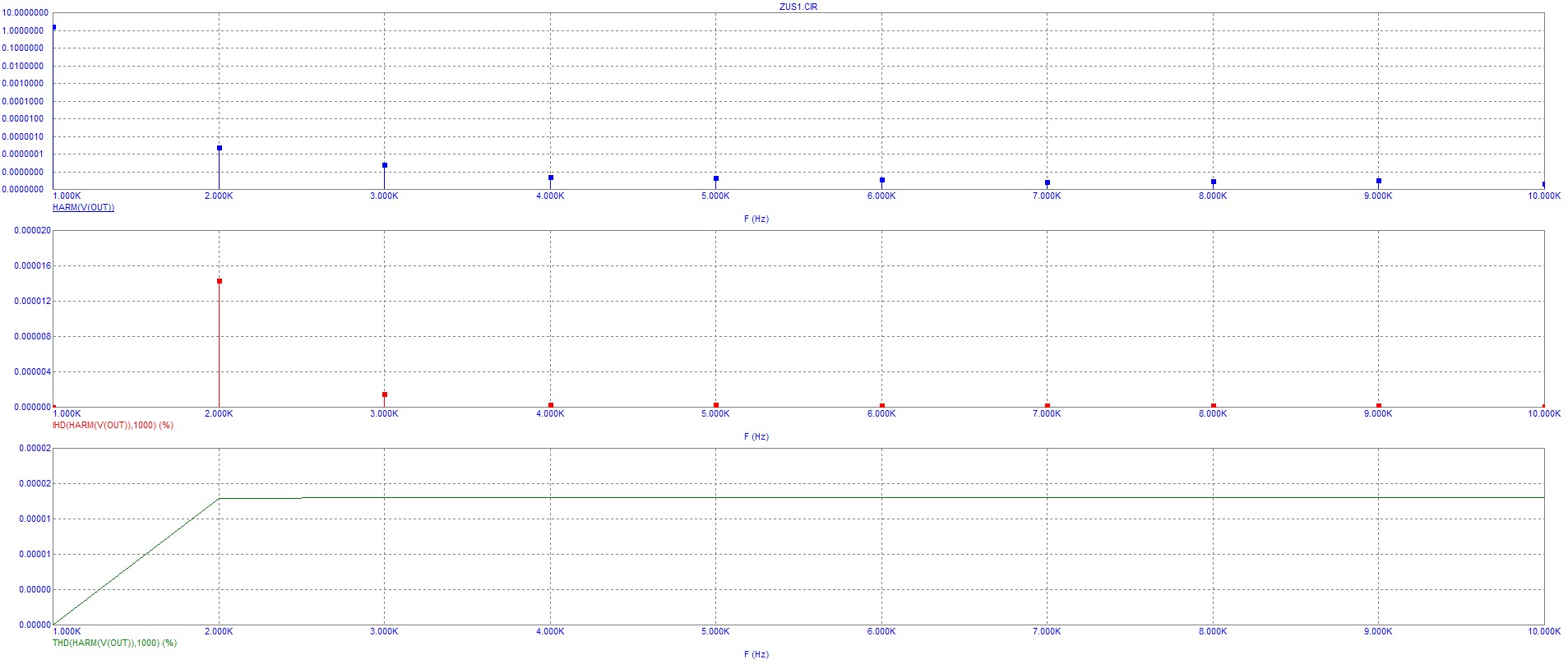

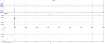

And the harmonic distribution, each harmonics contribution as % and THD as %. Of course these are all simulations. My amps are transparent subjectively speaking. Simulating with your front end configuration did change the harmonic distribution as well as THD marginally in the simulation but the ear would not detect it as it is virtually non existent.
I have listened again and again switching between the two configurations on headphones after I have adjusted each config to output the exact same amplitude. Now I must admit that I am convinced that in my first testing claiming a different sound that it was placebo. I can hear absolutely no difference at all.

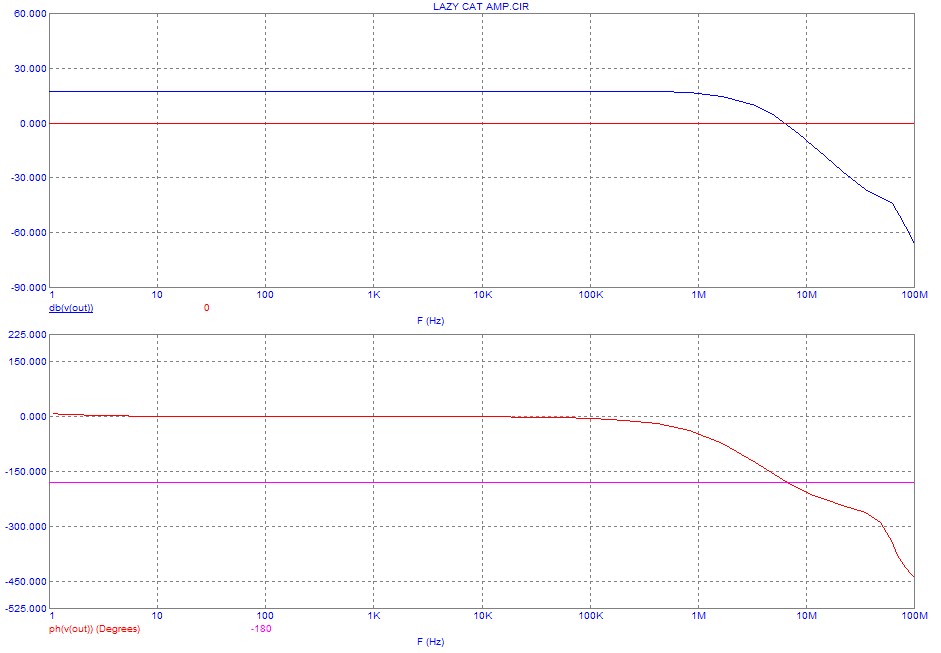

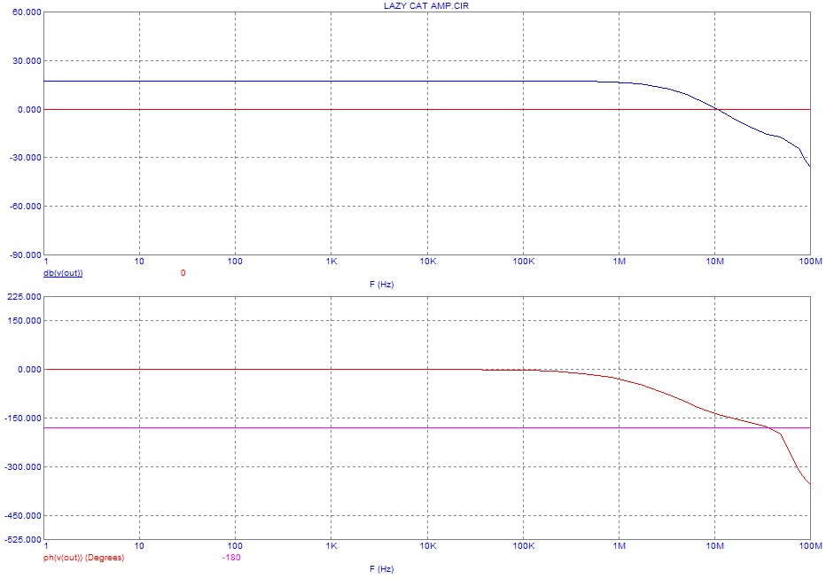

I have simulated the input circuit in my L-MOSFET version of Andrej's SSA (with input circuit & without input circuit) as well as listened intensely to any change of character of instruments, voices. etc.
The speakers I use are bookshelf size and incorporates the classic Scanspeak 2010 tweeter and Peerless 6.5 inch Aluminium cone woofer in a 27 litre enclosure and Andrej's SSA has been my choice for my office amp for the past 7 or 8 weeks.
I spend most of my time in my office (around 8 - 10 hours per day) and always have music playing so I am very familiar with this amp/speaker combination and have enjoyed it immensely since I built it.
I am not doing blind test because I have to physically switch the input by inserting the front end circuit or removing it, so time passes between listening and re-listening.
The THD curves are plotted on the same graph and the green markers is used to display the harmonics and THD with Onaudio's circuit in place and the red markers without the additional input conditioning.
Honestly, and as much as I would like to report otherwise, I cannot hear any difference at all.
