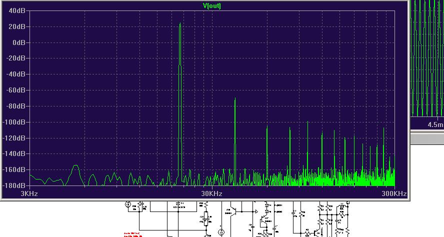

THD20 at 60W rms in 8ohm.

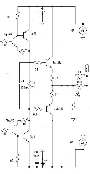

I have a question, will 10,000uf of rectifier capacitors and a pair of 2sc2922, 2sa1216 be satisfied for a +/-48V Symasym amp.
It's cascoding the input: I have cascoded the input with a pair of fets: 2sk30A and bc546 before I know the definition of cascode.
Going further, how do you cascode U5,u6( MjE15030,15031) on the power stage, I have seen it on a schematic of symasym but I don't know how to do it. Will I use a 5,6V zenner to source the cascode
You put C2==100pf with (r14=r29==22K) &&(r13==2K) How will my C2 be with (r14=R29==10K) &&(R13==500ohm)
You know, I have a lot of problems with my 2sc2922 amp, for this output is very tough to drive. It require lots of base current. I used the attached output stage. Pls tell me how to cascode this output. Still, the sonic of this amp is not quite OK. People said C2922 is a nice trans, but I found it tough.
The symasym version I made with 2sc5200 and 2sa1943 is OK without any modification.

re. amp sound
Hi Mike,
Yep, after making all the necessary modification, my amp is up an running. I think it is up to the capability now, it's sufficient at the moment, the amp provide enough power for my speaker an in turn my 50 m2 room. At higher volume it begin to distort but my ear hurts. That's enough. I like this version the most. C2922 is nice to me now, for its bass is so firm, and sweet treble. At full throttle, the amp get hot like hell, I've got to install a cooling fan for the outputs. My 10A rectifier get hot too, A 2w heat sink is applied there.
thanks for your precious help.

Hi Mike,
I've got a bunch of 2sa1837+ its 2sc from Digikey, can I use these device to replace TIP41/42?. I can see that in some C2922 linear application people are using as big as 65W device to drive 2sc2922. Mje1503x is desirous but not available.
I have one idea then, I will increase quiescent current for my tip 41/42 e.g 120 ma. Will it deliver better sonic. In my c2922 reference schematic, they apply quite high base current capacity to the output
That's the point why I try to reduce my amp global gain: I can not get high Hfe device.
The Toshiba's 2SA1837/2SC4793 are quite the best drivers, yes use them! (~3times higher hfe, ~23times faster)
http://www.toshiba.com/taec/components2/Datasheet_Sync//66/7632.pdf
Carlos (DestroyerX) used that combination, the Toshiba drivers with the Sanken outputs.
How should reducing global gain help with too low hfe devices? You only increase feedback and make the amp unstable. Try to keep original values / schematic.
Increasing bias will not really help with your hfe problem.
Mike
