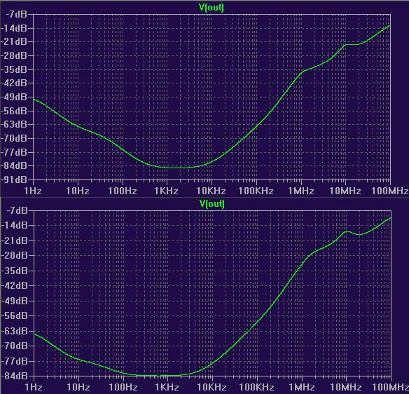

Hello Mike,
The PSRR figure is not quite good. Yes, it is over 80dB but only on a small part of audio spectrum.
The cascoded version is much better
Up figure, +PSRR symasym
Down figure, -PSRR symasym
