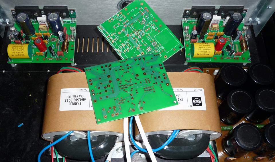

Hi Igreen,
I am building an AAK inspired board that I designed for use with 2SC2922 2SA1216 O/P pair. One R Core 2x25V 160 VA trannie and 6 x 6800 uF, 50V per Amp.
Testing to be done next week. When OK I could sell you the two spare boards.
Rick

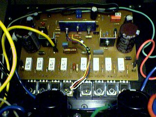

I can not deny the quality of the original symasym , but it was a tad small for my tastes. For rear channels , I might make a pair but with NJW0281/0302's.
If anyone is inclined to do the toner transfer , the 225W version's
artwork will soon be done. Schema is finalized and the first pair is driving paralleled 8 ohm loads with the greatest of ease. These beasts are running cool off of a 50-0-50 /1500VA trafo w/120k uF.
Same killer HF performance as the original , but better bass and
a lot more headroom.

Rick NL said:
Hi Igreen,
Rick
OK sounds good. What is your rough timeframe (weeks/ months?)
