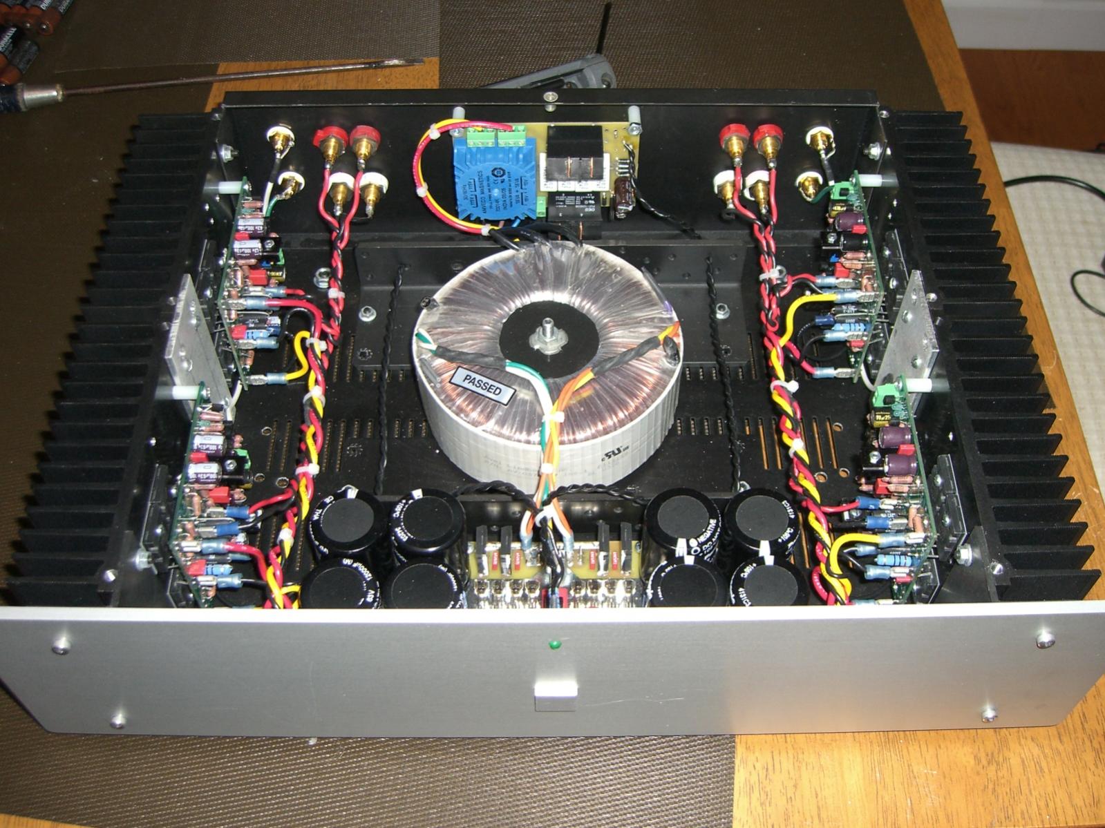

funny you should ask. I have just finished the casework.
Inside there's 4 amps - two Symasym 5.3 running off 30vac trafos, and two Symasym rev 1_3 running off 35vac trafos.
I have an active crossover and so the 1_3 boards drive the woofers and the 5.3 drive ribbon tweeters.
It's a great box in more ways than one. It won't fit in the cupboard. Some sorting is now necessary to house it.
The sound is off course superb 🙂
Many thanks for all your hard work AL. The next step is 4 way!
Aidan

Cool, we're both doing 4 ways. Nice enclosure.

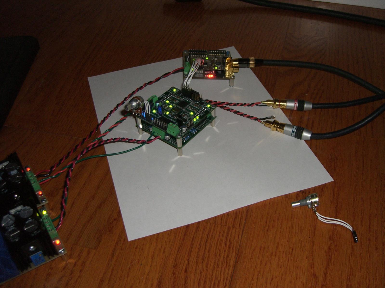

I'll be going digital instead of active for the crossover using a 2 x In, 4 x Out MiniDsp, and my ES9018 DAC that I just got running. I'll stack two amplifier boards below the DAC to get four channels. I've attached a pic of my 4-channel SymAsym Rev_1.4 amplifier with an external PS, and the DAC playing music for the first time. The ES9018 is an amazing sounding DAC. I plan on making it available sometime next month if you're interested.
Good luck, keep me posted, I'll do the same.
Best Regards,
Al

For quite a while I thought about a digital crossover, so I'm very interested in how you are using the dac. Are you using the one dac chip to convert all 8 channels?

Hi Aidan,
I'll configure the ES9018's 8 DACs to operate as four pairs to drive the four individual channels. Two I2S outputs from the MiniDsp will provide left and right channel low and high pass signal inputs into the ES9018.
Al
