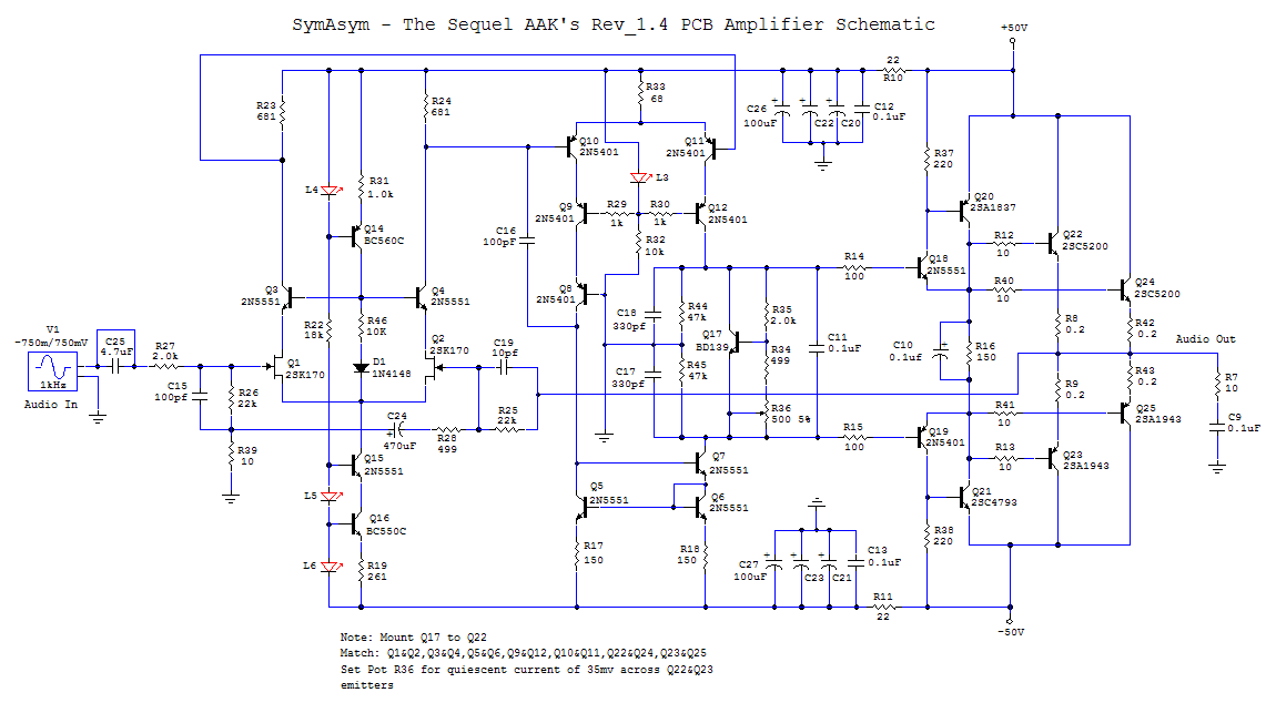

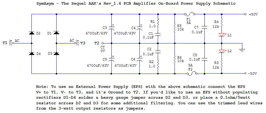

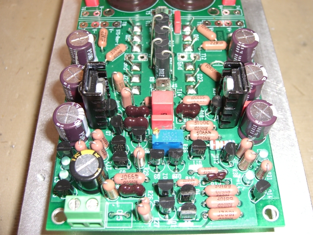

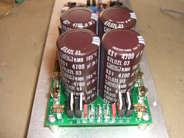

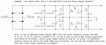

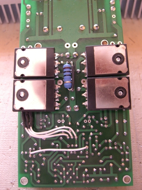

I've also attached the latest BOM, schematics for the amplifier and PS section and some pictures that should help with the assembly process.

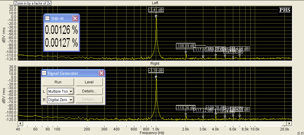

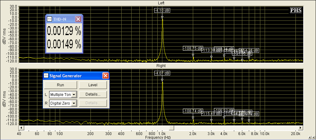

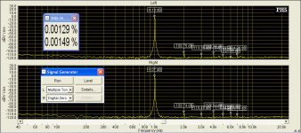

I've attached two real world THD plots of the amp driving an 8 ohm load at 100 watts, and a 4 ohm load at 180 watts at 1khz. In each pic the THD plot of the input signal is on top, and the amplifiers output THD on the bottom.

is bd139 important to the performance of the amplifier?
I would use any low current, medium gain, medium fT, To126 NPN for the Vbe multiplier.
I would even consider and have used a To92 glued to the output transistor or the heatsink.
R34=499r may be a bit high. You might have to reduce slightly to 390r, or 430r to allow output bias to be set.
I think the 35mV bias voltage is the sum across both emitter resistors, i.e. 17.5mVre.
R36 to it's maximum resistance for initial setting up.
This ensures least or nil output bias current.
The ratio of R35:R34 is ~4:1. I tend to use from 5:1 to 6:1 to ensure sufficient range of adjustability to suit a wide range of different transistor Vbe.
eg if Q17 has Vbe ~0.55V then the maximum bias voltage is ~2.75V
If the output transistors have Vbe ~0.65V then one needs ~2.65V to get a Vre=25mV. That leaves only 100mV spare for tolerances. But this is worst case design, not for a fully specified design. 499r should work, but will nearest E24 value of 510r work?

For the protection 100 ohm resistors 1/4 watt will do. I've attached a pic illustrating how to probe across each resistor. When I previewed the post the pic is a bit small, you can find a larger pic in post #24 of the following link.
