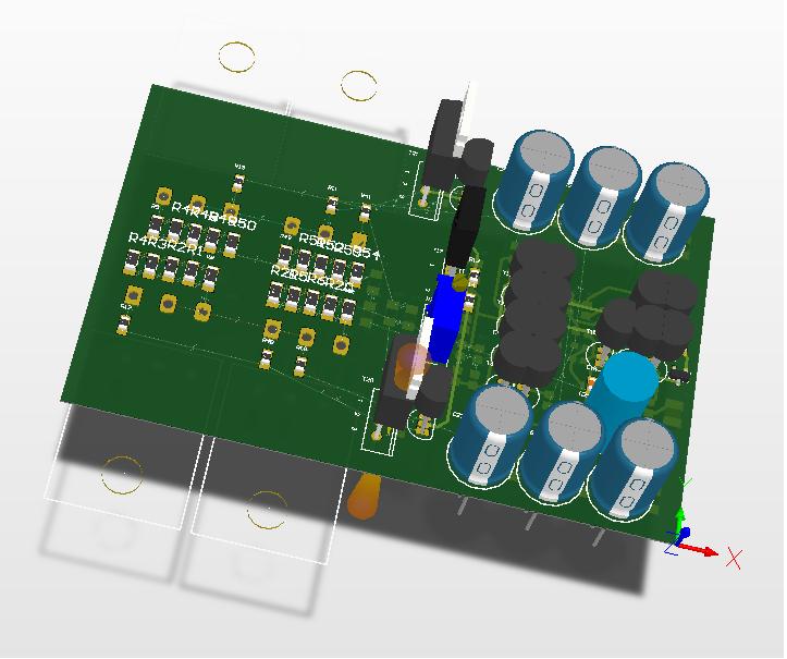

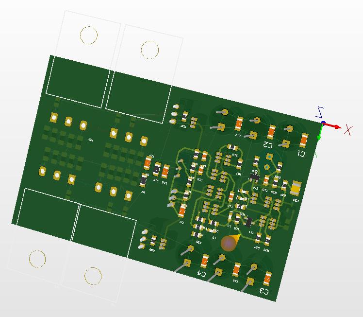

Power rating emitter resistors
Hi
I´ve started an PCB design with mostly SMD parts. -> attachement
Could anybody advise which minimum power rating the output transistor emitter resistors must have?
I also want to use SMD parts for that.
Thanks in advance
Stefan
I am inclined to the view that peak current survivability is more relevant to the emitter/source resistor.
If you are power testing the amplifier the resistor will have to pass a continuous half wave AC current. But that is an exceptional case that rarely if ever happens while reproducing music.
However, short term peak currents that are way in excess of the power testing current can pass through the emitter resistors.
Wirewound are very tolerant of this overload.
Metal and carbon film are not tolerant of this transient overload.
Many parallel connected smd resistors should have sufficient transient current capability. You either research previous works or do your own.
