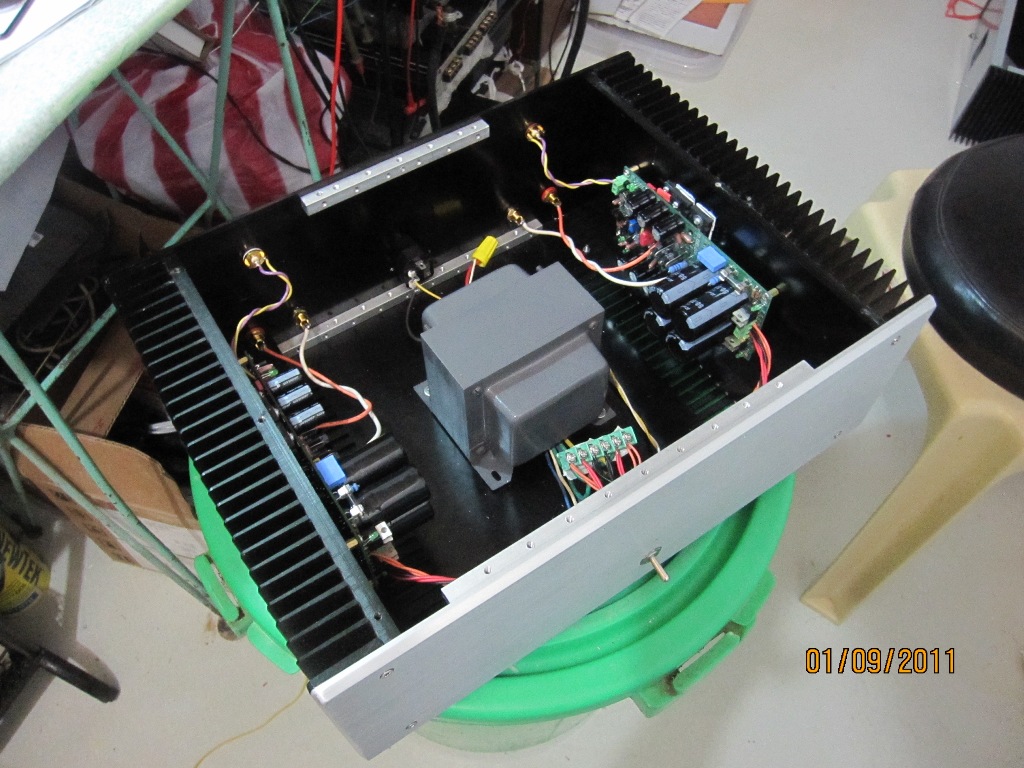

Hi Guys, I've just completed my SymAsym. I compared it to my Connex TA3020 amp and the symasym is better in all aspect.. i really like it alot..
thanks alot AAK..
regards
