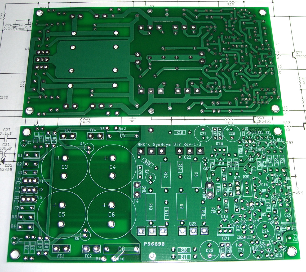

Hi All,
The boards arrived tonight, they look really really nice. I've attached a pic showing both sides of the board for you all to see.
I'll start getting the boards and parts ready for shipping this weekend; they should start going out Monday or Tuesday of next week.
I'll also start building a pair of the new boards this weekend while documenting the entire building process to make it easier for everybody to build and test their own boards.

Update.
Hi All,
76 boards went out yesterday 13, Jan. except for a couple members that had special request. With everybody included that's 82 boards in all split up between 27 members. Should make for some good times ahead.
For my international friends, you should of received and email with tracking information. For my friends in the states the boards should arrive either Friday, or Monday. Notify me if the boards do not arrive by Tuesday.
I built and tested a pair of the new boards over the weekend. I've been listening to them since Sunday night and I'm very pleased. They sound beautiful! Of course as promised I took pictures at every stage of the assembly process.

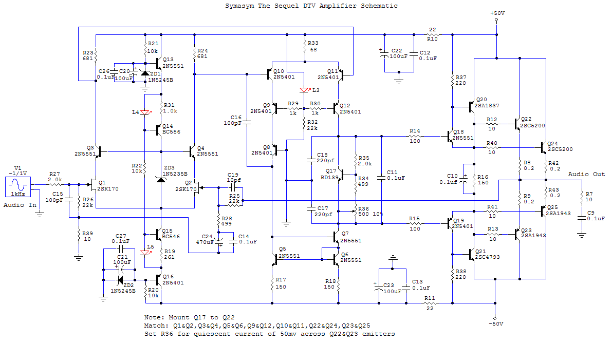

I've attached a new BOM and schematic since I'm here.
To the BOM I added a new part number for C7&C8 since it’s out of stock at Mouser. I also changed R32 to 22k to match the schematic. For those that already purchased a 10k for R22, it’s Ok, L3 will shine a little brighter but it should be fine.
