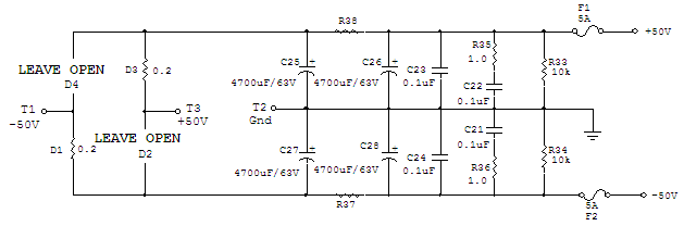

To answer your questions.
1.I see little reason to keep 2 diodes in circuit
Don't populate D2 and D4 as shown in the PS schematic below.
2. there should be some decoupling capacitors although Ii think 4x4700 is huge overkill. It may be my suggested 2 x 1500ufd might not be enough.
If your external PS has plenty of reservoir capacitance, rule of thumb being 1000uF for every 10 watts of amplifier output power, then your choice of 2x1500uF is fine.
3. 0R2 resistors as input to decoupling caps would also aid in decoupling. so I would leave these in.
Just make sure the 0.2 resistor is rated for at least 3 watts.
Al
Here's the schematic.

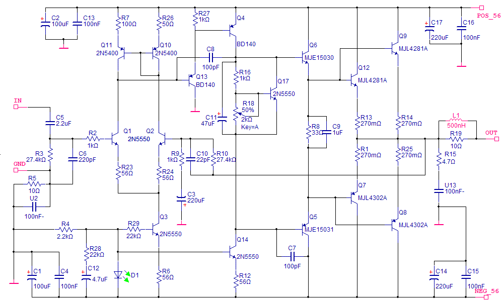

MJL21193 said:
It has some similarity to the symasym. Here it is:
:clown: yes, it's also a ClassAB amp!
But, you can not use 2n5550 for q14, it will overheat. BD140 for q4 is also not suitable, BD140 has max rating of 80v.
Without vas-protection, q13 will blow on excessive positive clipping...
You should consider basestoppers to the drivers, what is c7 for?
R2 should be directly behind c5, otherwise your input filter operation depends on output impedance of signal source.
Q3 will also overheat, so will Q1/2, are you sure you want to feed ~40ma into the input diffamp?
Why are r7/26 different?
Mike
MikeB,
Thanks for your advise. Is there anything wrong with my power supply? 37ac-0-37ac ==>rectifier==> +50V/-50V
which one will sound nicer? Silver mica or Polyproplene?
My batch of MPSA42 only have hfe of 100. Is that good enough? While my MPSA18 have hfe of 700. Which one will sound nicer in your opinion? I wouldn't mind to lower the power supply if it helps. 🙂
All the the pair transistor are hfe match but vbe is unmatch.
