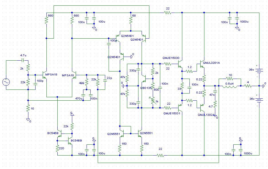

For the moment, I live in the fantasy world of simulation. Board layout can make a big difference I know, the simulator doesn't hold that against the circuit though.
I modelled the amp exactly according to Mike's schematic (pic below) and found the square wave broke down below ~4K.
Has there been component changes from the schematic I followed?
Thanks.
the 22pF on the NFB line has been reduced to <=10pF. The value seems to be critical to stabilising different output devices. Be prepared to use values as low as 2.2pF.
The 330pF loads to ground for the VAS have different values in some schematics, (or 220pF). These may need a bit of trimming.

Guys,
May I know how to determine optimum value for C2?
C2=100pF, -3dB=796kHz
C2=33pF, -3dB=2.4MHz
Both have cut-off freq way beyond 22kHz. Pls advice.

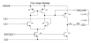

Off topic question : (see attachement)
Why in audio, only a single miller capacitor is use for compensation, while in IC design RC is use most of the time?
Thanks.

Please keep it 100pf, as input filter it serves to keep hf out, additionally it helps stabilizing, reducing impedance to q1 at high frequencies.
Mike

2k0 and 100pF have an RC time constant of 0.2uS. This is below the normally recommended range of 0.5uS to 1.5uS. Some designers/builders do go as low as 0.3uS and Mike has gone lower still.
Most listeners will hear the effect of 1.5uS cutting off some of the treble. Some will prefer it this way.
Some will hear 1uS removing a little of the sparkle.
Most will not hear the effect of 0.5uS low pass filter on the input.
The other consideration is how effective the RF attenuation is.
As the low pass filter goes up in frequency so the attenuation drops, low uS time constant=low attenuation of RF.
It is a compromise between RF attenuation and passing all/most of the audio signal.
BTW,
33pF gives 0.07uS with a 2k0 series resistor. In my opinion this is too low.
Hi MikeB and AndrewT,
If I use R13=6K, then I would be able to maintain 0.2uS. Will there be any problem? I just want to save some $ as I have quite a lot of 33pF silvered mica.
As for C7, I will use 3 X 33pF in parallel. Is that OK?

Ipanema said:Hi MikeB and AndrewT,
Thanks.
Please, don't change ANY of these caps... If you have so many, also use 3 parallel for c2.
Mike

Guys,
Found the problem yesterday. I got a reverse collector and emitter because I swap BC546 with MPSA42. 😀
With 33pF at C2 and C7, it shows a very small amplitude ~MHz region ripple at my scope when I tested it with 70kHz square wave. Increasing C7 to 66pF completely remove those ripple. The output is not connected to any load, except the scope. I'll have a listening test tonight with 33pF, 66pF, 99pF and 132pF.
Can you show me how can I test the stability of an amp? Do I need to connect to an actual load to test for amp stability?
What should the correct out biasing for this amp? I saw somewhere that it is 57mA. I don't have a distortion analyser to do the test. I'm using MJE1534/5 driver and MJL1302/3281 output.
MikeB,
Can you help to explain why 2K*100pF cannot be substituted with 6K*33pF for the RF LP filter?

Re: Symm is working
They are not equivalent and will affect the performance of the amplifier.
It is generally safe to lower the source impedance seen by the input, but raising that source impedance may not be safe. But, I did say generally, so don't take it as an absolute rule.
If you were to propose reducing the series R and making the C larger (1k0 & 220pF) to bring back the RC time constant, then you may be OK.
