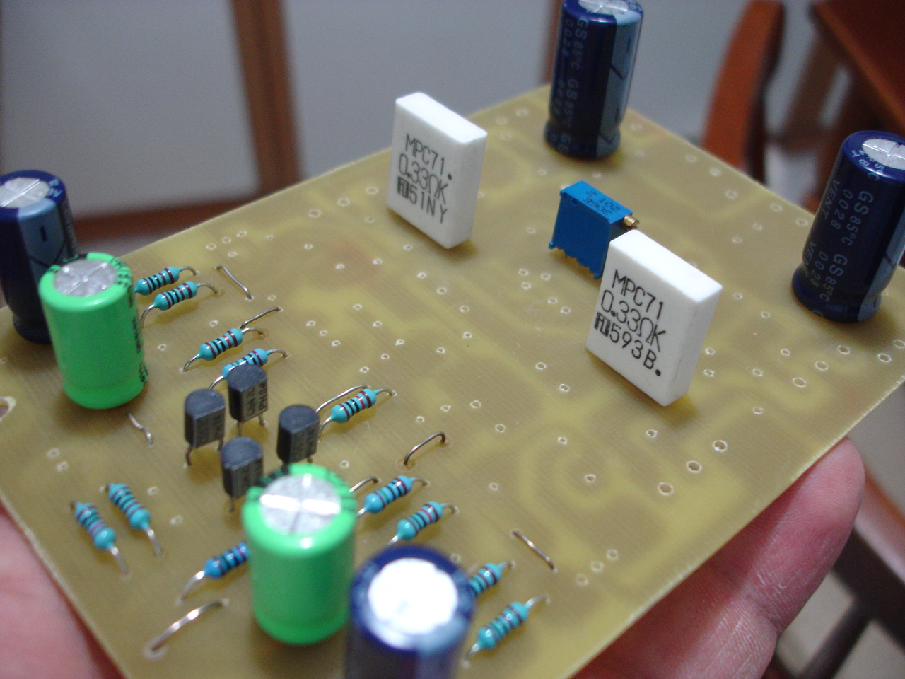

I now have the second power supply ready and everything will sit in a nice chassis when all tests have been done.
Ciao!
Do
Beautiful!!!! That's the way I like to see them. You usually can't see much once it's in the case. Thanks for the great picture!

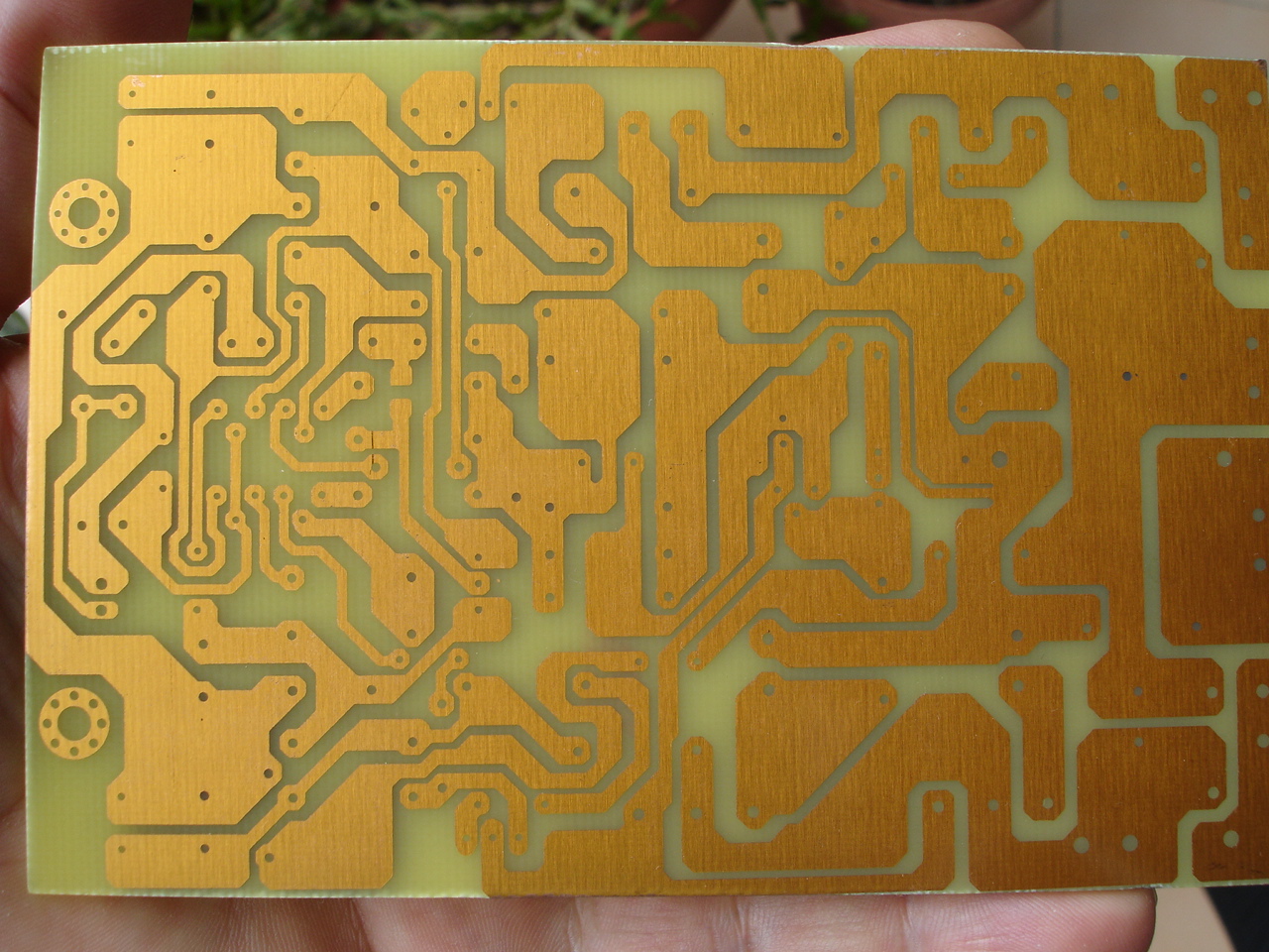

Nice PCB! What process did you use?
Do
The photographic method of course.
I can explain this more if anyone interesting about this.

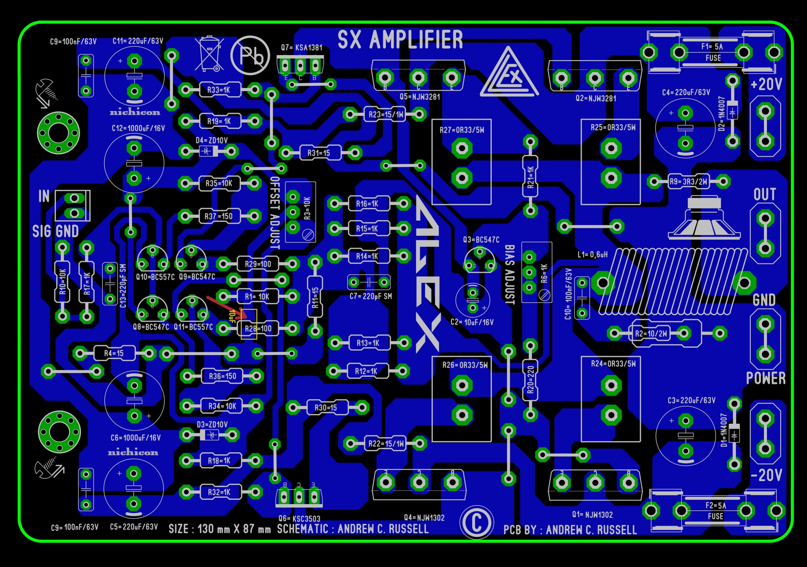

..... sorry ,I forget to mark silk screen on bottom (yellow ) C1=10uF/50V Please solder this SMD capacitor bottom side. Question ,will be problem if rail voltage it's +/-24V ?
Regards,Alex
Regards,Alex
