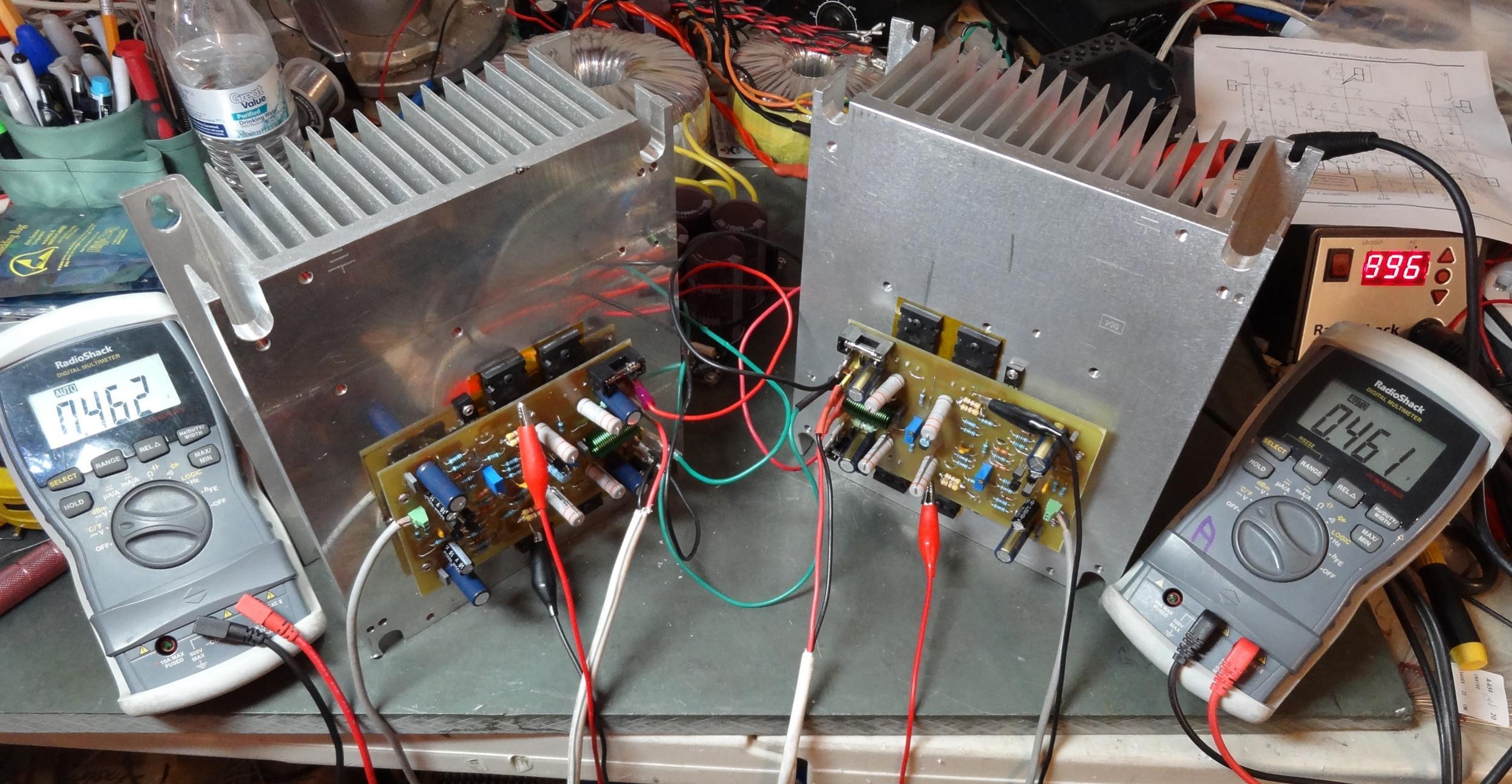

I got it! It is playing lovely music.
I settled on a 2K trimmer and 1k1 for R20. A 1K pot would be maxed out and still maybe a little high. I'm not sure how you got away with the values you used. Maybe my 0R33 resistors measure different than yours. It is very difficult to get an accurate measurement of such low value resistors.
I've only had it playing for about 30 minutes so I can't tell how hot it will get but so far no problems. I'm using a 12-0-12vac transformer and getting about +-17Vdc rails. I've only listened to jazz so far but it is very clear and full. Good solid bass and clear highs. It sounds just as it should. Thanks for sticking with me and helping me get this working. It was worth it.
Blessings, Terry

I've been listening to it all day. Beautiful. I have this huge 12-0, 12-0, 12-0, 12-0 1200VA transformer that I bought for the Aleph-X a few years ago. I've been looking for something good to use it on and I think this is it. It is giving me +-16.5V at full draw. I'm splitting the 4 outputs into two separate bridges feeding 4x22,000uF CRC filters. It is staying in Class A almost all the way to unity gain.
I recommend it!
