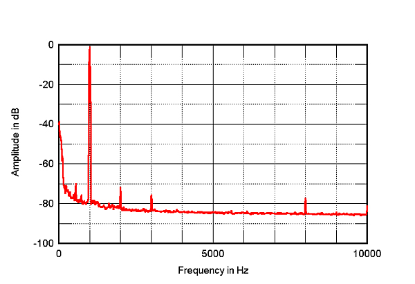

[BTW --- what can be heard depends on at least the speaker distortion characteristics. I use the Quads sometimes. You need distortion well under these to be unknowable...... until -80 or .01%]
Quad speaker via Stereophile magazine tests
THx-RNMarsh
Richard,
I guess that distortion plot was done at 1 watt output. In which case the resistor self heating would also be concomitantly lower.
The quads are remarkably low distortion but like most speakers, when you push them, distortion rises very quickly (the Quads perhaps a little less so than more conventional ones).
A agree with your comment about dynamic range. I use my sx-Amp with my B&W 703's (89 dB/W) and can get good volume out of them. But, ideally this amp should be paired with higher sensitivity speakers - eg 96 dB/W
I have those newer Quads and the distortion remains pretty low to fairly moderate levels..... But the point was that >.5% is not be the standard any more. I put them in when I want to hear the finest of details and resolution.

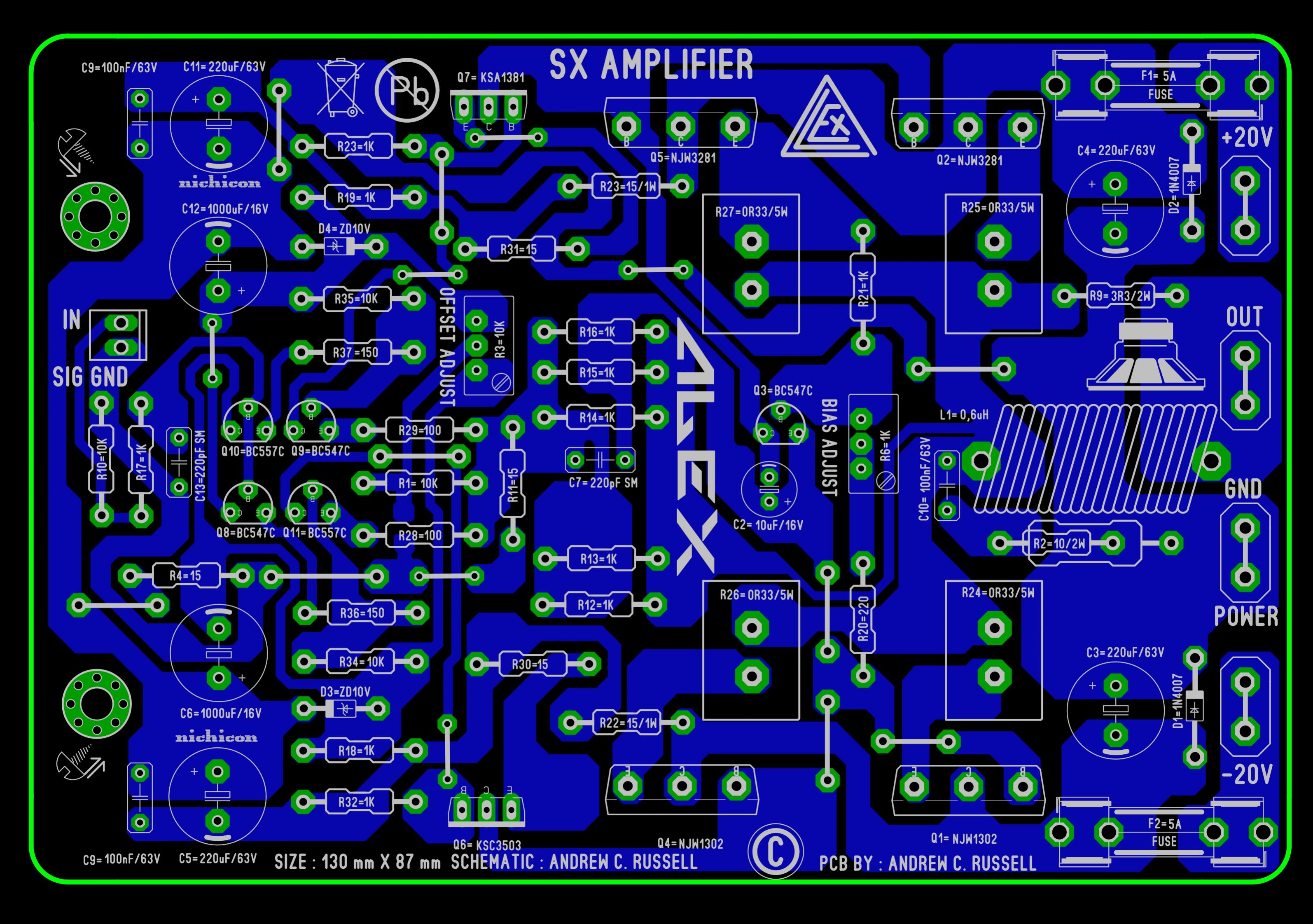

PCB rev.....
Maybe some guys ,want to make PCB and I hope I can help a little ......😉
Regards,Alex
Regards,Alex
That's fantastic Alex - thanks for doing this. I will also upload onto my website this weekend.
Maybe you want to do a board for the nx-Amp single sided with same tranny and mounting hole locations? 😀. Sure would be welcomed by the guys that want to etch their own and/or want to try the nx in single sided format with the sx single sided layout.

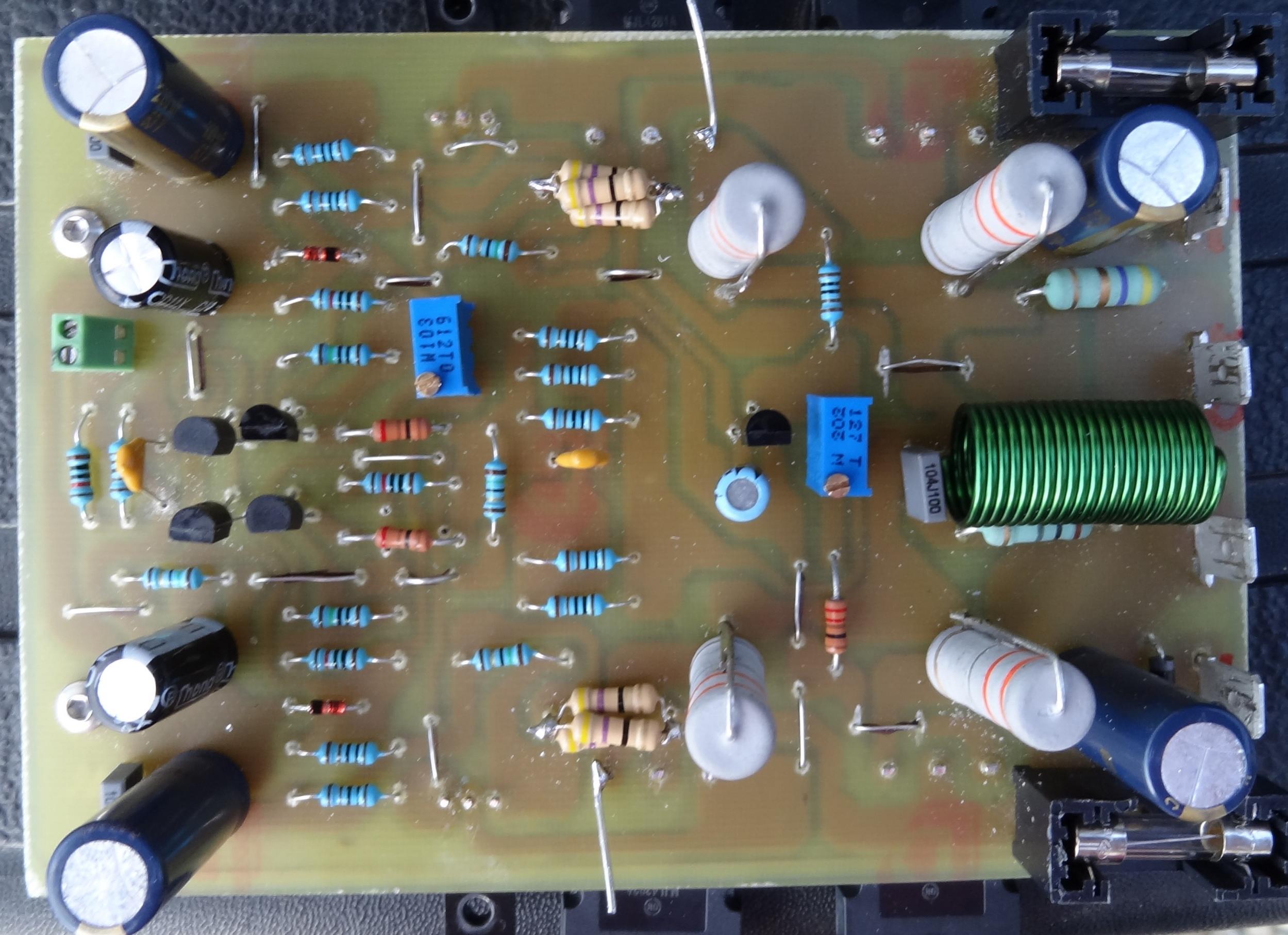

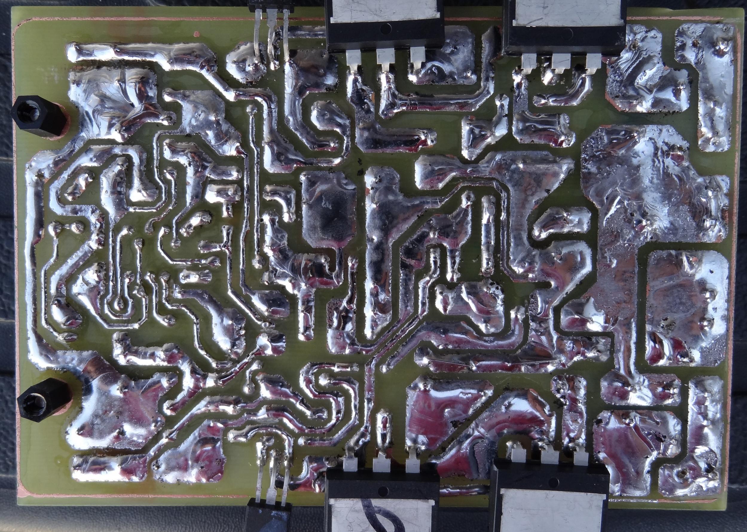

I etched some boards for the sx based on the files that Alex attached in post #971
I am having some issues. I used the values on the screen print except for using MJL4281/4302 for the outputs and 2SA130-Y/2SA3423-Y for the drivers since I had them in the same grade. Also the screen print calls for a BC547C in the vbe so that is what I used.

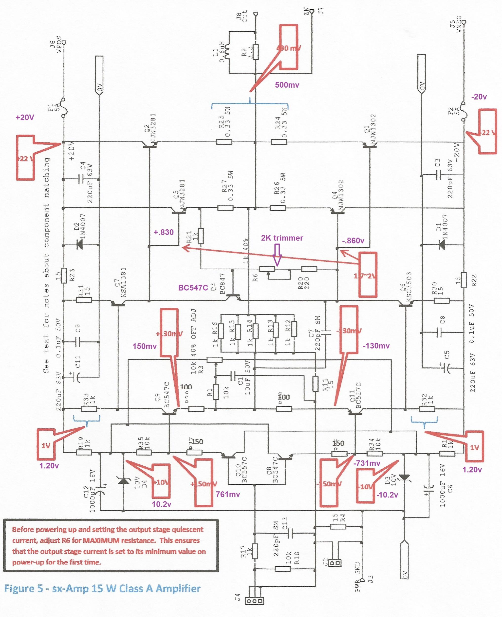

First off, I had to put in a 2K trimmer just to get the bias down to 500mv across the pair of .33R resistors and that is with the pot set for 2K. I am attaching a schematic with the voltages Andrew said to expect and a in purple what I am getting. Any help will be appreciated.
Thanks, Terry
Terry,
Wow - that was a fast build!
The voltages you are showing around the schematic are within range - the 0.5V across the degen resistors gives you a shade over 1.5A total Iq - its ok.
For your bias adjustment, I suggest you leave it at 1 k and instead raise R20 (currently 220 Ohms) to 1 k or 1.2k.
I have to admit I did not set the pot to the mid position to see what the out Iq was - I would need to open up and measure.
The current across R32 and R33 is a bit higher than the 1V I show - the 100 Ohms Q9 and Q11 emitter degen resistors can be raised to 110 or 120 Ohms BUT I would just leave them as is and only change R20 as described above.
Make sure the output devices and the VAS transistors are well heatsinked - this amplifier runs hot - with 20-22V rails the standing dissipation is in the order of 60W. You need 0.4W/C worst case - 0.3W/C is what I recommend.
Look forward to your feedback on the sound.
