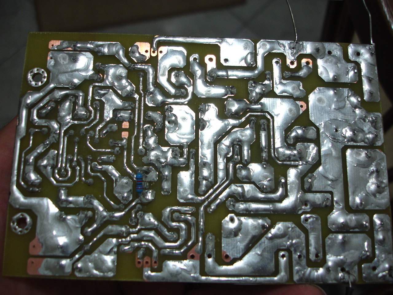

just before......fire!
Poor man's sx-amplifier,or sx-ampl.with what i have😱
i will never use lead free solder again🙁

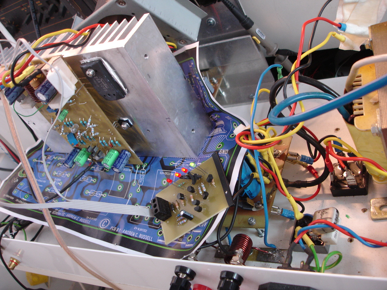

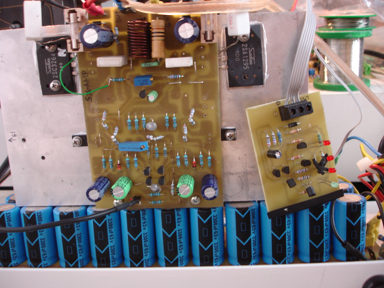

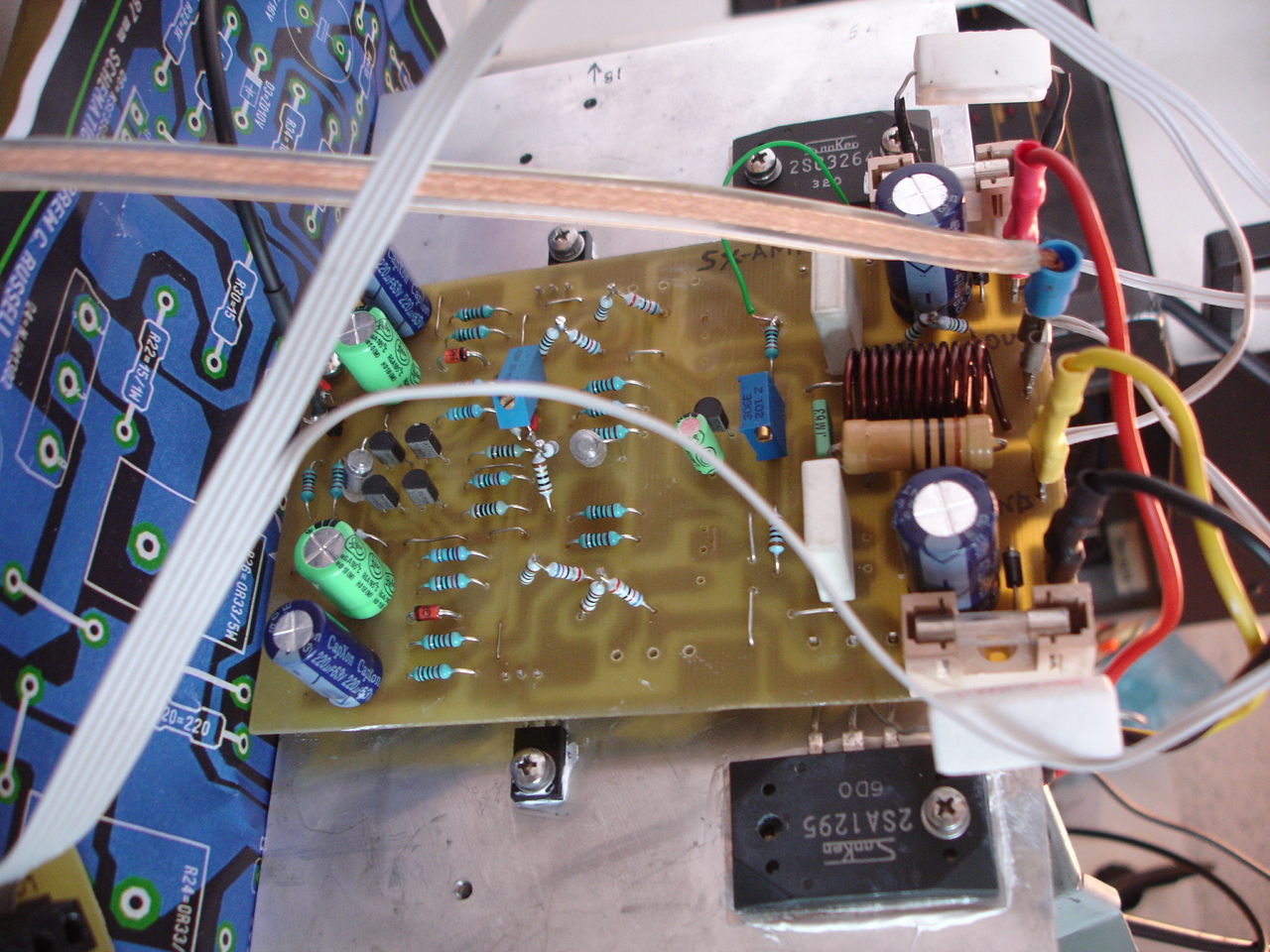

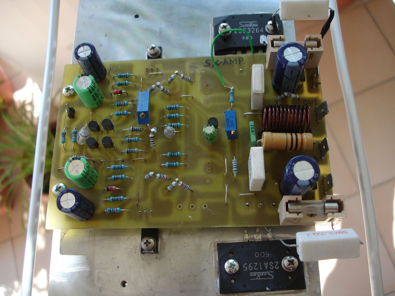

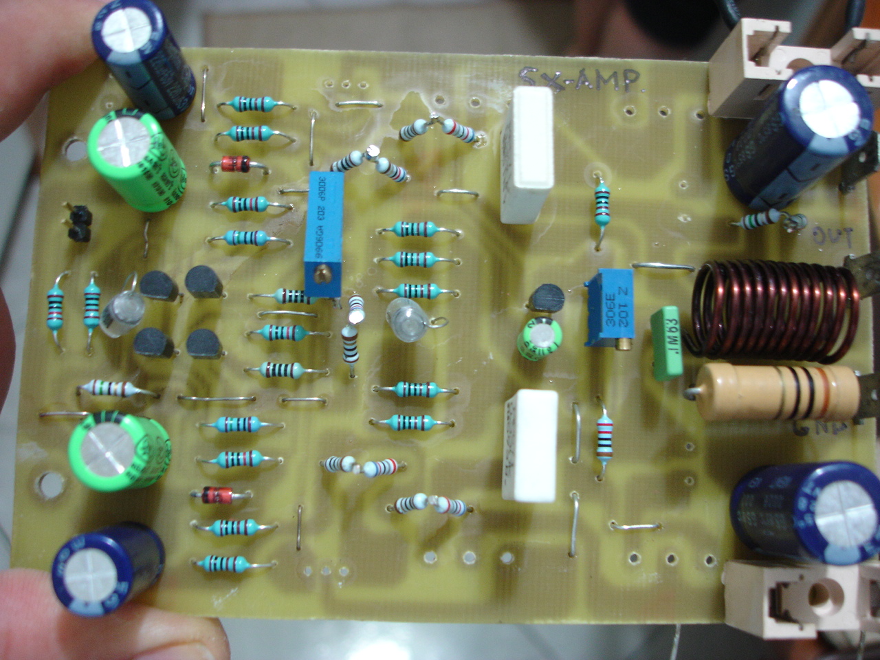

Here is the completed channel.

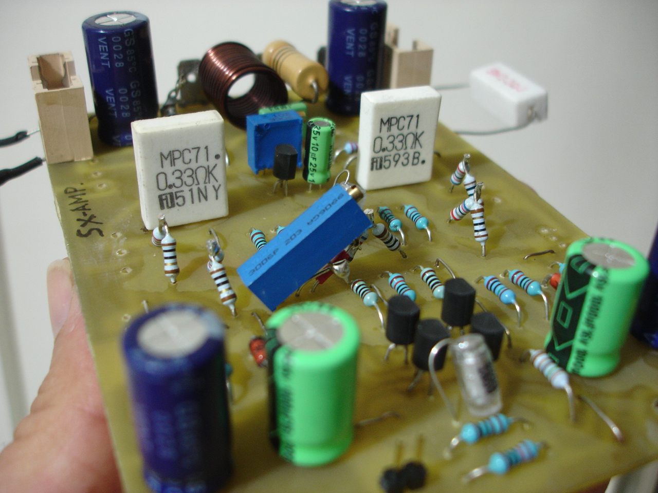

Thanks Bonsai ,i believe a small modification at the bias circuit is necessary .Very nice! I like the Sankens! They will work fine in this circuit.
It can't go down from 660mV from one emitter to other emitter(output transistors).
PS just now i see that the recommended current is 1.5A

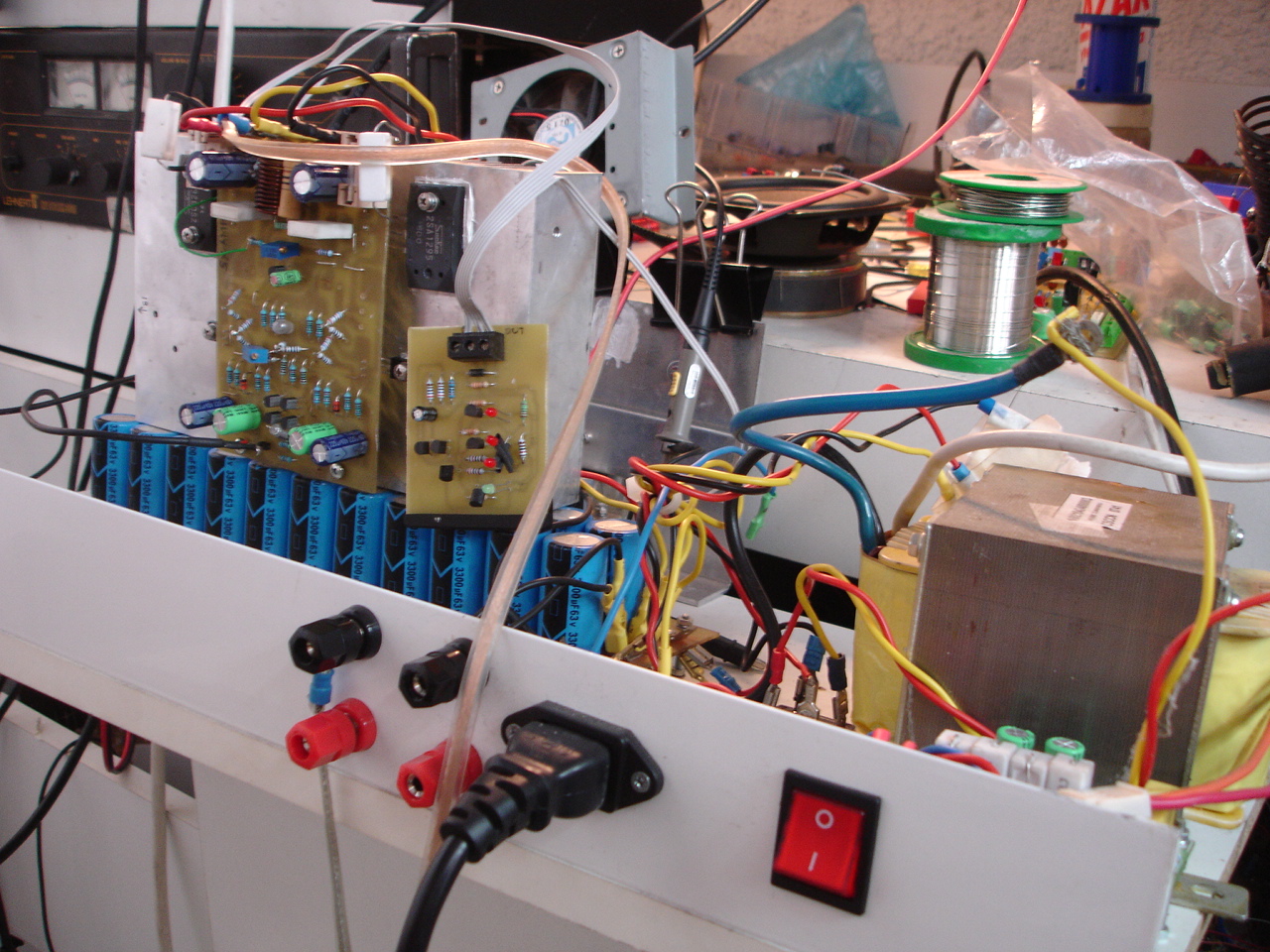

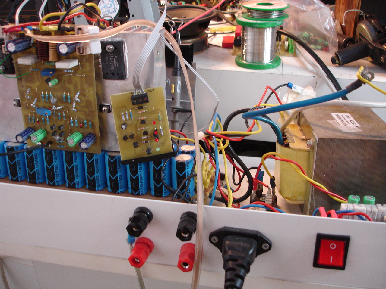

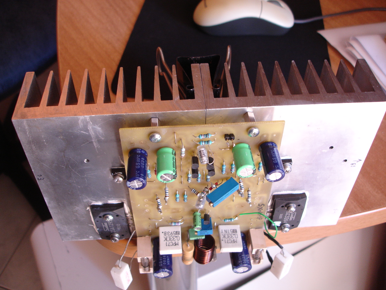

Today is a listening test day.
Power supply: +/-20V D.C
33000UF/Rail
EI transformer
Biased at 1.5A
One pair OUT.
Offset=0 mV absolutely stable.
From this first test it is clear,this is a very good sounding amplifier,deep bass,clear high .

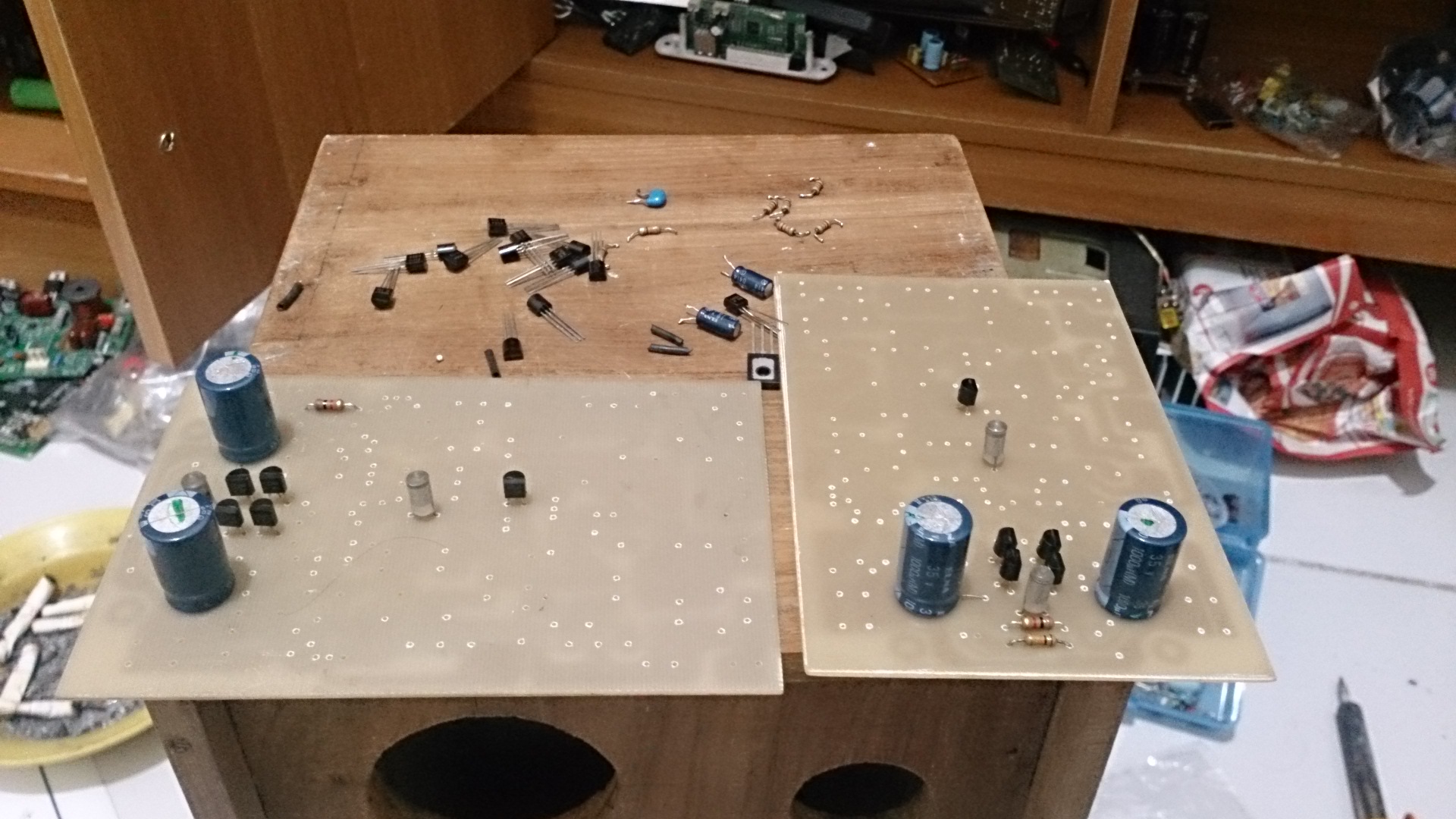

Good luck!🙂my first move. the poor boy sx boards

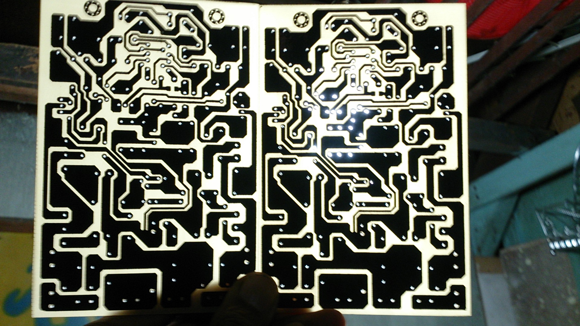

Here is the single sided sx-Amp (15 Watt Class A CFA) PCB layout in Gerber format I promised a few days ago.
I have not built this version (only the THP version)
So, please feel free to take a look.
The circuit is the same as for the one in the write-up on my website except that I have replaced C2 with a through hole electrolytic device and J2 is removed. Further, all the semiconductors are now through hole.
NOTE: THIS LAYOUT INCORPORATES THE UPDATED RESISTOR VALUES FOR R28, R29 AND R36 AND R37.
I don't know how to turn this into a .pdf file - anyone got any ideas? This will mean people can etch their own boards.
