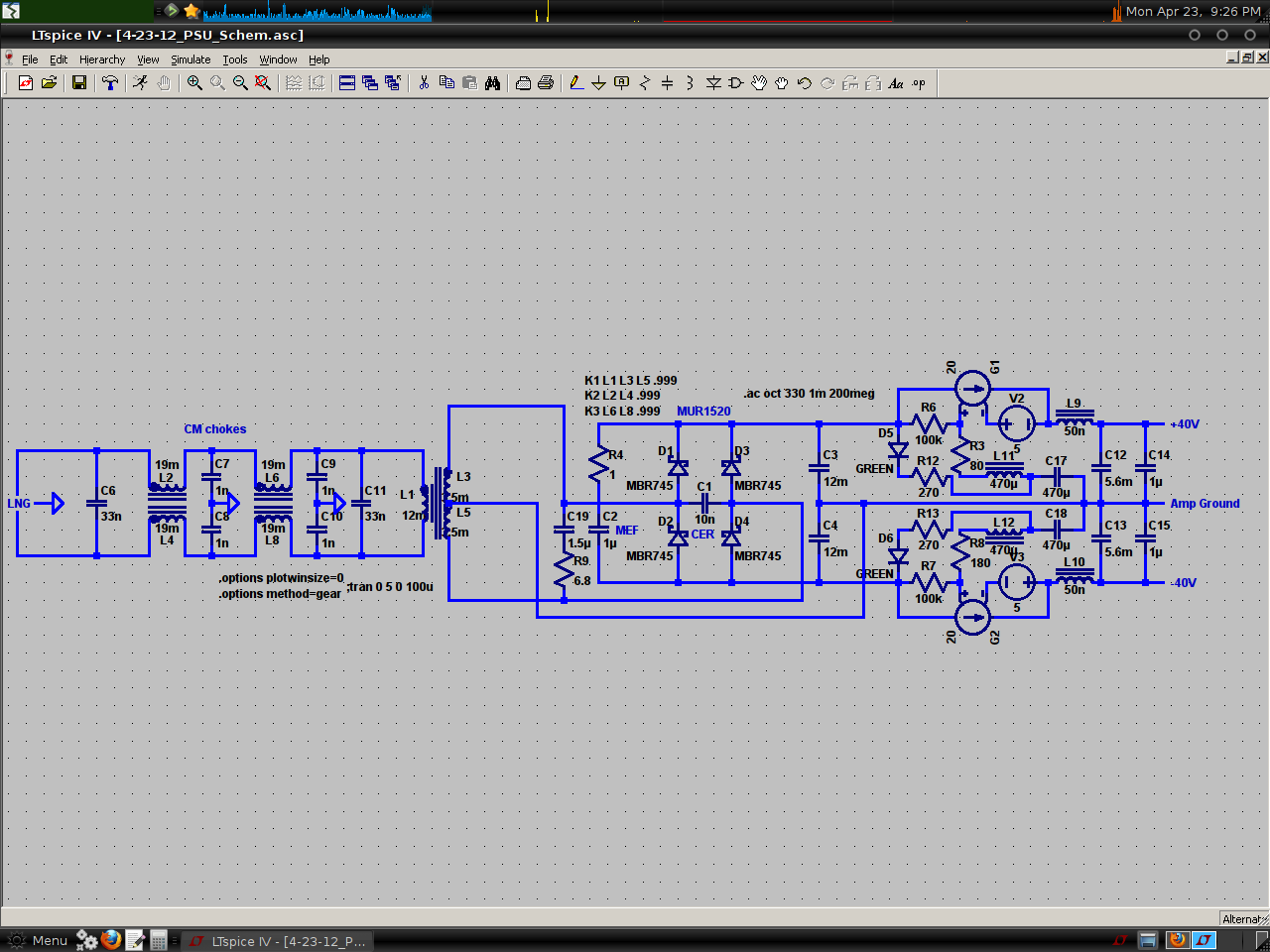

Here is my PSU so far. The 1.5u+7R RC at the rectifier was arrived at though real-life testing. For suppresion of the 500KHz resonance, a 220u+47R network could be added, but the cap and resistor might promptly explode, too bad. However, even partial suppression of the 500KHz resonance may prove more important, so I may end up increasing the 7R resistor.

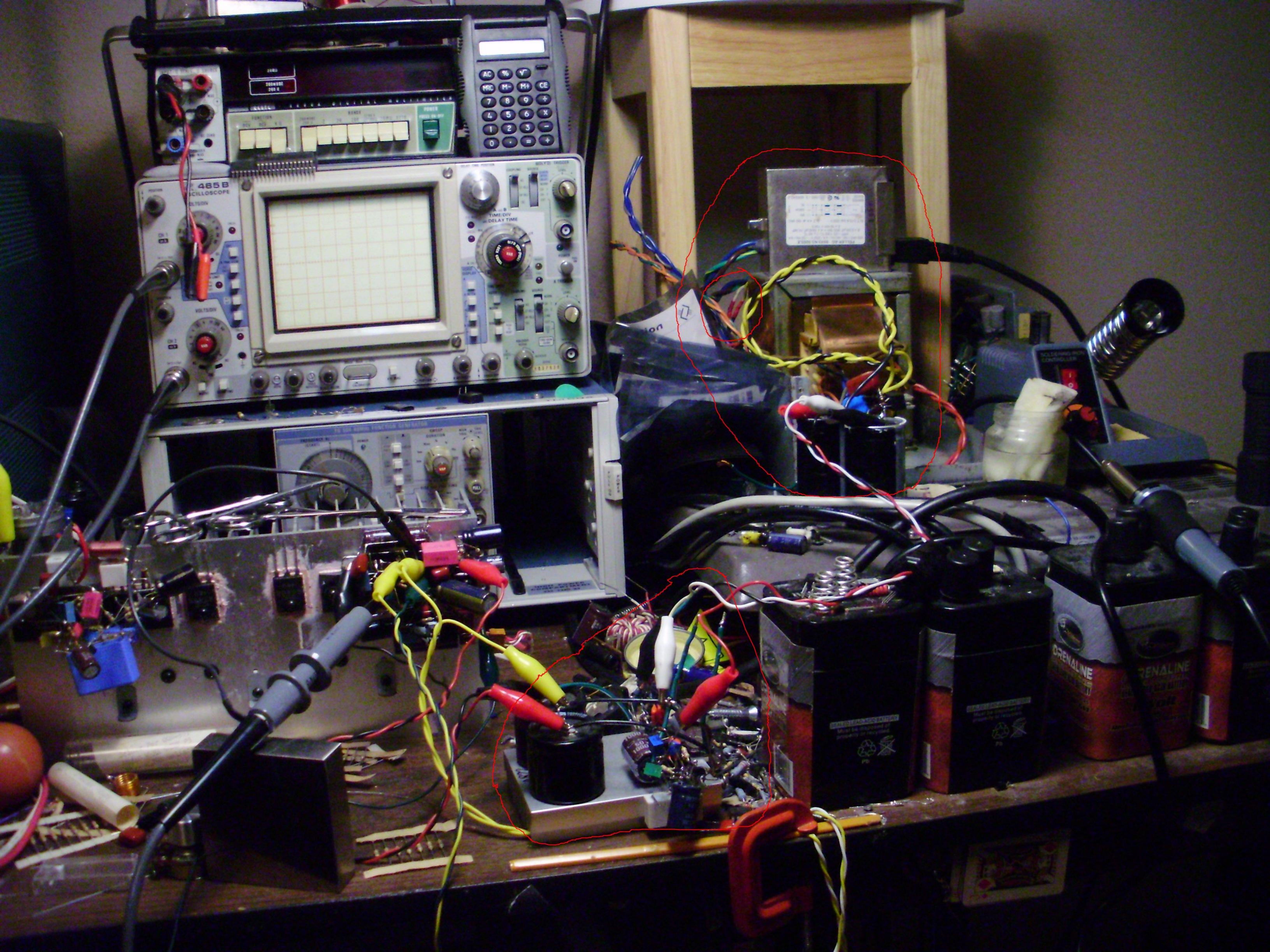

No visible ringing on either scopes. The linear filter is a pretty beefy Feller AG, but one of those files posted earlier shows a nice line filter that I should perhaps emulate.
What do you guys think? This is my bench supply, the Fetzilla isn't what's on right now, but, you know, hypothetically... Those convolutions near the end are my high-current Kmultipliers.
Yes, that is a Tektronix FG504 signal generator... A very generous friend helped me acquire it.
If R9 is too low, the 500KHz resonance turns into a 5KHz resonance! I found a good middle value was 25R. Turns out a huge cap is not needed for 500KHz suppression, it was a testing mistake. If I increased C19 to 4.7u, maybe I could score both birds, but that would be a big cap...
I found that I needed a C & R across each secondary to keep the earth clean.
I have successfully used 4.7uF + R but I always used 0.1uF as well.
the 0.1uF reduces the the frequency and provides some added filtration. ( Reducing the frequency is good - most regulators and caps etc work well in the 1k - 5k band, 500khz is more challenging )
the C + R damp this lower resonance.
your ears should confirm this mod
The 100nF cap may not reduce the winding resonant frequency, it may just give the windings and open circuit to resonate into. I would put a small resistor in series, 1-10R. This could be a trimmer, as there are resonances above 1MHz that could be rather conveniently damped here. I do have a 10nF there though, maybe I will mess with it.
Many people like to have as little ESR as possible, but I keep finding myself wanting to add series R to keep the caps from resonating with each other and various things.

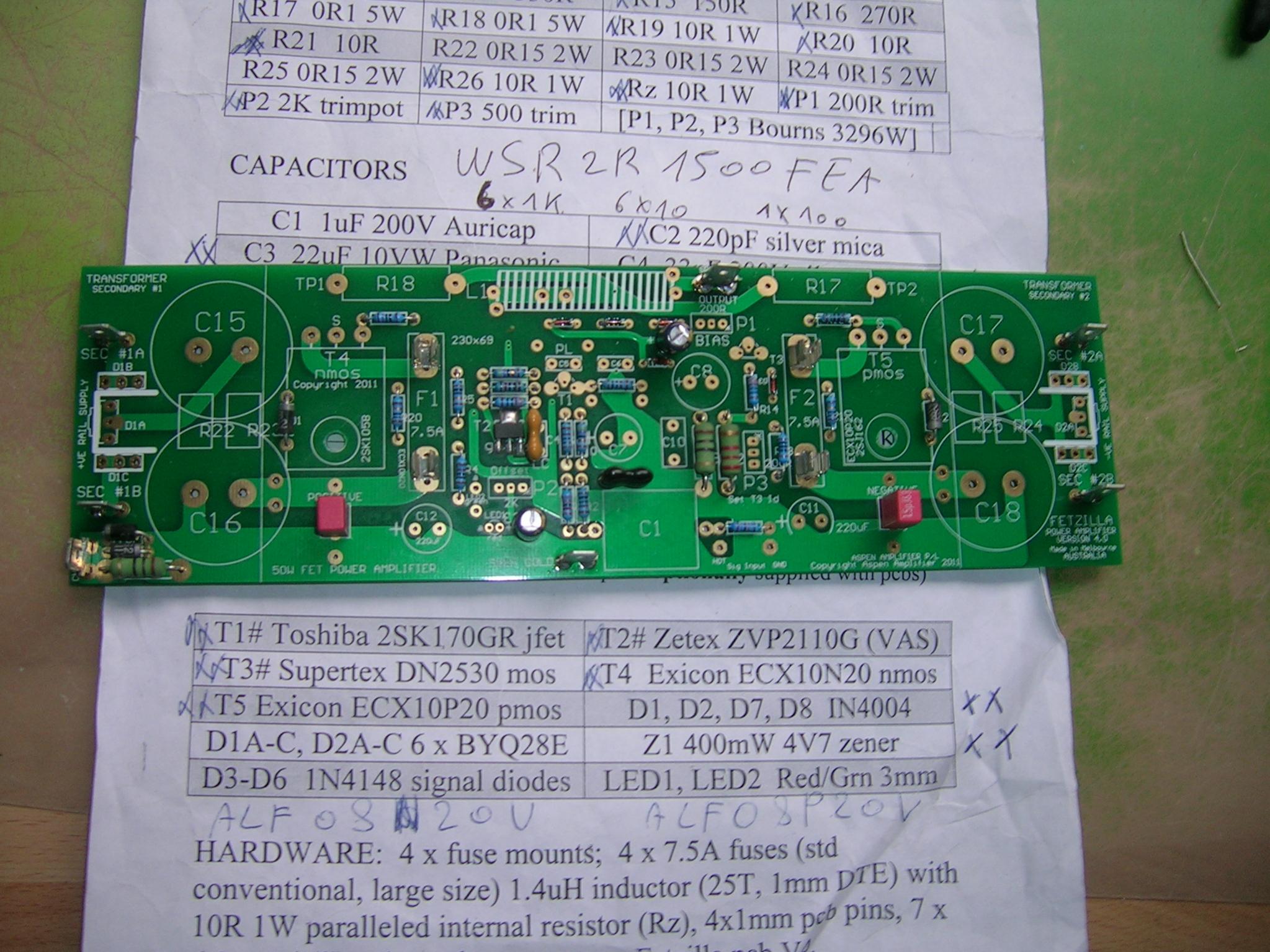

I had soldered the BYV28X with 6800uF for PS, will that be a issue since you recommended the BYV32. If it does, the I have to take out and replace all 12 BYV28.
Hi Syklab,
Yes you are right, for 6800uF caps, you will need the larger, 2x10A diodes.
