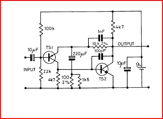

If you are chasing low AC hum signals on a DVM the old trick of a simple amp to boost these tiny levels to something more measurable is worth trying. I think the output would need to be AC coupled too to be universally suitable for all DVM's
This is from Radford.
(Andrew might need a few of these cascaded for that DVM mentioned)

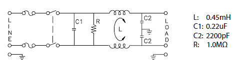

In line filters, do they usually use common mode chokes or differential mode? I thought common-mode chokes had the circle symbol and differential chokes had a figure eight on the schematic...
Do you mean power lines ? The rails ?
If so you can use either.
Common mode chokes in the + & - rails effectively clean up the earth - to some extent - and because the fluxes cancel they can be small & quite cheap.
Differential chokes need much bigger cores to deal with the magnetic fluxes that are cumulative and can tent to saturate the core if there is no magnetic gap. So they tend to be big, heavy and expensive - but if used in all legs they clean the power rails very effectively.
Not sure about the symbols. I watch out for the dots at one end of the coil symbol to indicate polarity.
In line filter I have used in my Fetzilla amp has differential mode chokes (Qualtek 880-06/003). Symbol for differential choke is like letter C with two arrows at the ends that is placed between two inductor symbols.
George
George
Mine doesn't have arrows, just a circle. I thought I had seen a symbol with a figure eight though for the other kind...

To me common mode choke requires two separate coils that have 4 pins to connect to the outside world.
I thought that differential mode chokes had one coil that requires 2 pins to connect to the outside world.
What am I misunderstanding about the difference between common and differential modes?
Any other answers?
Why do I ask again?
