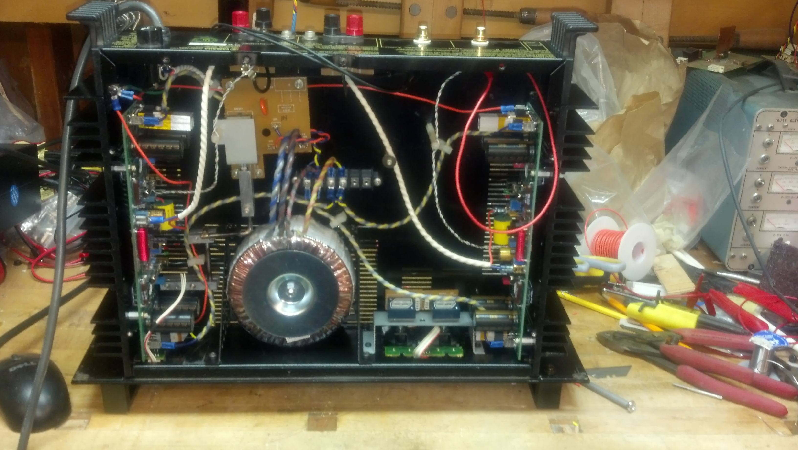

Well, I broke down and ordered a proper transformer this morning. I'll find a use for that other beast in another amp. Hope the new one arrives by the weekend... Thanks for all the help guys!

She lives
Got her put together yesterday, fired up with the bulb tester, all looks good. This morning plugged her into the power directly. No smoke! Adjusted the trimmers, everything looks good. Camera phone photo... The donor chassis is an old Yamaha pro amp, the alps pots are just there to hold the knobs on the front, not hooked up to anything. Quite a bit of work to re-use the on-off switch.

Nice job, Ken, neat and tidy, rather better than most rebuild jobs into older integrated amps.
Great that there is no smoke; that smoke MUST be kept inside all devices. Do have a good listen and report your findings here!

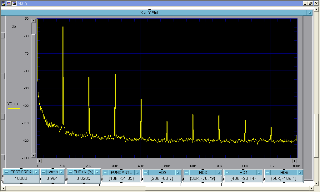

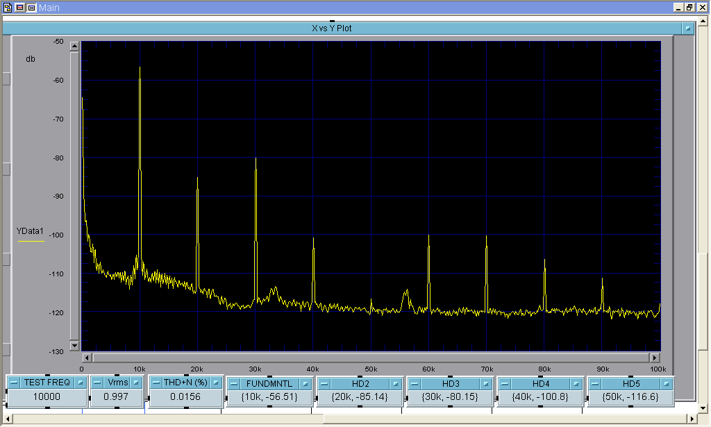

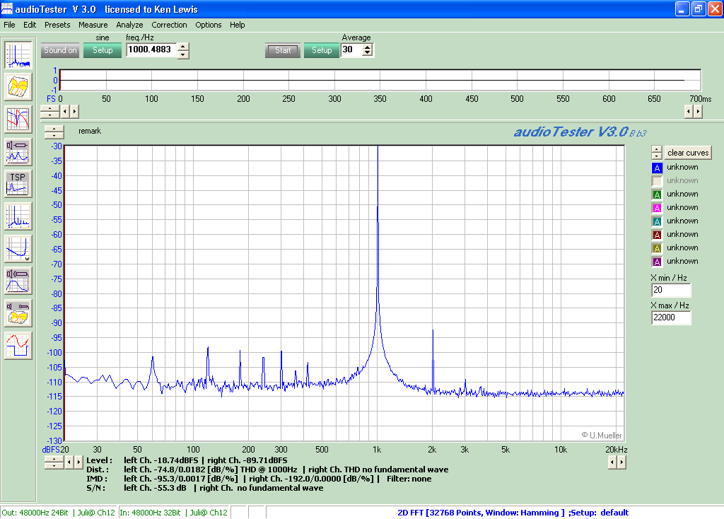

Thanks Hugh. I ran some more 10kHz spectrum test tonight these were at 6.6Vrms of both channels. The tests were'nt as good as the previously posted spectrum. The previous spectrum was running on a slightly lower voltage power supply but with 58,000uf caps and high order snubbing of the diode bridge. The setup of channel A (1st image) is is slightly different from channel B (2nd image). Channel A is as designed, Channel B is with a fixed 220 ohm resistor in lieu of trimmer P2. Otherwise their bias is set the same at 120mV across 0r32 total Re 0r10 Nchannel, 0r22 P channel.
Calculated THD 0.0149%
Listen begins tomorrow...

Ken, if your measurement set-up is correct (I do not believe so) the amplifier performance is poor for the output is 1V (or 120 mW) into 8 ohms.
As Hugh pointed out, don't read too much in these figures, they are probably incorrect.

Nico,
I'm trying to be critical of the amp, rather understand how Hugh characterizes a good sounding amp.

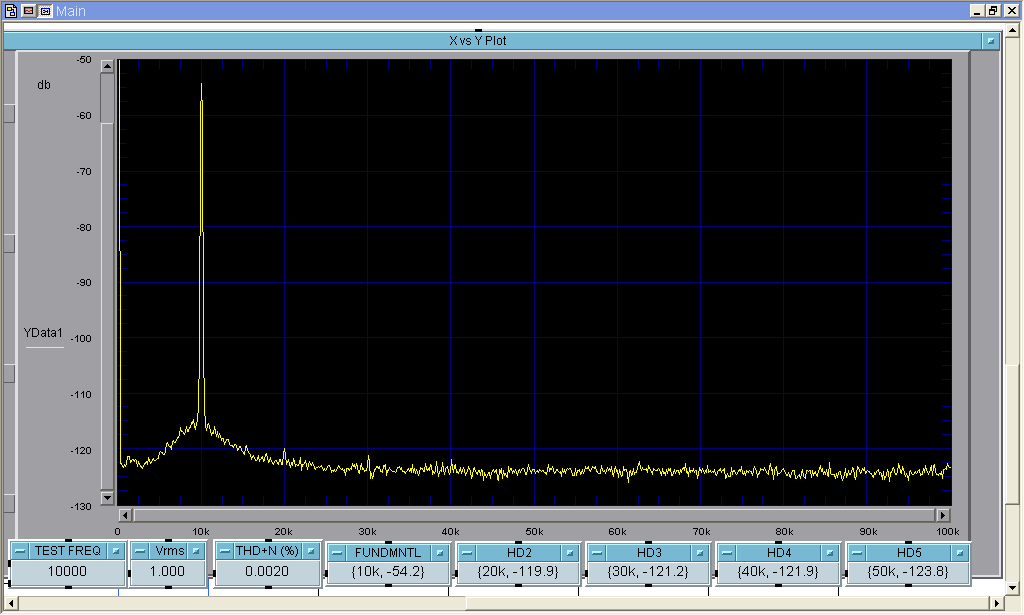

Regarding the measurement setup - the 1v you are refering to is the voltage out of the attenuator, the Vin was 6.6Vrms with an 8ohm load. I need the Vout to the spectrum analyzer to be 1Vrms so that it is referenced to 0db on the analyzer. This matters because I also put the signal through a Twin-T notch filter that gives a relatively arbitrary notch depth in the -40 to -70db range.
(As to why the image says 1 Volt, I have two places to connect the volt meter (HP8903A) on the attenuator one to monitor the Vin, second to monitor the Vout, I forgot to move it to the Vin position- regardless, it's position won't affect the spectrum)
Regarding the rule #2:
I calculated the %THD for 2,3 & 4H combined at 0.01490% and 5,6,7,8 & 9H at 0.00138%. The second value / first value = .093; 1 - .093 = 90.7%
Did I calculate this correctly?
Ken
Ken,
With the proviso that we should not read too much into these figures - they are steady state sine wave, after all, little relationship with music - there is an easier way.
THD (H2.........H20) - THD (H2,H3,H4) = THD (H5,H6,H7........H20).
The subtraction of the second term from the first will give you THD (H5, H6, H7........H20), which is, to me at least, a more indicative figure of how it will sound. If you take TJD (H2,H3,H4) and divide it by THD(H2......H20) the percentage should be greater than 98%. These are ball park, indicative only, but far more valid than THD alone.
Andrew's RMS derivation is NOT necessary if you have a simulator - and everyone has a simulator these days, no? - and his explanation that numerical division was equivalent to subtraction of indices left me in peels of laughter. Heck, I never knew that, did you?
Nico is 100% right. These figures are not very good. It could be that your analyser is measuring highish noise, and possibly distortion coming off the oscillator as well.
Hugh

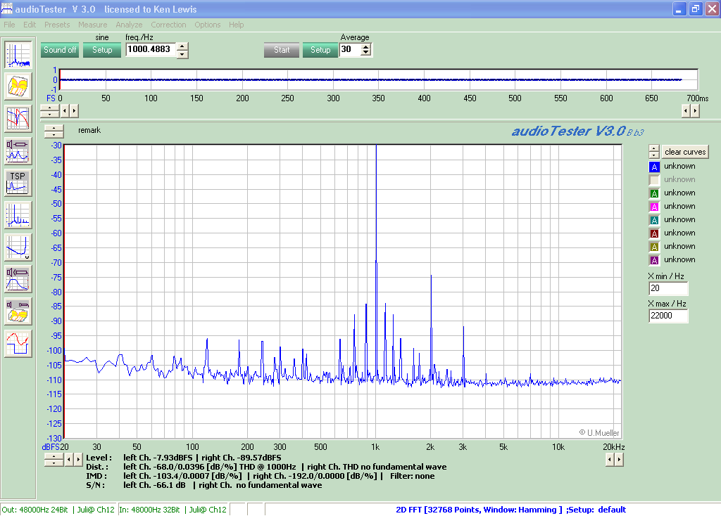

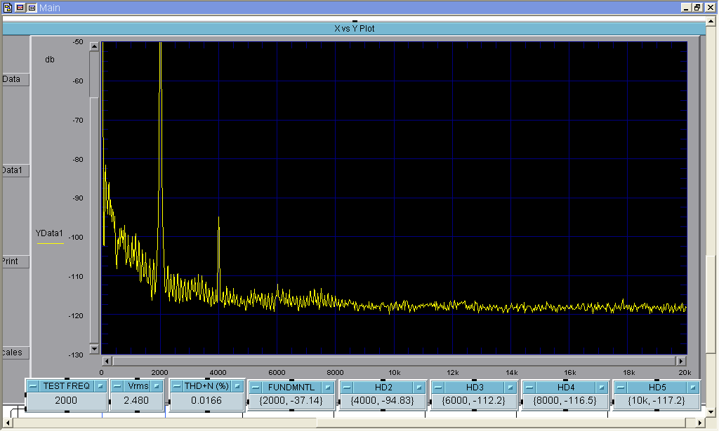

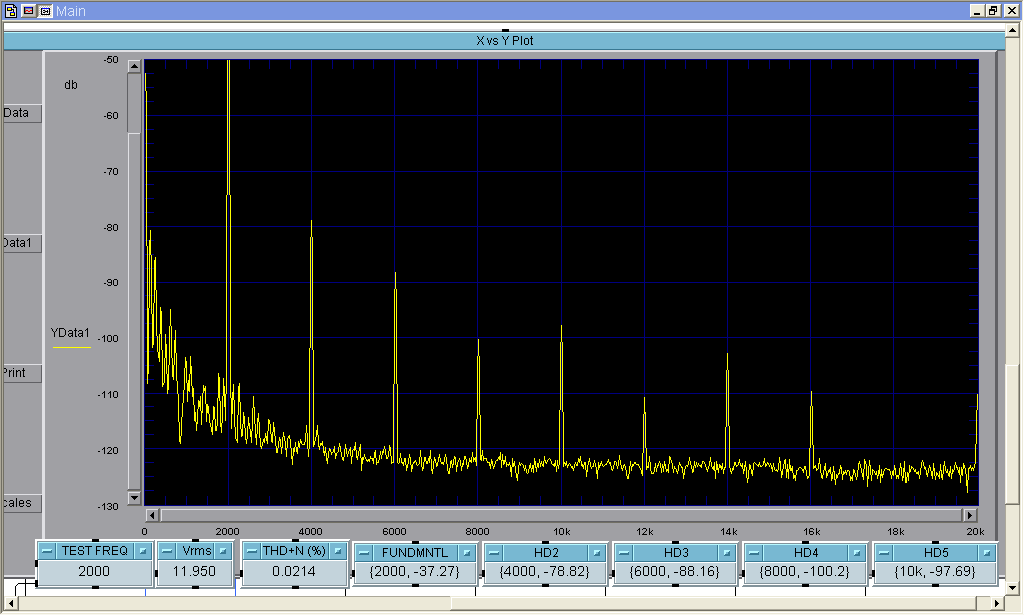

Maybe I wasn't very clear, the prior spectrum are at 10kHz and 6.6Vrms. Tonight I ran a few more spectrum, 1st at 1kz at 2.83Vrms (1watt) Krohn Hite source, 1kHz at 10Vrms using the computer and Juli@ sound card with the Knohn Hite as the source. I also ran 2kHz spectrum at similar power levels for comparison using the spectrum analyzer and KH source. You can see that the two are quite similar. Last plot is the Knohn Hite source at 1vrms out.
Ken
Ken
Ken,
Looks better. These are quite respectable. I do not expect very low THD from this amp; loop gain is about 50dB and there is predominating H2. These are quite close to the simulator, within 5dB, impressive....
Thanks for sharing the plots,
Hugh
