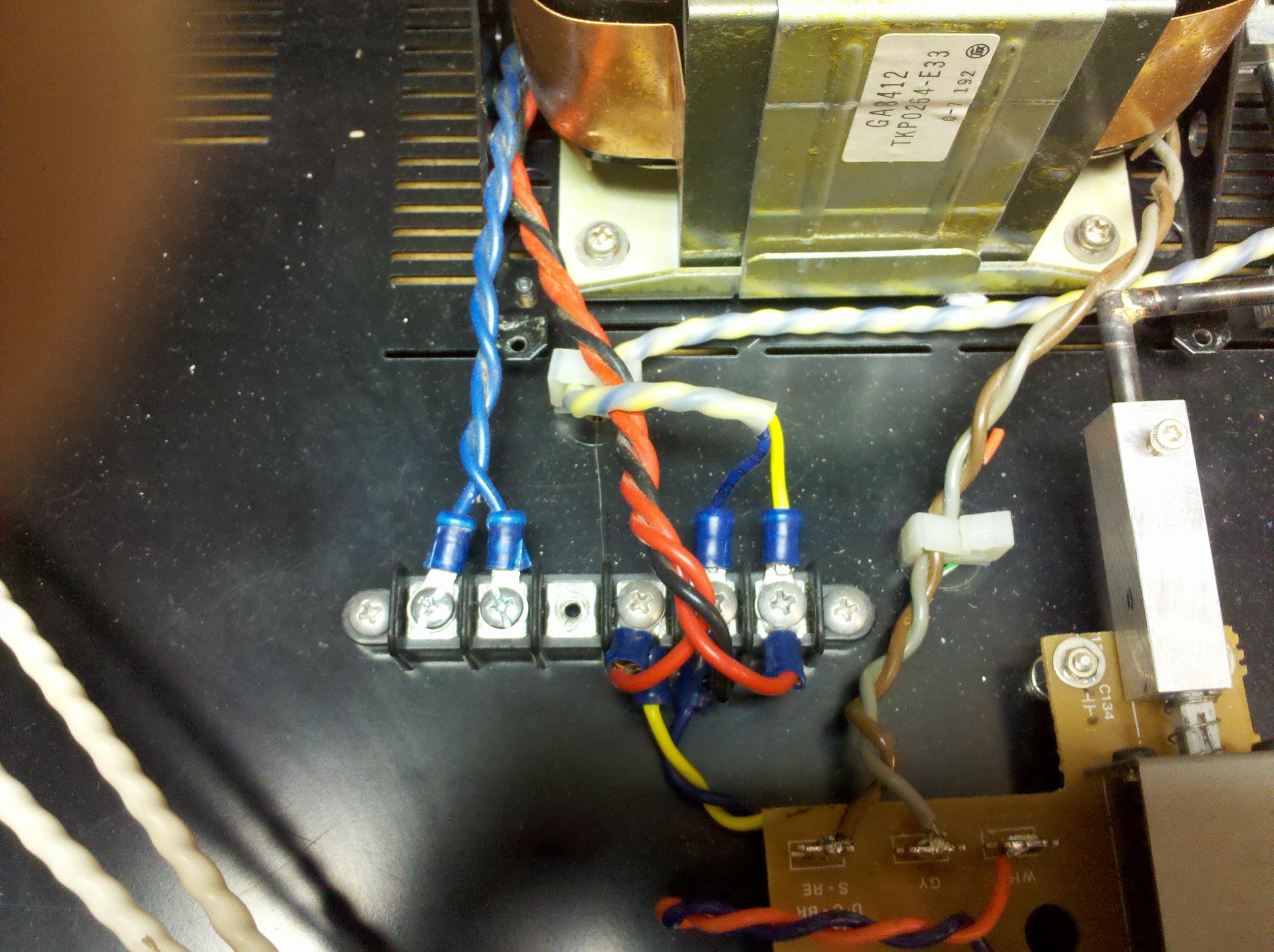

Well, I'm completely stumped. I have cooked resistors R22/24 on two seperate attempts to power the boards. My transformer is 30-0-30 plus a 15vac tap. I hooked the yellow wires one each to the SEC #1A and #2A tabs, and the blue wires to the #1B and #2B tabs. I left the fuses F1 and F2 open and removed resistors R20&21. I connected the chassis ground to the board The spkr cold and output were left un-connect. I used BYV32 diodes. I've compared the polarity of all my caps with your board photos. I can't for the life of me figure out what I'm doing wrong. Any/all help would be appreciated.
Ken
Ken,
First, your rail voltage is too high; 30Vac secondaries will generate more than 42V rails, not the 36V rail this amp is designed for. So that's one issue.....
Second, I think you have an earthing conflict. It looks to me that rather than connect one secondary to the positive rail (Secondary #1) and the other to then negative rail (Secondary #2) you have connected one lead of each secondary to the positive rail, the other to the negative rail supplies. This will take out R22 and R24 everytime as there will be a conflict across ground.
Check your secondaries again...... fortunately only resistors need replacement.

It looks to me that you have problem that is related to your transformer connection. Just make sure that there is no physical connection between secondaries by using ohmmeter. When you verify that transformer is OK then go to your bridge diodes and check the polarity. Try to connect your transformer without any connection to the chassis ground first and see if it works.
George
Ken,
George is on the money; I described it as an earthing conflict, but in truth his description is more apt. You effectively have one secondary fighting the other, across one of the two resistors between the filter caps.
Solution: Identify EACH secondary wiring, start and finish. Connect one secondary, #1, start and finish, to the two AC inputs Sec #1A and Sec #1B, on BOTH pcbs if you are using just one trafo for both. Then connect the other secondary, #2, start and finish, to the two AC inputs Sec #2A and Sec #2B, on BOTH pcbs if you are using just one trafo for both.
The order of 'start and finish' is not important. What is important is that, IF USING ONE TRAFO, one secondary supplies the POSITIVE RAIL of BOTH CHANNELS, and the other secondary supplies the NEGATIVE RAIL of BOTH CHANNELS.

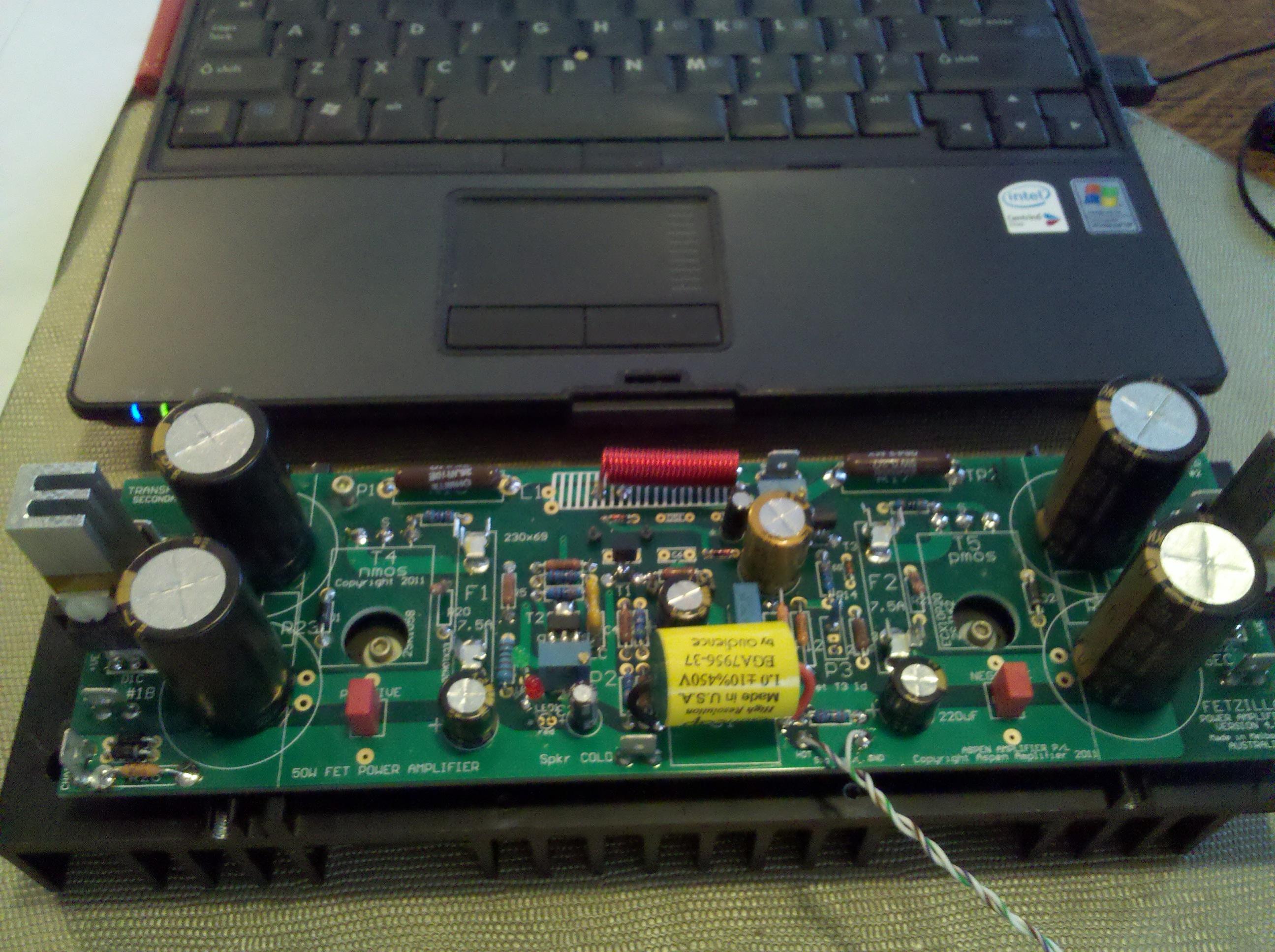

I will still make a drawing for review prior to trying again. With the amp hooked up to my existing supply which makes +- 32vdc and 58,000uf capacitance I ran one channel for the day. Set the bias at 130mV warm. The sound is very nice, open and clean. I made the following tests using an HP8903A, which seems a bit pessimistic on the 10k values. I also ran some 10k spectrum plots as well. Note that these plots are with a twin-t null of about 50db and fed through an attenuator to have the voltage at the spectrum analyzer 1vrms/0db. With the amp making 1vrms at 10kHz, the harmonics are at or below the noise floor of the analyzer.
Ken

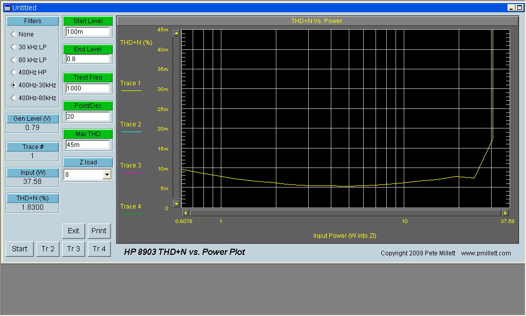

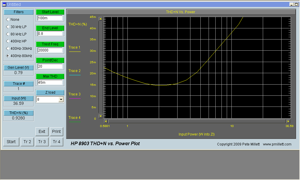

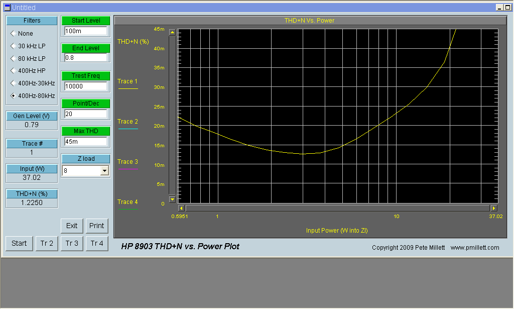

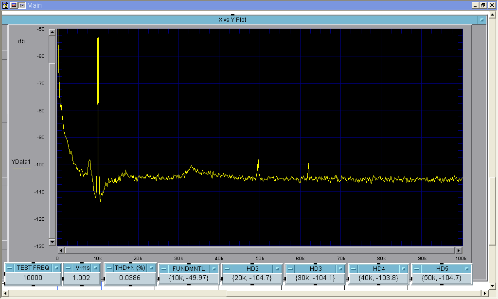

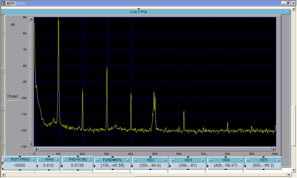

Ken,
I'm seeing very high THD + noise here; 0.9% up to 1.8%, is this correct?
I'm surprised it's so high, perhaps some interpretation is in order since you are saying distortion is also below the noise floor at 10KHz and this is, we know, a very quiet amp?

Ken,
Hugh,
First I should mention that the HP8903a is not that good of a source, a bit noisy and highish harmonics, so the values are a bit inflated, and recently, for the 10k and 20k measurements, it seems to be getting worse - time for a tune up! I also have a consistent spike at 48 and 63kHz that seem to be coming from the computer and the power supply of the monitor. I take the measurements with the over head florescent lights off as they add quite a bit of extra garbage as well.
The THD + noise you're citing is at the final measurement, where my power supply runs out of steam and clipping is starting. The 1k THD + N power plot looks pretty good with the 1 watt reading being about .007% (note the vertical scale 0 to .045%) - as mentioned above I believe that it's better than the graph shows. What the graph does say, is that the noise is low, otherwise you would see a steeper drop in the graph as the power come up.
The 10k spectrum was made with a Krohn Hite 4402b as the source. In it's current state of tune the KH measures .00018% THD at 10kHz 1Vrms. Using the Harmonic values of the 10kHz 1vrms measurement (the values could be lower than whats shown, but, it's all I've got) the THD calculates at 0.0012%. The 10kHz 6.6Vrms calculates at .00925%.
by the by, I typically pass on the salt...
Oh yeah, and I'm using Re with 0.1 ohm for the N channel and 0.2 ohm for the P channel.

Ken...It looks to me that you have problem that is related to your transformer connection. Just make sure that there is no physical connection between secondaries by using ohmmeter.... George
It's not absolutely clear on Ken's pic. what the connections are to me, but like most E-I laminated amplifier power transformers, the main secondary winding - RED+BLACK+RED (I think) is not 2 separate windings but a single, centre tapped one. Usually this is fine with twin, bridge rectified supplies where the CT is earthed but not so fine with a circuit calling for separate AC windings where the common return is via the rectifier. This would make it impossible to follow the schematic for the PSUs, assuming that is the case for the windings. I suspect that either the transformer or the rectifier design may need changing, unfortunately.
Perhaps the best solution would be to use the specified 25 + 25 V 160VA transformers or a single 300VA of the same type, connected to both boards in parallel as described a couple of times already.
Ian,
This is exactly the setup, Red+Black+Red.
Ken
