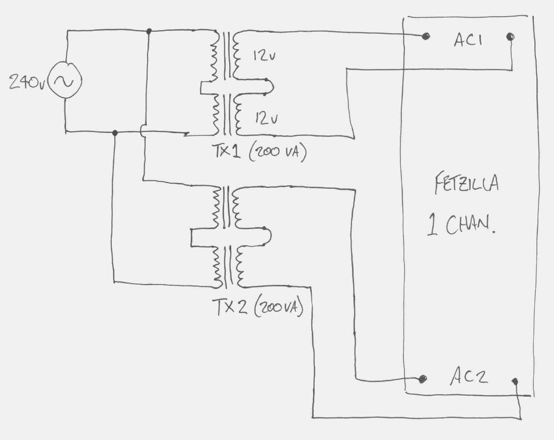

Transformer wiring question
Hi everyone,
In hunting down transformers for this project, I found some 200VA, 0-12V x2, toroidals at a clearance price and was considering using 2 per channel wired as shown in the attachment (I'll of course switch and fuse it in practice). The 4 required for a stereo amp are still cheaper than any single 300VA 0-25V x2 transformer I can find, and much cheaper that two 160VA.
Within my limited knowledge of electrical wiring I can't see a problem, unless I must make sure the AC phase is the same at either end... but past the bridge its all one-sided anyway, right?
Does anyone care to comment on this scheme for the FETZilla? Is 24V AC an acceptable voltage to have. Also on sale are 300VA 30-0-30V... if this is not too high it would be cheaper again for me to use 1 per channel.
Many thanks,
Tani.

Hi Tani,
That will work very well, no problem at all. You could in fact use each transformer to power the positive supply of EACH module, in fact. That way you'd only need to buy two of them, giving a combined 400VA anyways, more than enough. Separate bridges would ensure galvanic separation and give good results. Just be sure to have one trafo for the positive rails, and the other trafo for the negative rails, otherwise earthing may conflict.
A 30V secondary will give you 42V, which is too much for this design.
