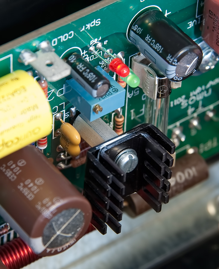

I almost done with burning-in stage. First I run it without the load for 14 hours just to form all electrolytic caps. After that I decided to lower temperature on VAS device and added heatsink to it which knocked temperature down by whole 9C and I happy with that. Before this modification temperature on the case of T2 was 48C (22C ambient) which is too high for my taste and this was without any signal on the input. Now temperature on T2 is around 39C with 48W on the output. I can post the picture of that mod if anybody is interested.
After this modification I have increased VAS current to 14mA and bias current to 500mA. I run it for 16 hours with the dummy 7.5ohm load made of 3 non-iductive 50W resistors mounted on heatsink. As input souce I used function generator at various frequencies. Unfortunately I have no scope to tell you more at this point. The acid test with the speakers is coming soon.

Thank you for an update. I am in no rush to connect the speakers. I am waiting for you guys to finish the testing so I can easily change components before everything is boxed up. So far no surprises, the amp is running with dummy load for 3 days now with VAS at 14mA and 500mA bias. VAS is not overheated anymore with the heatsink I put on it.

Could you give us a photo of the VAS with heatsink?
I have not noticed any heat issues with my VAS, the padding is generous, and am a little surprised you feel it's necessary to add extra cooling. By my reckoning it's dissipating around 430mW with 12mA current; your 14mA is a tad more, I suspect you have increased it?

Just to clarify, it is not necessary to do this modification and your 430mW measurement is correct. It is just me, I prefer lower temperatures for active components. I got similar measurements of 420mW running without input signal and 550mW with 48W on the output. With the signal case temperature was about 48C which is still within the spec. Here is the picture.

My golly, George,
You should have been in charge at Fukushima - your policies would have averted disaster!!
You have glued the Al rod onto the case with epoxy, I presume?
