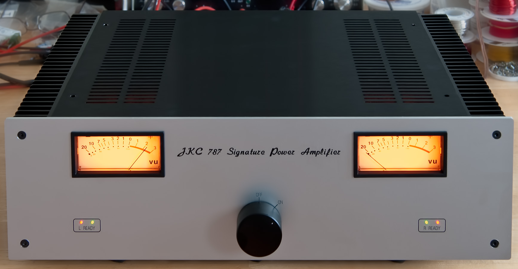

Here is my finished version of Fetzilla amp. I was playing music for the last two days and I am really impressed by quality of sound. Bass and vocals are excellent. Piano sound is as close to real thing as you can get in both classical and jazz music. Also guitar sound is very detailed and real without any coloration. Sorry guys for not using any poetic language for sound description but I will leave that for others who didn't built it yet. It is a keeper for me, thank you to all contributors to this project.
George

Beautiful work, very elegant, like the VUs a lot!
But, I note it is a JKC 787 (is that a Dreamliner?) case, not a FetZilla!!
I enjoyed your description of the sound, you will make an audio novelist yet!
I live in hope that others, as they complete their FetZillas, will post their impressions - good and bad, let's keep it credible - on this thread. It is fitting closure and appropriate feedback for what has been a very successful design, and indeed, Group Buy.
Hugh

Actually, my build is anything but stock. The major difference from original design is stand alone power supply with bigger transformers and bigger filtering caps. Because of that I used only 3300uF on the board itself to make it even faster in big current swings. I also used two additional circuit boards, one for soft start and another for VU meters. Another change I have made is zobel network at the output. I used pi filter there with those values: 47nF/8.2ohm, 2uH with 2ohm in parallel, 68nF/5.1ohm (this leg mounted on output terminals). That is all. Currently I am running this amp with VAS at 13mA and bias 450mA settings. Have fun.
Hugh,
Thanks. It is just name and has nothing to do with the planes . I have Fetzilla name on the back plate however, so nothing is lost.
George

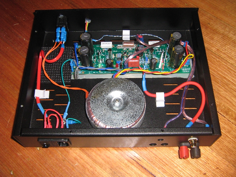

At last I have finished my pair of FETzilla monobloc amps. I have used Hugh's NAKSA-70 chassis, in which the FETzilla fits very nicely. The chassis is one piece of folded 3mm aluminium, and acts as the heatsink. At a bias of 390mA, I can only just feel some warmth under the mosfets.
I too am very impressed by the sound.
Paul Bysouth
Lovely work, Paul, very neat and tidy. Congratulations! HRD
