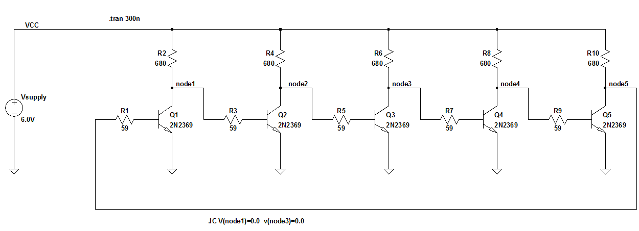

I looked up the digital circuit family used to build the CDC 6600 supercomputer in 1964; they called it "DCTL" (direct coupled transistor logic) and built it out of 2N2369A discrete NPN transistors. Here is the textbook, see Figures 12-15 (p.22-24) {warning: large .pdf!}. As you can see, they claimed that DCTL gates have an average switching time of 5 nanoseconds.
I built a 5 stage ring oscillator out of DCTL gates and simulated it in LTSPICE, schematic attached. The simulated oscillation frequency was 19.7 MHz (using the 2N2369 .MODEL provided by Linear Technology). Thus a complete period of oscillation requires 50.8 nanoseconds. There are five transistor switch-on events, and five transistor switch-off events, in each 50.8 nsec period. They're switching on and off pretty doggone fast.
The oscillation period of a 5 stage ring oscillator is 10 gate delays (5 gate delays for the high-time, and 5 gate delays for the low-time). So the average gate delay in simulation was (50.8 nsec / 10 gates) = 5.08 nsec/gate. Just as the CDC guys designed it, fifty years ago. Hats off to you, gentlemen.
A couple of fun facts: the complete CDC 6600 computer system contained 400,000 NPN transistors (p.20) and its mean time between failures due to transistor failures alone, was "over 2000 hours". About 3 months if you're running 24 by 7. Gulp!

Have they chosen the base resistor and collector resistor values to give good enough unambiguous switching voltages and yet hold the switches just far enough out of hard saturation?
If this is their "trick", that might explain why they get fast switching times.
The low base resistor value will certainly help with low switching times.
Yes it seems obvious and I have read that they needed a collector current enough to power up to 5 or 6 similar devices, and they had a hfe=10. If you read the book it mentions what I knew as a rumour, the longest piece of wire was like 2-3 inches because they had measured propagation delay in ns per foot. Things were so hot the computer had a dedicated freon cooling system. They were amongst the first to use silicon transistors which could handle more Ic, more power, ran cooler and more reliably than germanium. Very good read.
... and they had a hfe=10.
Not quite. The table you are referring to, shows the chosen Ic/Ib ratio in saturation. CDC selected a ratio of 10, which gives a good balance between low Vce_sat and fast base-region carrier sweepout. Most transistor data sheets (both ancient and modern) measure Vce_sat at an Ic/Ib ratio of 10, for the same reason. Look at a few and see for yourself.
Vacuum tube digital logic gate afficianados may recognize one of their OLD speedup tricks, in the plot of gate output voltage vs time. But in this transistorized version, the speedup diodes come for free as part of the preceding and following gates. You will note that Fairchild's uA914 IC digital logic family, which used a superficially very similar schematic, deliberately avoided this stunt. Fairchild chose slower and safer. They weren't building the worlds fastest computer.
