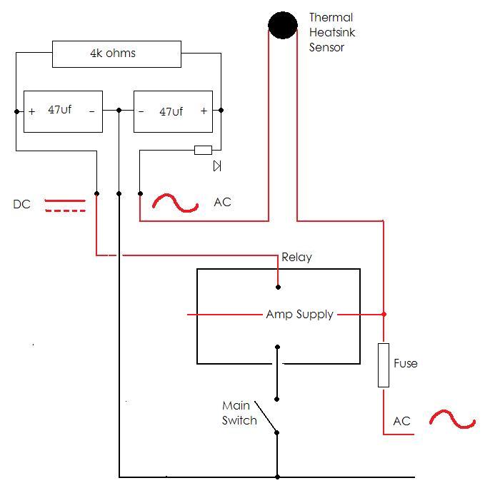

Back to the DC filter. Seems to make sense to insert it right between the mains and the transformer, replacing the terminal block that's currently in place.

I think this is it (Back on topic)
Take a look at this layout. Does this look ok to you😕? The grounding (-) looks so dramatically different then the diagram but I think this is right. I'm trying to lay this out so I can put it in the amp and close it up.

Great thank you. Its in the amp now! When I get my hands on the camera I'll show you.
It's completely non-evasive. The board is bolted in an upright position with the resistors being closest to the perforated top panel and away from anything where heat could be an issue. It's all point to point on the board lol, looks like a speaker crossover. I mounted a barrier strip to the board, and everything is connected with eyelets.
So, I can literally remove this, and you would never know it was there. The board is even mounted on the sidewall with the original screw holes, I just used some longer ones.
Thanks for all the help, this works sweet.

I'm thinking about adding fuses (on the incomming AC and the outgoing DC to protect the relay). Seems like a safe and prudent approach. I'm not sure on the values but I think I'm looking at about 125v 100ma. With the initial feed to the circuit, we get a very low current with 170v on 4000 ohms. However, as 2k ohms is acceptable for the circuit, that would put this around a 100ma load.
The 290ohm coil stated operating voltage (min) is also around 100ma @120v AC. While I am way below that, this should be safe. Usually it runs at 120v AC- 290ohms which is around 400 ma constant. But that is AC. The DC version of this runs at 24v - 290ohms which is equivalent to 100 ma.
100 ma seems safe anyway I look at it. If I keep popping fuses on the in-rush (600ma on 170vdc - 290 ohms), then I'll have to raise another 100ma? Should I be looking at slow-blow maybe?
If you want to add a fuse (you only need one) just add it in series with the supply to the diode. You can try 100ma but remember there is the switch on surge (low as it is) of the first 47uf cap. The relay "surge" doesn't really come into it as it's a series circuit and the 4k resistor sets the max current. The relay does see a current spike... but that's not reflected in the AC current draw in the same way. It's just the second cap discharging into the coil (and initially charging via the 4k).

Well I tried a couple fast blow 100ma and 200ma. They all blew from the in-rush as soon as I plugged in the power cord, no surprise. I couldn't find any slow-blow types in those values locally, except for some 315ma. The 315ma slow blow works and holds fine.
I also discovered an interesting phenomenon...
Due to the low operating voltage I'm using for the relay, if there is a power loss when the amplifier switch is turned "on", what ever is left in the caps will discharge across the coil. Then the relay will release and remain open.
So, when the power comes back on, the relay will still remain open with the amplifier switch still in the "on" position. This is because the cap never had the chance to build up a snap-closing charge, as the circuit itself is still closed allowing voltage, but only low voltage, to pass though the coil which is not enough to close it.
Soooo....In order to actually get the amp to turn on now at this point, is to turn the amplifier switch to the "off" position, to allow the cap to charge up to high voltage, then switch it back again to the "on" position.
While this could provide a false sense of security for overall surge protection, It would appear that this does indeed provide a bit of safety from utility issues that can occur during power losses and restoration. Maybe even "brown-outs" would be less of an issue if the operating voltage is set low enough to cause the relay to re-open itself.
While this may be nothing new, (new to me though) I thought this was a very interesting feature of this circuit.
