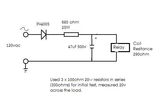

I guess this is functioning good so far. But I have a concern about the resistor wattage....
When I used the dropper speadsheet, a 120v supply would require a 649ohm resistor is series with the diode to produce 20v (6.5 watts). However, by using simple ohms law calculator, I would have to say that 680ohm across 170v would = 42.5 watts.
So, I think that spreadsheet is not right for this project since we added a cap to feed the voltage (and not as a capacitive dropper).
The single resistor gets HOT, and even tho it was disscussed to get the wattage match, I'd need a pretty good pile of resistors to get this all to match up.
I think I should shoot for a 50w (maybe ohmite?) or an aluminum heat-sink type. It would help keep the size of he installation small.

You need the cap precharged.
Why ?
Because it allows the relay to snap shut at 170v, and then the resistor can be chosen to be much higher in value (ohms) as the relay will hold OK at a much reduced voltage. How low ? You are going to have to keep adding resistance to find out.
Do you see ? That's the whole point of doing it that way. To try and reduce the power dissipation.

ooooh. Ok I see. Quite right-If that's the case, then I can still test to a point this way to start with by just varying the resistance, since the whole thing will have to settle down anyway to a "holding" voltage.
I have a slight advantage it seems, since I have direct access to the contacts.
For example:
2k ohms : the contacts will not stay closed, even when the contacts are physically pushed down.
1.3k ohms : the contacts won't close on their own, but will hold when physically pushed down - (although this has a weak feel, like low power refrigerator magnet)
1.1K ohms : Again, no close, but a more powerful snap-closing on the assist. Also, I can actually hear the coil at this point humming just a little while it's open, as it is struggling to close, hum goes away when I assist the close.
So it looks like 1.1k is the current winner (although, there is still a little play room). Seems like good holding strength and I should be able to get the resistance and power dissipation with 2 resistors. Now it's a matter of picking up a switch for testing, so I can wire the cap(s) to be precharged and see if it will kick it closed.

Ok, with that first setup, 1.1kohms + 1 x 47uf cap, I get that nice "snap" closing that you were talking about. Allowing the cap to be charged, putting a switch after the cap.
Since I ordered 2 x 47uf caps, I took your advise and tried both together, putting 1 just after the diode/before the resistors, 1 after.
Well, this ends up being a whoooole different story-lol. As it stands, I've got 2.7kohms in the circuit (checked measurement) and still the relay will close on its own without even pre-charging the caps!!!
Looks like a better direction. I haven't reached the limit of resistance yet since I ran out of test resistors. But this is going to be a much higher overall resistance with much lower power dissipation, entering the 10watt range.
Actually, I see everything more clearly now. Even going back to 1 x 47uf cap alone, but placing it on the diode end, still functions as above with 2.7k, closing the relay-no pre-charge.
I think I got it...
1) I could keep it simple- with 1 cap on the diode side with a smidge lower resistance with slightly higher power dissipation (around 15 watts) or...
2) Use two caps- in the snap close arrangement with even more resistance yeilding lower power dissipation (10w or less)

I moved to the amp and the whole circuit is now self supporting using the amps power and main power switch. Components are still on a breadboard though. (by the way I omitted the bleeder resistor, since the dropper resistance does this just fine when it's all unplugged)
As you suggested I did some more experimenting. I stuck with the cap/resistor/cap pre-charge. What I did was to allow the contacts to grip with an assist, where they hold a contact but without much force (ala-refrigerator magnet hold) just to push the limits.
Then I allowed the precharging to function, which of course snaps hard.
I ended up with 4k ohms.... amp turns on and everything seems to be working fine. So far so good. THANK YOU!
At wrap up I might go back up to 3k+, as that holds together a little tighter against the spring-force and gives me a warmer fuzzier feeling...
A few final thoughts: The resistors are still pretty darn hot. Right now I'm using 1k+1.5k+1.5k 25w ceramics. I wonder if I haven't considered something in the power dissipation - seems like I should be way safe on this.
Also, I would like to use 1 resistor only for a cleaner install. Ohmite has those smooth nice looking resistors. Can you make any suggestions?
Finally, I grabbed a 1N5406 3A/600v diode as I liked the heavy gauge leads, which looked a little more "solder friendly". Any thoughts on using those?

if you move the resistor to the front of the diode ie to the left you can replace the resistor with a capacitor. The cap does not dissipate any power and will not get hot. You need to use an AC cap. Formula is C = 1/(6.28 * f * Xc) 6.28 is 2 pi , f is the frequency in this case 60 hz, Xc is the value of the resistor. This idea is used every where. ie ceiling fans, floor fans, table fans, leds that run of 110 or 220 etc. For a final resistor of about 3Kohms you will need a capacitor vale of C=1/(6.28 * 60 * 3000) or something like 0.88 or 1micro farad is a close enough value. Since you have a diode in the circuit the current will be half so probably 0.47 will do nicely. I don't know what your Z of the coil is so you may have to play a bit with the values.
If you stay with a resistor your circuit draws a wost case of 115V/3Kohms amps giving a worst case power dissipation of around 4 watts, a 10 or 15 watt resistor is fine ( worst case is diode and cap are shorted and the resistor is directly across the line voltage) You circuit draws around 15 or so milli amps or less when running so a 1 amp diode is plenty( 30 times more than necessary)

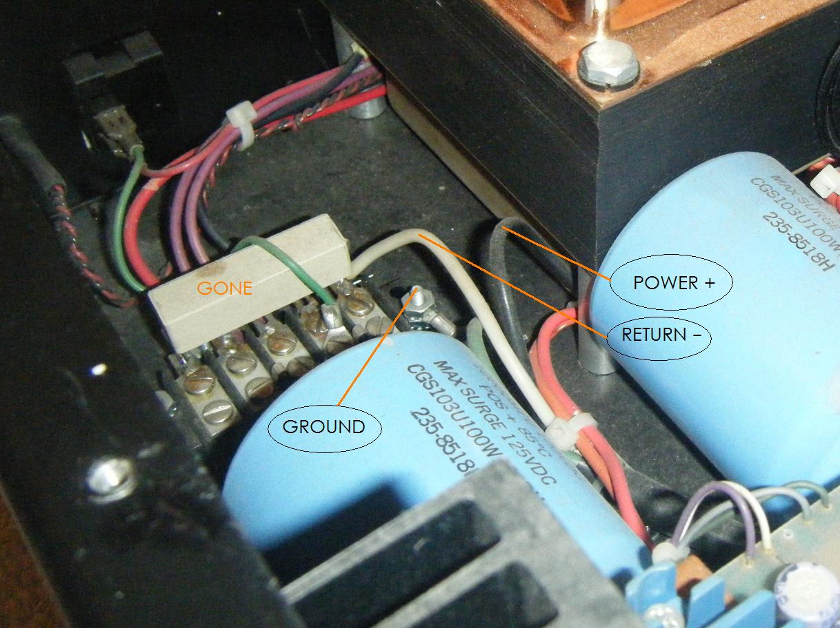

At this point, I can't imagine that what's left of the transformer noise is anything other then related to it's design and build quality. Unless.......
Unless there is something related to grounding, or there is some other source of distortion.
As far as grounding, I find it quite odd that the amp, having a HUGE copper bus bar wrapping around and bolted to the chassis, with the power caps and transformer taps attached, has the ground of the power cord attached to chassis in a different location with a shitty little screw.
(you can't see the bus bar across the bottom well, but you get the idea)
