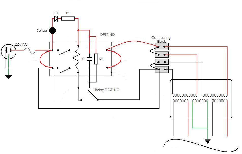

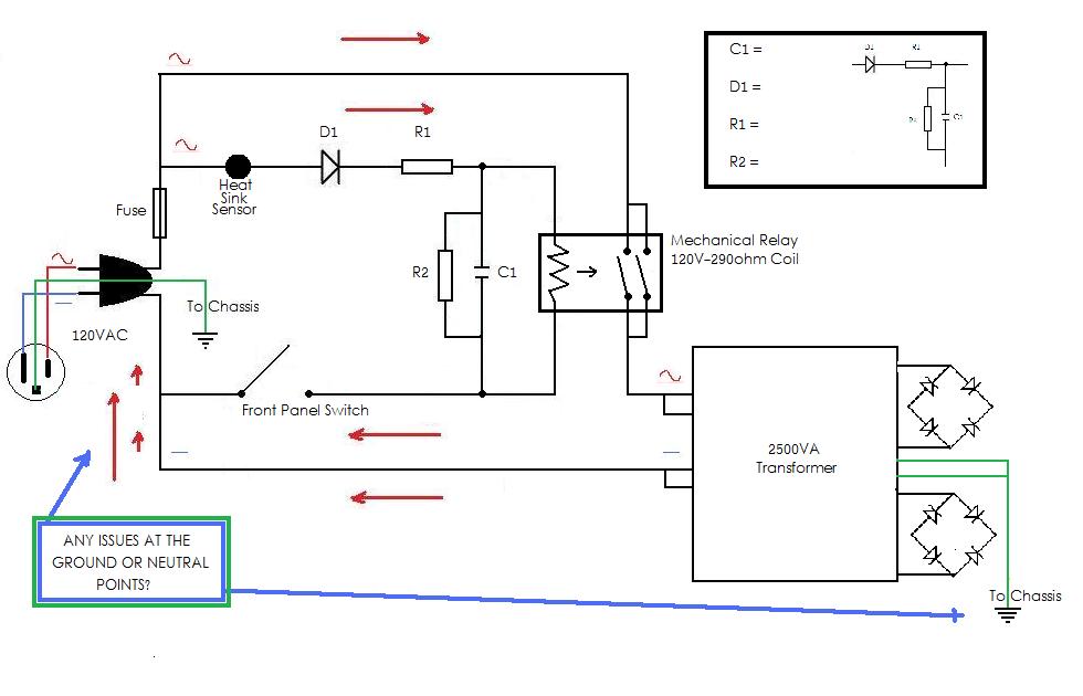

I appreciate your input, does this diagram below shed any other light for you on the subject?Once again, switched and/or fused AC power neutrals are dangerous and probably not legal.
Well I think that this diagram is the best so far.
This is the complete representation of the circuit, up to the point of rectification to the rest of the amplifier.
The proposed added Circuit comprises only of C1,D1,R1 and R2(bleeder).
Removal of those 4 components leaves everything just as it is in its original form with 120v AC going directly to the relay coil and 120v AC going to the transformer.
As you can see, the relay circuit would indeed be fed directly from 120v AC. And what I'm trying to do is feed a lowered DC voltage to the relay coil to quiet it down.
My only other concerns are that this layout is 100% correct, that the ground/neutral is fine as is, and any potential safety concerns.
Next round of questions would be component types and values
Thank you Mooly and everyone very much for all the input.

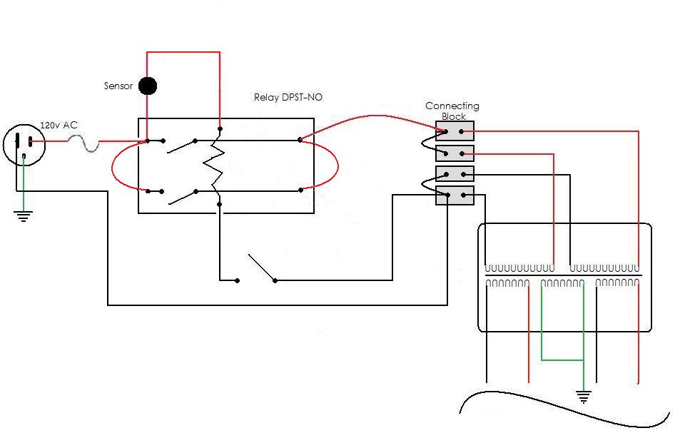

This is also very interesting, I was looking at the set up on the Nelson Pass BA-1 and the usage of thermistors along with the 2 x .0033 caps for filtering. You know, this looks like a good way to go.
Check out the differences between the original layout as it exists now, and the combination of your suggestion + BA-1 idea below.
Honestly, other then the in-rush protection and filtering, I can't tell which is really better here. (although the Pass layout's symmetry looks cool😎)
Having the 2 poles paralleled (++) or having 1 pole on (+) and 1 pole on (-). What's the big difference?
With the original parallel, the transformer goes directly to ground once the connection is complete. To me that doesn't seem like a bad thing.(edit: the transformer to ground is the shortest possible length in the original layout(2))

Having two poles paralleled increases the current handling in theory. In practice it's open to debate the contacts will never operate absolutely together. Overall the reliability is probably better though. The thermistors simply prevent the huge inrush currents that you get with large transformers... again it's for reliability and allows a more sensible fuse value to be used.
The diagrams... I still thing the way I drew it in post #35 is the starting point.
The second diagram above has the coil back on AC as original. The first diagram won't "kick" the relay hard... so you need lower value resistor and large value cap... which is less convenient and runs hotter.
Ok, but I think that those #35 drawings, using a single diode, is going to be half wave, so it'll be more like 85vdc wouldn't it. I'd need to use a bridge rectifier @170v.
But even then... I bet that the coil wont handle a ton of DC.
The highest DC handling Coil made by Magnecraft, in the W199 series, is 24vdc on a coil of the same resistance (290ohm). There are 110vdc and 48vdc versions, but the resistance is waaaay higher (6000-1200ohms).

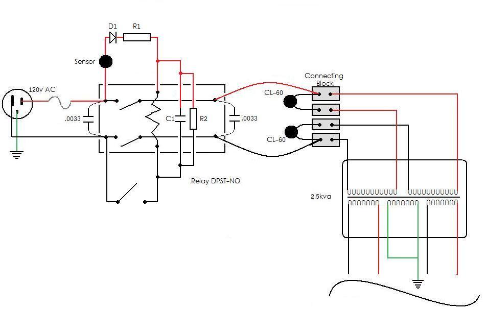

Please, If you could look again at these two, one is adding the same circuit in #35 (however, switch omits cap connection in "off") but look at the all the connection points. If this is wrong then I may have to perform some physical re-wiring inside this amp moving forward.
Thanks Mooly!

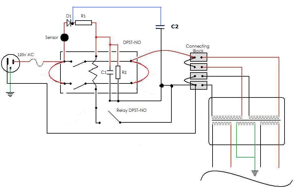

No good... the second diagram doesn't allow the cap to charge when the amp is off. And that's whats needed to pull the relay in.
Look at this rearranged diagram.
And it's one of those things where you just have to experiment a bit with it all.
Resistor R1 needs to be as high as you can get away with, but with a margin of "safety". So if the relay just "holds" with say 40 volts, then think of decreasing the resistor to give around 60 volts across the coil. Make sure the wattage is OK.
Resistor R2... use a high value, say 470 k
I have added C2. Try the circuit without and with. I would suggest around 47uf for starters, same as C1

Ok I see now. So should I shoot for X-type caps - polarized? (I see you mentioned at least 240v, not that this is going to the UK, but using 600v couldn't hurt)
Also, Can I simply divide the wattage needed for each resistor, if I use series connections with multiple resistors? Like if I start with 1.5kohms 15w, would 500/5w x 3 be ok?
I'm going to start at 24vdc and work a little upward.
Last, but not least, any concerns about "flyback-current" from this coil? R2 might catch it anyway.

Use good quality electroylitic caps. They an only ever "see" the peak mains voltage so 250 volt working is fine for 120vac mains.
Any caps that go across the 120 volt line must be rated for twice that peak voltage... that's probably where you have got the Class X and Y from. So that's 400v caps
NEVER CONNECT an electroylitic across AC.
You are correct with the resistors 🙂
"Flyback" or back EMF. A good point actually. It's probably kinder to the switch to include it, and reduce the possibility of any "RF" interference as the contact opens.
There are no issues with it causing problems damage wise, and the original diagram doesn't have it anyway. To include it you put a reverse biased diode across the coil.
Which brings another point... make sure the diodes are rated OK voltage wise. You want a P.I.V. (Peak inverse voltage) of at least 400 volts for 120 vac.
1N4007's are a good choice (1000v)
