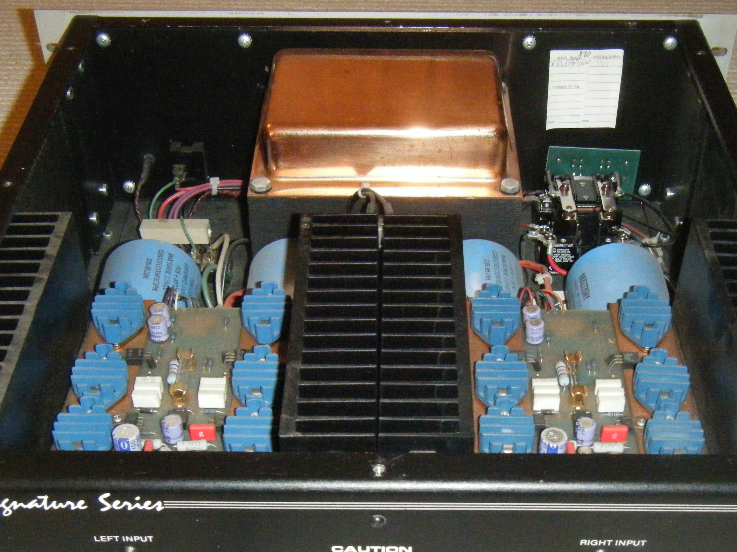

Howdy folks,
I'm going to try another stab at replacing the Magnecraft W199AX-9 relay in my PS Audio 200c, for a new Solid State relay (SSR). The reason for this is due to coil noise in the mechanical relay, which is audible and somewhat annoying listening to music at low levels.
Relay Item # W199AX-9, 199 Open Style Power Relays / DPST-NO, 40 Amp Rating (AC) on Schneider Electric US - Magnecraft Relays
My theory is that the open relay in this amp is also responsible for some distortion of the AC at the zero cross point, enough to also make this transformer hum. That would also mean that a simple DC filter, that will not allow DC to pass or "DC like" component to pass on an AC line ( like the Humbuster, also PS Audio), would actually not be able to do anything to help the situation, since the AC would be bad after the relay. I actually own one, it works on other amps but not this one.
I could be way off on this, however, on 2 separate occasions, 2 different transformers were tested independently and serviced by 2 different companies (one being the OEM Paraline). Both transformers were found to be actually quiet in operation UT. One of the members of this forum re-installed the transformer, still had Hum even after vacuum dip/service. However, after installing a Teledyne SSR, everything went nearly silent.
So, I figure, why not try it. Plus it's fun to learn😎
I have been fortunate to run across a little info that points to this solution as a workable one, and that the open style relay of this type can be successfully replaced with an SSR to reduce or eliminate noise.
However, I have not been fortunate in being able to speak to the individual(s) directly on exactly what was used and how it was wired. So, I'm wondering if I could get some help from the community here.

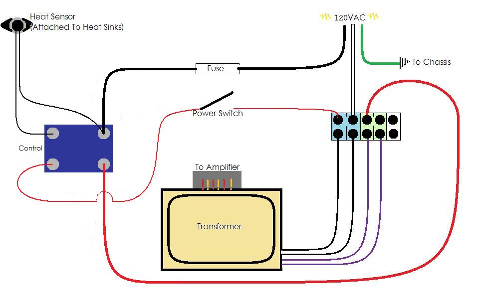

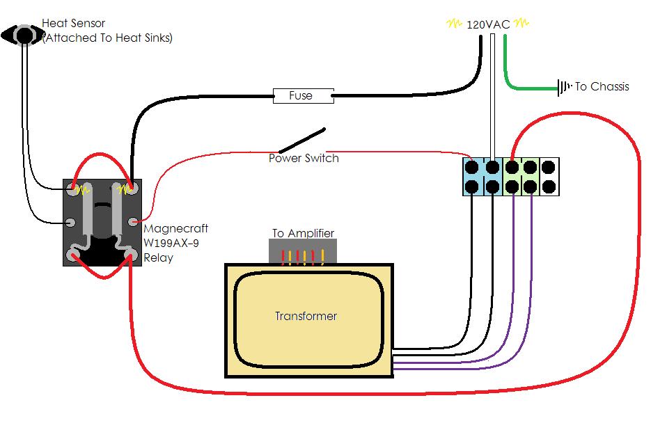

1): First of, based on the drawings below, does this look like I have this planned out correctly?
keep in mind that the W199 is being jumpered on both ends, tying the poles together electrically. In turn, this also serves as a pathway for the control voltage, traveling from AC (+) to over the relay, to the heat sensor and then to the control connection. The other end of the control of course goes to the switch then back to AC(-).
The plan for the SRR is nearly identical to the W199, with the exception of having to jump 2 poles. So in this case the job would seem to be perfectly fine for a single pole SSR, with the control voltage being fed at the same point as the open (+) side of the relay, just as in the original layout.
I'm not sure why a 2pole was originally used, other then for connection flexibility. Furthermore this appears to be very simple with no soft starting, which may be the reason why the manufacturer of this amp suggested that it be left on at ALL times.
2): Should any resistance be added on the control line? If so where?
The coil resistance in the W199 is 290ohms. Also it would be very easy to connect a resistor and the switch at the unused portion of the barrier strip, then connect the other end of the resistor to the AC (-) end.
I would suppose that as long as I'm within the operating range of the control switch, that would be fine for the relay. However, the question comes up for the actual power switch on the amp, and the heat sensor. Otherwise I guess I could try to match the resistance-overall?

Power control solid state relays I have seen use a logic level to switch, usually accepting 3.5 to perhaps 30 volts as a control signal. So you need to check that for definite on any relay you intend using.
I can't for a moment imagine heat is a major consideration for an application like this. Easy to calculate roughly, just look at the quoted on resistance and look at the current you will be pulling through it.
Yes. 120VAC is used to supply the original relay. While many SSR's use a small control voltage, the "drop-in" replacement will need to handle the same as the original (unless I modify).
This SSR from Magnecraft seems to fit the bill, although the voltage control is wider(90-280):Item # 6240AXXSZS-AC90, Class 6 Solid State Relay / SPST-NO, 40 Amp Rating on Schneider Electric US - Magnecraft Relays
While I couldn't disagree, I did find a few smaller foot-print heatsinks that would fit anyway. I think it would be prudent not to attach it directly to the bottom panel, since the main caps are laying on the panel, right in front of the relay position. Any potential heat would transfer to the surface of those capacitors.
I'm not sure what resistance I should be looking at. Do you mean the resistance of the mains of the transformer?, or the amplifiers rated output to the speaker load? I believe you mean the latter. The tranformer is rated for 2500w, being fed 120v, then the current draw would be at most 20.83Amps-no? I thought that the mains resistance was like 1.6ohms, but I've misplaced the data sheet...
Also, on a different note: I did read that back to back SCR's (SCR(2)), seem to be the way to go for low distortion AC control. (which the SRR above has).

One thing to consider about an SSR is the switching element is either a TRIAC or back to back SCRs and these devices turn off slightly before the zero crossing point so if you were concerned about distortion at the 0 crossing point before you should be more so with an SSR. (The dead zone can be several volts above and below the zero crossing.)
Buzzing relay coils usually have to do with the winding being energized with AC or very ripply DC - either of which can be fixed.
Make certain that the SSR can handle the worst case current on power application which may be a great deal more than 40A for a couple of cycles.
Personally I would not use an SSR in this application, but would find a quiet mechanical relay instead. I've also had some problems with really big transformers and SSRs and getting them to turn on and off at the right time due to the phase angle of the load currents. (power factor issue)
I think Mooly is refering to the on resistance of the solid state relay. Seeing as you know the maximum current (20A+) that the transformer could draw then working out an appropriate heatsink for the solid state relay is made pretty simple considering any voltage drop.

You can not measure the primary resistance of a transformer as an indicator of how much current will flow. At AC it's completely different due to impedance rather than resistance.
Maximum surge currents occur (which goes against normal thinking) when you apply power and the AC waveform is at a zero cross point. The amount of magnetism remaing in the core from the last switch off also modifies this.
Perhaps that could explain why kevinkr has had problems with SSR.
Nelson Pass has a simple SS switch on the A75 amp... maybe something along those lines might be better.

I think really we need to see a circuit to see how it is all arranged, and what switches what exactly 🙂
It's all in attachments in post #1.
Although they are pictorial representations - nothing is omitted. Also there is a link to the Magnecraft relay. I did this so I could personally understand connection and function prior to posting. It is as simple as it looks.

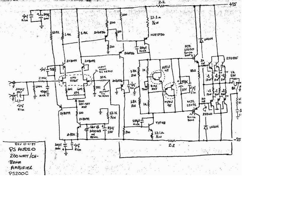

I'll re-attach the layout, and add picture of the amp, schematic (doesnt include full supply section) and proposed layout for the SSR.
