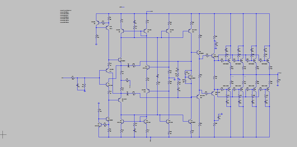

I think I know what you mean. The oscillations you can get from the bases becoming negative impedances and reacting against the potentially inductive impedance of the pre-driver.
The only thing I can think of right now is doing AC sweeps to plot these impedances and then determine how they would interact.

Hello Sandro,
Here is a functioning output stage which I suspect has parasitic oscillation. Could you show how you would do the AC sweep your talking about.
As usual I am interested in you feedback on the circuit.

Interesting ... 🙂Not sure yet... will start with 2 and see if having 3 buys as anything.
Hi Rick, actually my comment was incomplete 🙂. It should have been:
- Given the second stage I have in mind [not showed cased yet), will start with 2 and see if having 3 buys as anything.
For the standard second stage, an emitter follower cascaded with a common emitter, a triple OPS will give you better distortion. Bob showed this result with the BC-1.
This is specially true if you degenerate the common emitter in the second stage which is a bad idea for distortion. I find degeneration in the second stage more a "must do" for current limiting purposes, or if you have to reduce the BW of the minor loop to stabilize it and you run out of ways to do it. Sam Groner, to my knowledge, has the best write up on why degenerating the second stage is a bad idea.
Anyway, I hope this clarifies it.

Hi Arthur, what makes you think there is an oscillation?
Regarding the circuit, looks interesting. I like the scheme you are using to bias the second stage. Did you come up with it?
