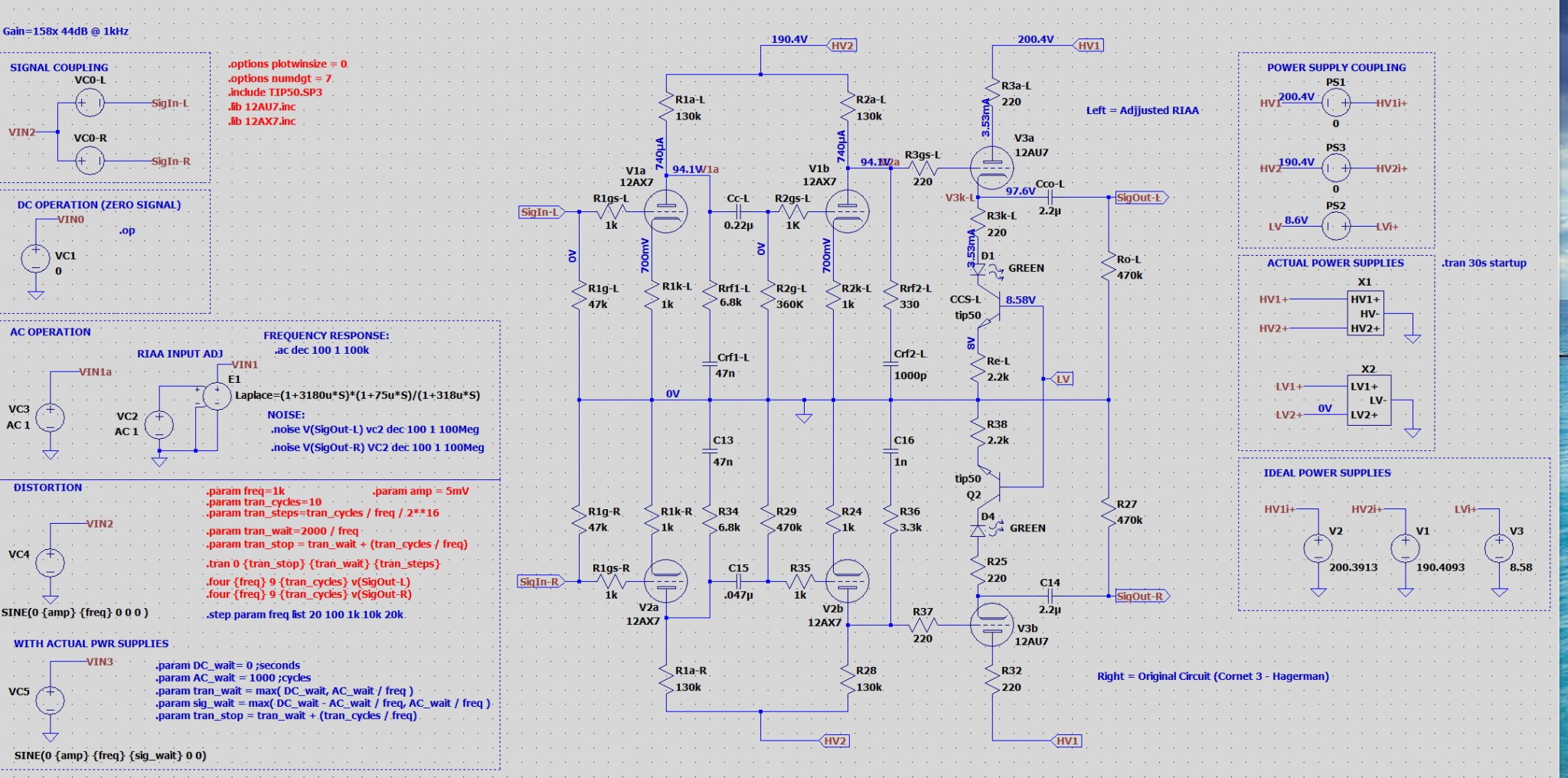

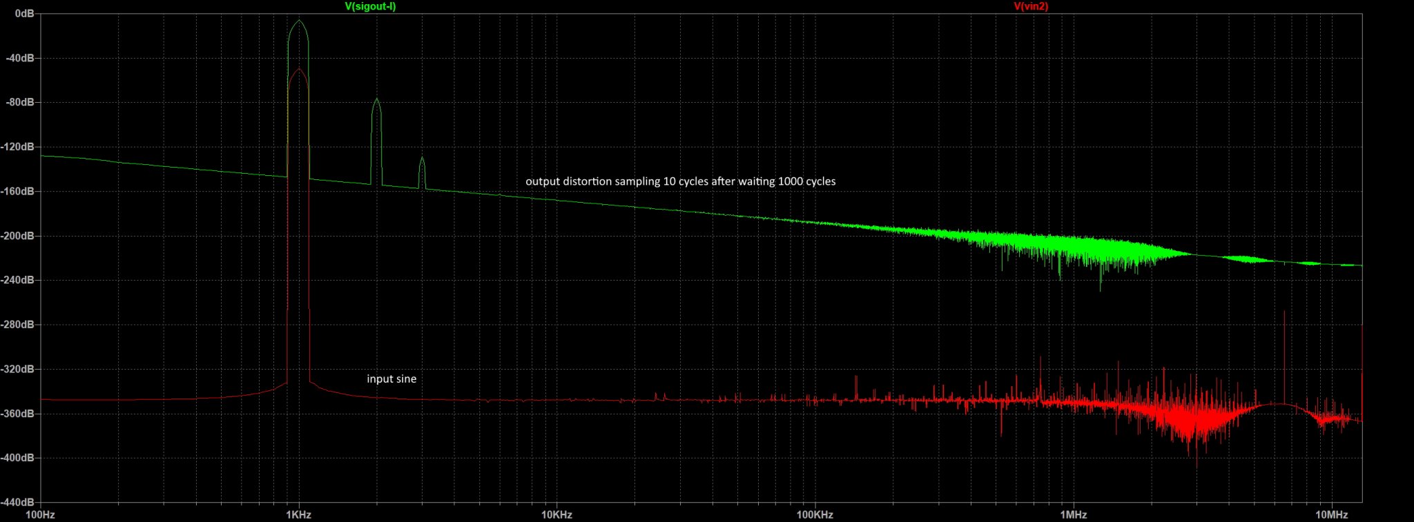

A huge thanks for your fantastic vid series. Although I've tinkered with Audio electronics for a few years on and off, I have a pretty limited basis in theory and your vids have been the best resource I have found to get my head around the workings of amps and LTSpice.
This is probably a pretty basic newbie question, but I have been trying to run THD analysis following your approach on a Tube Phono PreAmp Circuit (Cornet3 by Jim Hagerman) and can not work out how to get rid of the sloping noise floor which is masking the harmonics (its up at -40dB@100Hz). The input sine is ok, but there is no input capacitor or feedback loop in the circuit to short - just 2 standard triode (12AX7) gain stages and a CCS fed cathode follower(12AU7). I assume noise floor issues in tube circuits are treated differently - just wondering if you have any general guidance on how to get rid of them?

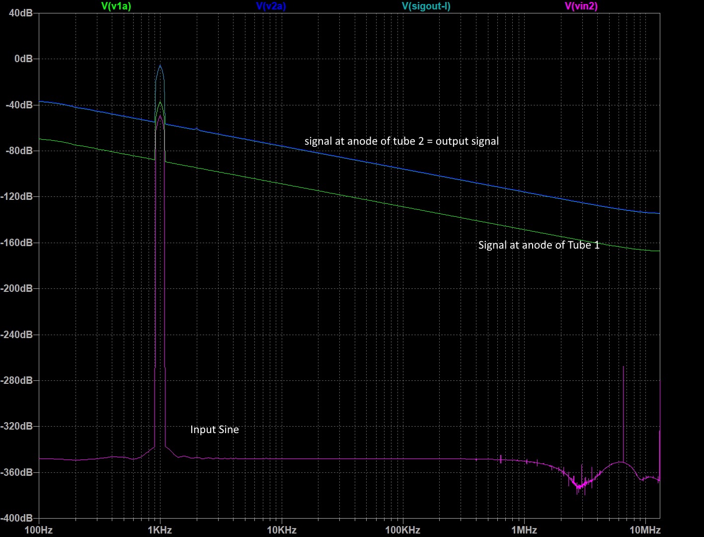

In case anyone else has the same issue, just thought i'd post the solution.Hi Sandro,
Cheers Paul.
As far as I can determine this issue appears to be a much longer "settling" period for Tubes compared to SS amps. By increasing the wait time/cycles before the fft samples the waveform the noise floor is substantially reduced and flattened. Unfortunately the simulations also take a MUCH longer time to complete.
For reference, I moved from Sandro's 10 cycle wait time to 100 cycles to reduce the starting (100Hz) noise floor from c -40dB to c -80db, then to 1000 cycles (1 second wait) to get it down another 40dB to just below -120dB. I assume increasing the wait more will lower it further as the noise floor still has a slope of c -20dB/10x freq. I attach the 1000 cycle wait fft for reference.
Hi Paul, thanks! I wish I had time to continue doing the series. I just got swamped by work.
Do you have a schematic to take a quick look?
Haha - work has a tendency to do that!Hi Paul, thanks! I wish I had time to continue doing the series. I just got swamped by work.

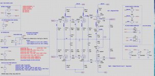

I think the attached are all files required, let me know if I've missed anything required. I also include a jpg of the schematic in case the LTSpice stuff isnt sufficient.
Cheers Paul
Hi Paul, it is due to the output capacitors C_CO-L and C14. Make them ridulously large, say 1 farad, and try again.
Best, Sandro

Out of interest will this change the distortion results or just allow the circuit to settle more quickly - ie should I get the samish THD results with the high cap as by running the sim for a long time as I've done to date?
Cheers Paul.
Cheers Paul.
Given the capacitors are ideal in LTSpice, it should not change any distortion results. All it does is lower the output time constant so that it does not mask the low frequency harmonics. NOTE: If you still do not see the noise floor with 1 farad, make the caps bigger, like 10Kilo farads and so on.
