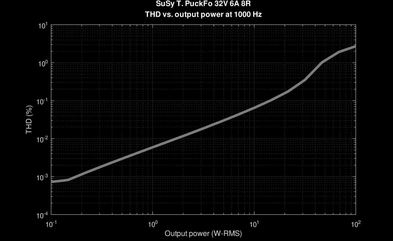

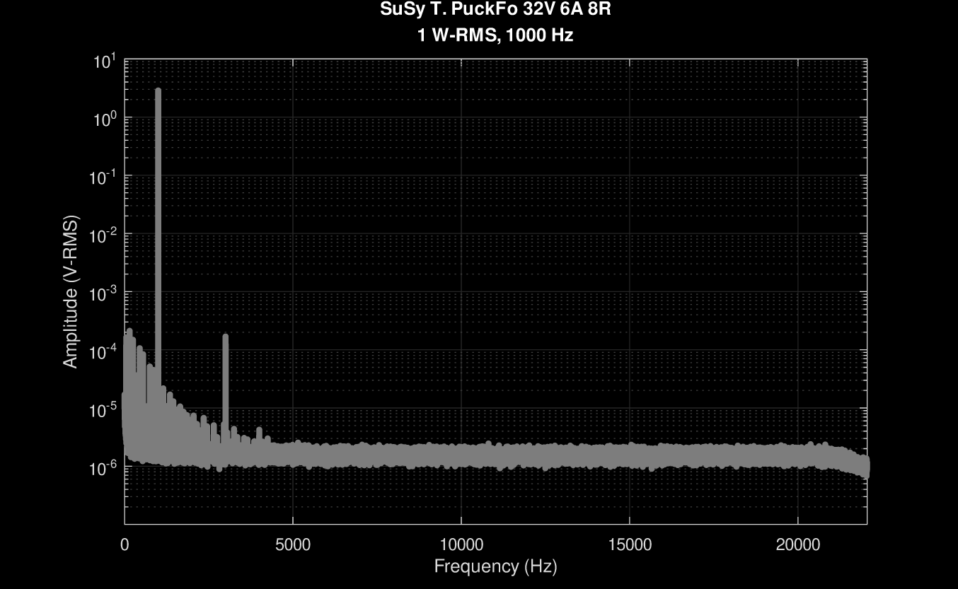

I spent some quality time in the workshop. Here are some distortion measurments from the output stage. The OPS was driven by a low-distortion test amplifier AC coupled to the THF51 gates. DC biasing was done via 100k resistors (not via the FET buffers shown in the schematic of post #31).
If the idle currents of the two OPS halves are nicely balanced, the 3rd harmonic dominates, and the 2nd is hardly visible at 1 W output. If desired, the biasing of the two halves can be set to a slight imbalance, which brings up the 2nd harmonic. I am not in one of the "2nd > 3rd" or "2nd < 3rd" camps, so I am happy with both.
The THD is at single-digit ppm levels at low power, and increases smoothly with power. The usual "kink to the sky" when the amp starts clipping does not happen here, as the amp has very smooth clipping.

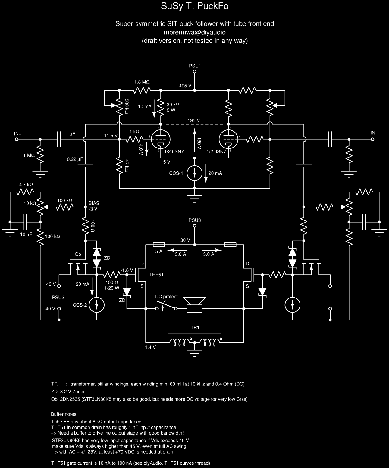

I realised that I confused the 6H5pi/6N5P double triode with the 6E5P tetrodes that I found in my stash. I don't have any 6H5pi/6N5P double triodes, but I have many 6SN7, which are speced very similar to the 6H5pi/6N5P. I therefore changed the design to use the 6SN7 instead. I hope I'll find some time to mess with the tube front end during the next few days!

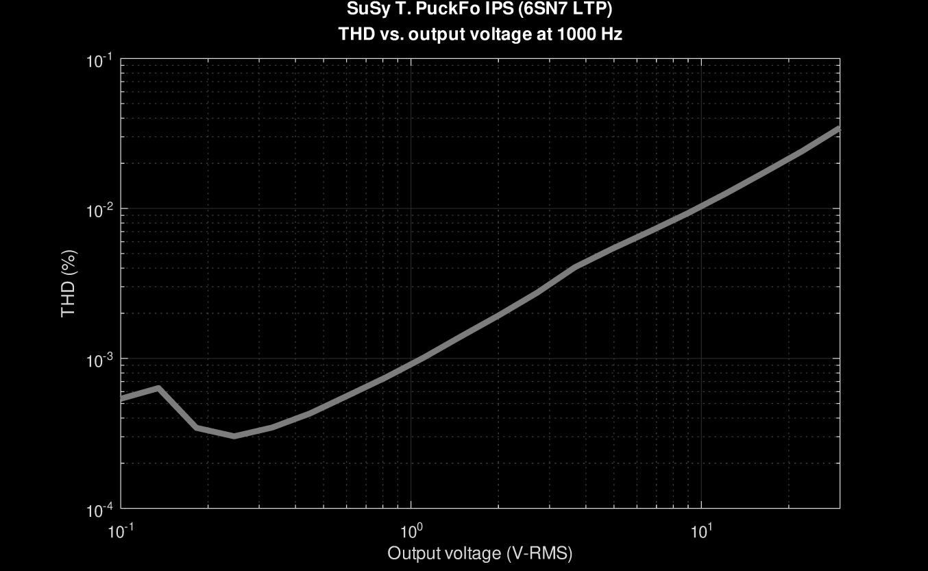

I made a test setup of the 6SN7 input stage today. Once I fixed some wrong values of the resistors for grid biasing, everything biased up as expected. AC voltage gain is 15.6, and the stage works pretty clean. The THD data in the attachment were done with a random 6SN7 that came out of the drawer, and without tweaking the biasing points.

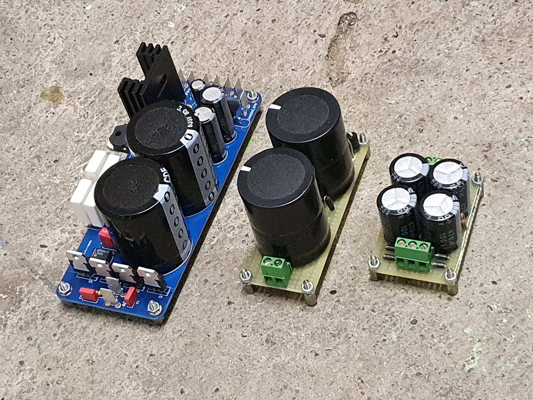

The schematic of the HV power supply is in post #31. Part values are not yet final. I will need to figure out how to fit the PSU (mainly the capacitors) into the limited space available inside the chassis.And the HV power supply.

I think the main schematic has PSU2 and PSU3 connections reversed.
Yes, you are right. I am still adding some other minor changes and details. I will post the revised schematics when they are ready.I think the main schematic has PSU2 and PSU3 connections reversed.
