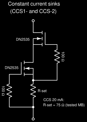

I intended to use two DN2535/DN2540 for the CCS sections anyway, so to keep things easy and simple it makes sense to use a DN2535/DN2540 for the buffer, too. It's also nice that the DN will work fine at a lower voltage (unlike the STF3LN80K5). I'll have to change the biasing network a little bit to accommodate for the different Vgs, but that should be easy.

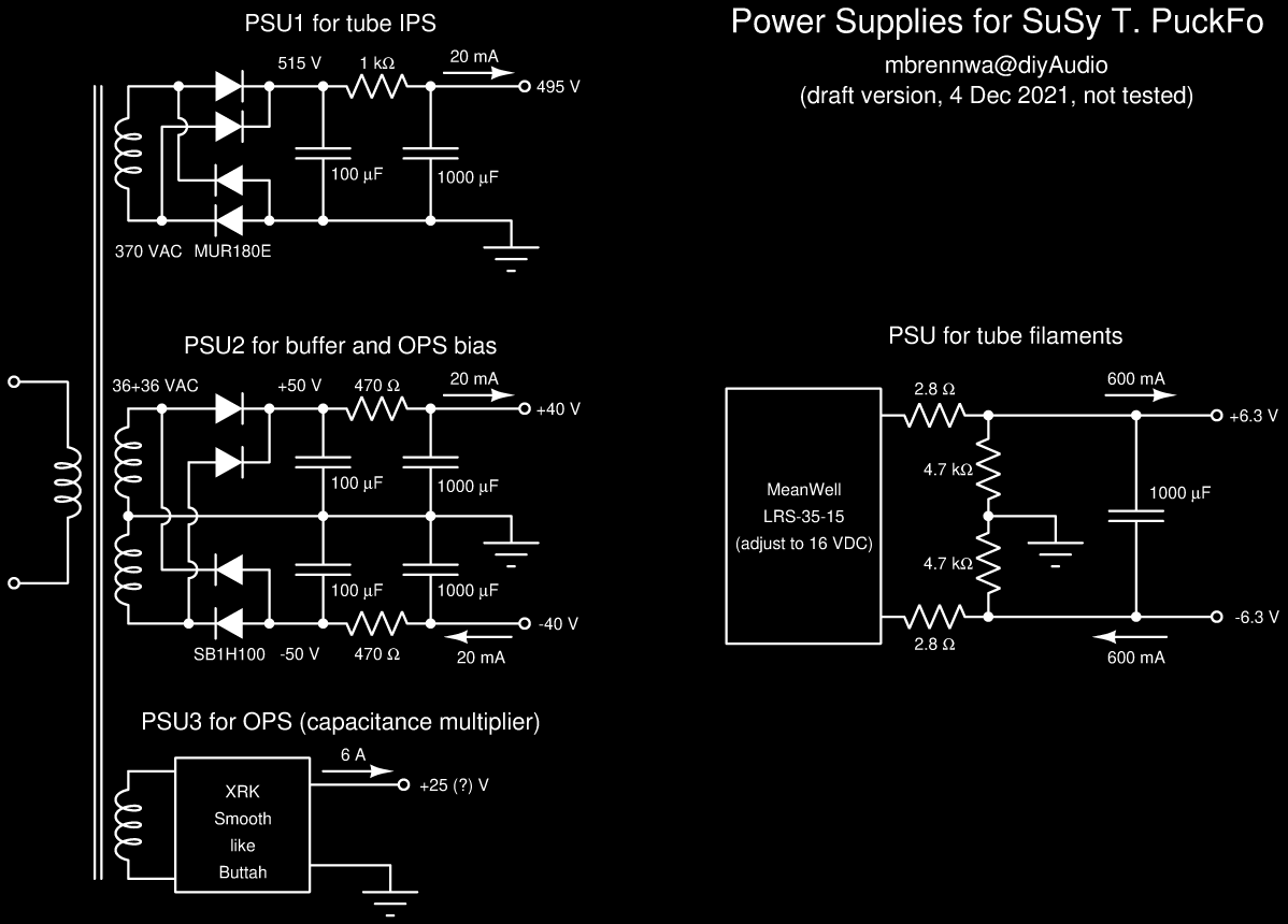

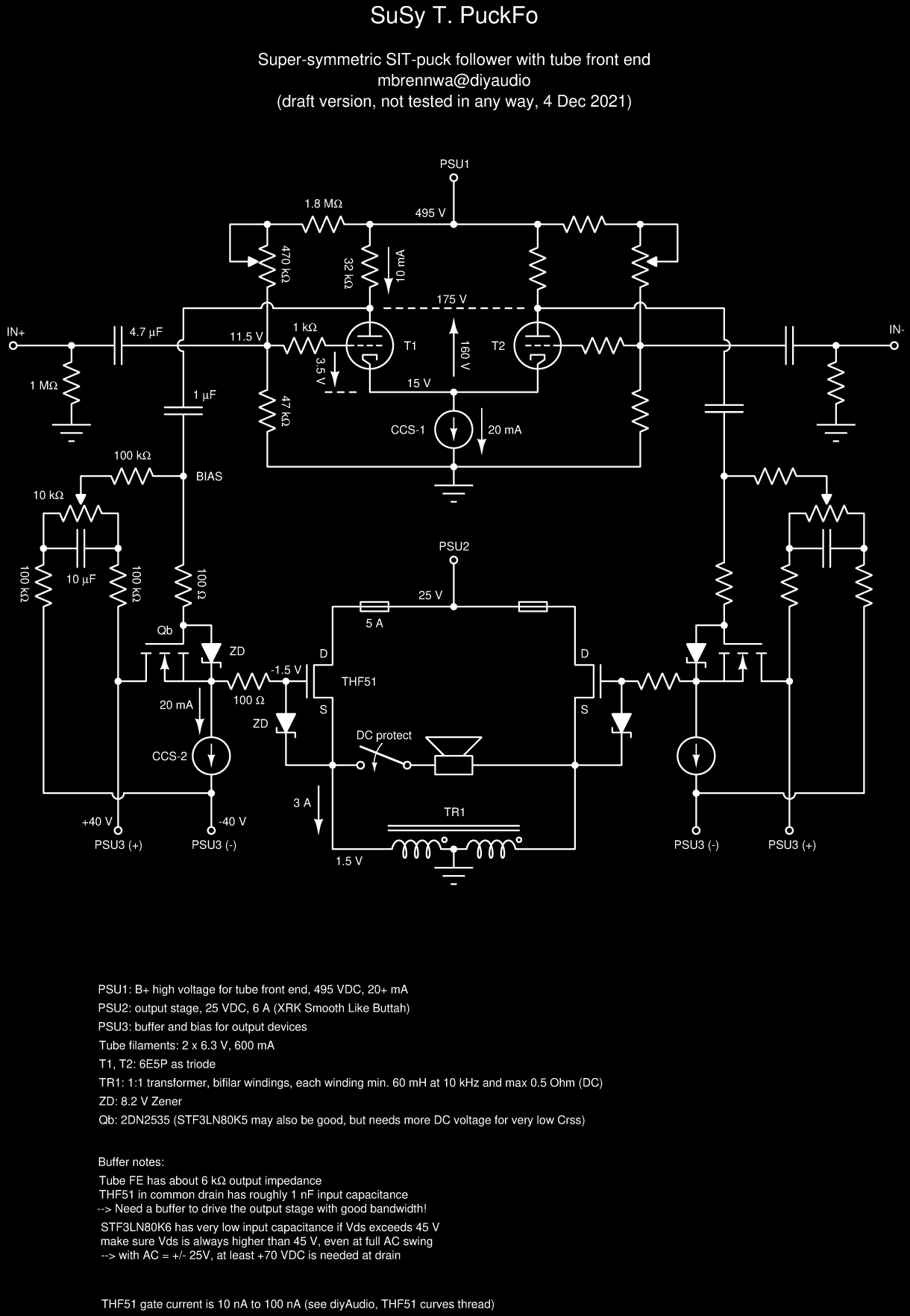

Here's some new and revised drafts (main circuit, PSU, CCS). Let me know what you think.

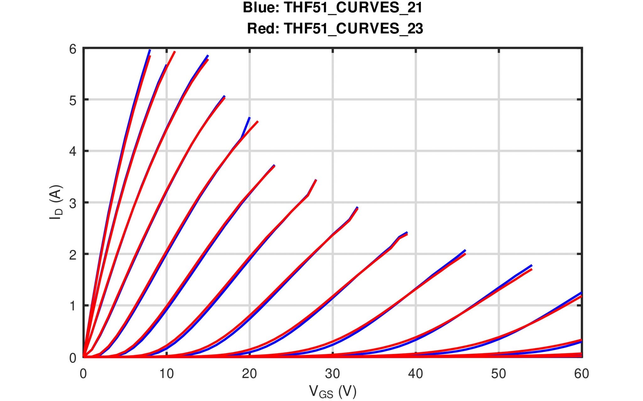

The SIT gate needs to be at about -1 V to -2 V. The Vgs of the buffer FET (2DN2535) is about -1.3 V, so the buffer gate is close to 0 V. To allow some flexibility with the bias (-2 V to +2 V or so), a bipolar bias supply is needed. The buffer needs this anyway, so it's no extra complication.
Hold on, I believe ZM was right... I just built a mockup of the buffer and realised that my brain got the Vgs of the buffer FET backwards. The FET gate needs to be more negative than the source. The gate of the buffer FET gate therefore needs a more negative voltage than the gate of the SIT. The bias network can therefore use GND instead of the +40 V connection.
Also, when I was playing with my mockup, I blew the buffer FET (twice). I wasn't particularly careful, and I didn't have the protection Zener on the buffer FET. This may explain why the buffer FET went kaputt, but it also got me thinking: do I need a second Zener with reversed polarity on the buffer gate?
you need protective zeners for both SIT and mos
orientation for mos - just check what they say for max Ugs - is it positive or negative, orient zener accordingly
DN2535 datasheet says +/- 20 V. That's why I was thinking... TWO Zeners needed?

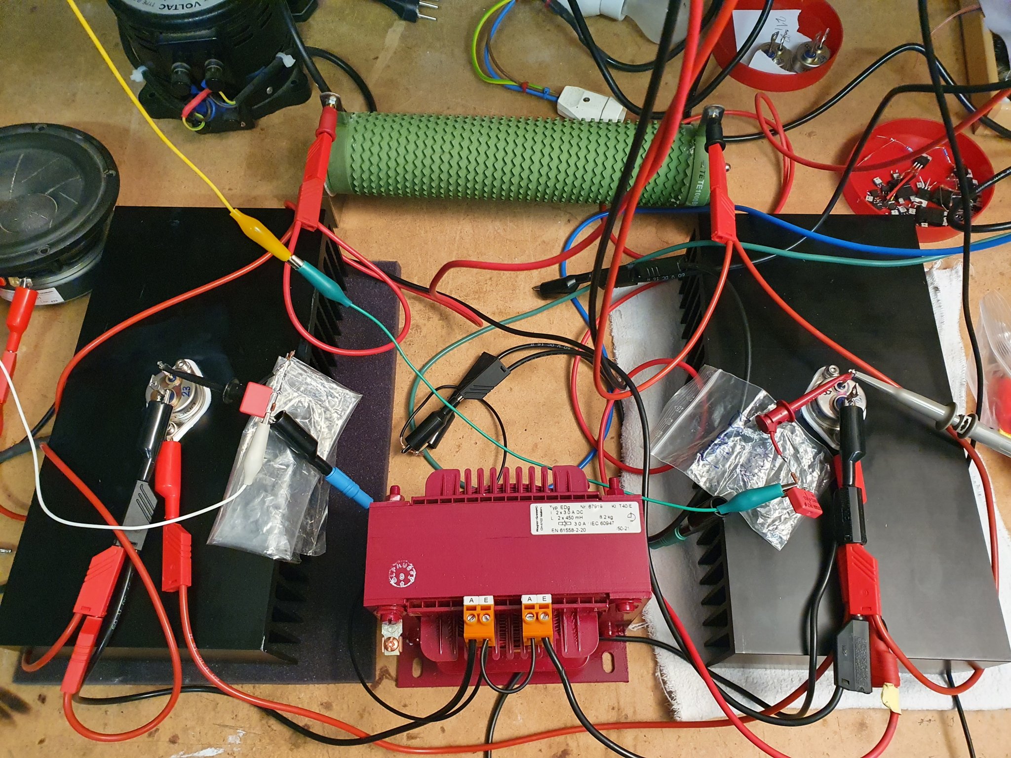

I matched some Tokins and then built a first mockup of the output stage. It's alive!
Biasing worked out as expected, and I managed to increase the rail voltage to 32 V and idle current to 2 x 3.3 A, where the heatsinks were still way cooler than in some of my previous amps.
Some first quick measurements are promising. I could get some very clean 50 W into 8 Ohm, and the onset of visible clipping on the scope was somewhere at maybe 90 W.
When I switched to music, the music peak voltage recorded on the scope was 30 V. The workshop dummy speaker made some nice music, so I lost interest in the measurements. It can go much louder than I'd ever want in a normal listening session.
