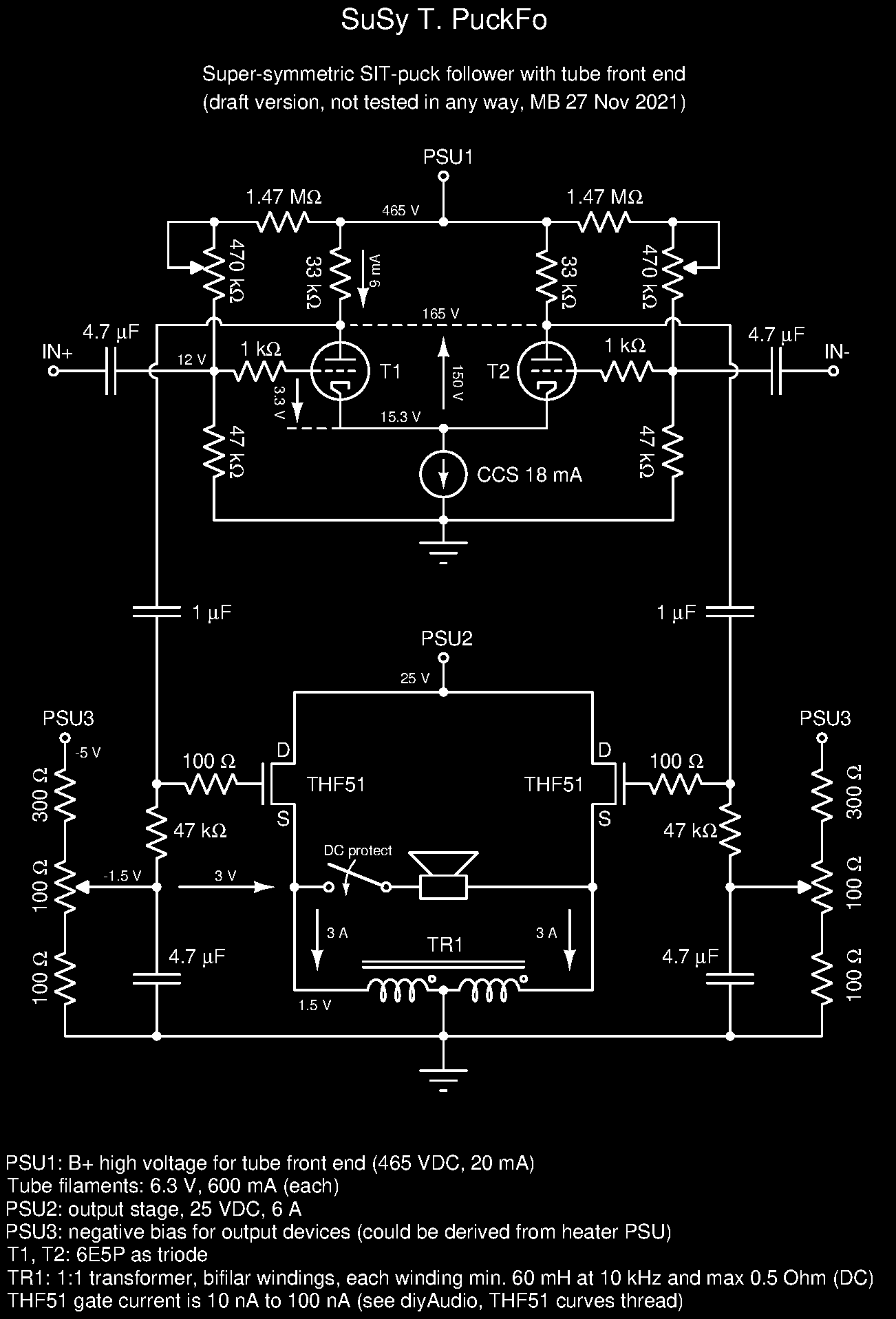

I really like the Fokin, LuFo, and SuSyLu designs. They are all nice for different reasons. I want an amp with a choke load and some Super Symmetry. I want to build an amp with my Tokin SIT pucks. The amp output power should be a bit higher than my good old F5 and Aleph-J. Oh, and I'd like to have some tube glow for voltage gain in front.
I already showed my simplified schematic idea here. Now that I decided to go ahead and make something of my good old SIT pucks, it was time to dream up a more complete circuit. Say hello to SuSy T. PuckFo!
Please take a look at my first draft. The front end is a long tailed pair of tubes for differential input with a voltage gain of approximately 24x. The output stage is a differential pair of THF51S source followers with a balanced choke load for SuSy cross coupling. Extrapolating from the SuSyLu, I'd expect close to 100 W(rms) output.
It will be a while before I'll start building the thing, so don't hold your breath to read about magic smoke or to see fugly photos.
Any thoughs or comments?

that's just me, but I really prefer ballsier drive of these Tokins
introduce some NFB at least, so you'll have both proper SUSY and tighter drive
why not introduce cathode followers
or introduce source followers, DC connected to SIT gates, and everything goes notch up

Interesting points!
(1) What do you mean by proper SuSy? What is not proper here?
(2) A cathode follower or source follower is typically used in tube amps to avoid "farting out" when the power tube starts drawing grid current; this is not an issue with the THF51 (I measured the gate current to be 100 nA or less). Also, a follower may be useful as a buffer if the gate exhibits a high capacitance to the front end. What is the capacitance into the gate of the THF51 in this configuration (source follower)?
Adding a source follower/buffer is an option, but would require a bit more circuitry. Since the follower will have some dropout voltage, it would require a high drain voltage to prevent limiting the AC voltage swing. As far as I can tell, this would require a dedicated power supply for the follower stage.

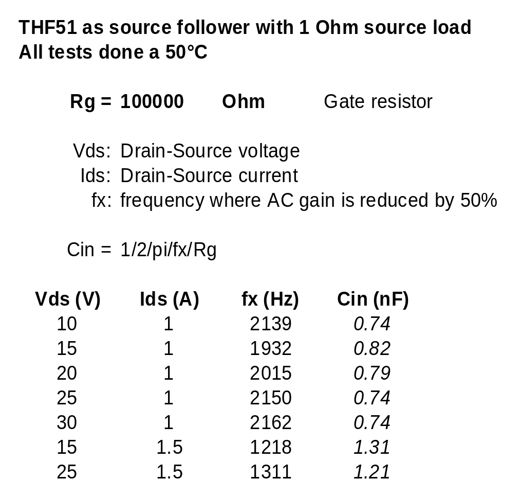

whichever way, all of them are leading to Rome
Tokins are exhibiting some gate current drift in time/temperature domain, ad that's largely neutralized if you have them DC connected to previous stage, with decent low Rout
also, whatever their capacitances are, I feel better when I know that I took care of them in same manner as in sentence before - dunno what is nature of them in voltage domain , but what we know is that these are lowish rail voltages for SIT ........ if anywhere is going to show nonlinearity of important capacitances, that's in lowish rail voltages domain

Proper susy is exchanged negative feedback from one side to the other, otherwise you're classic diff. No harm there either.
Yup. I measured the gate current a while ago. It was between 10 nA and 100 nA, depending on temperature. That does not worry me much.
I just looked at the input capacitance of a THF51 operated as source follower (see attached numbers). The values were about 0.8 nF to 1.3 nF, depending on the operating/bias point. I used a pretty simple set up, and I could not take the bias current as high as I intend to run the THF51 in the SuSy T. PuckFo, so these numbers may not tell the whole story... but: the tube LTP front end has an output impedance of about 6 kOhm. Running this into an 1 nF load, there would be a bit of roll off at 10 kHz and above. Not great. I guess a buffer is in order!

Isn't that exactly what the transformer load does? I am not a lawyer, and it may not be SuSy sensu strictu as in the patent, but it is SuSy at heart. See this post (and the surrounding discussion) for what I mean by this.
Those Tokins need a fairly low impedance for good bandwidth. What do you expect for plate output impedance?
Operated as Common Drain followers, these parts will go higher than 100 KHz with
a 600 ohm source. 6 Kohm, not so much...

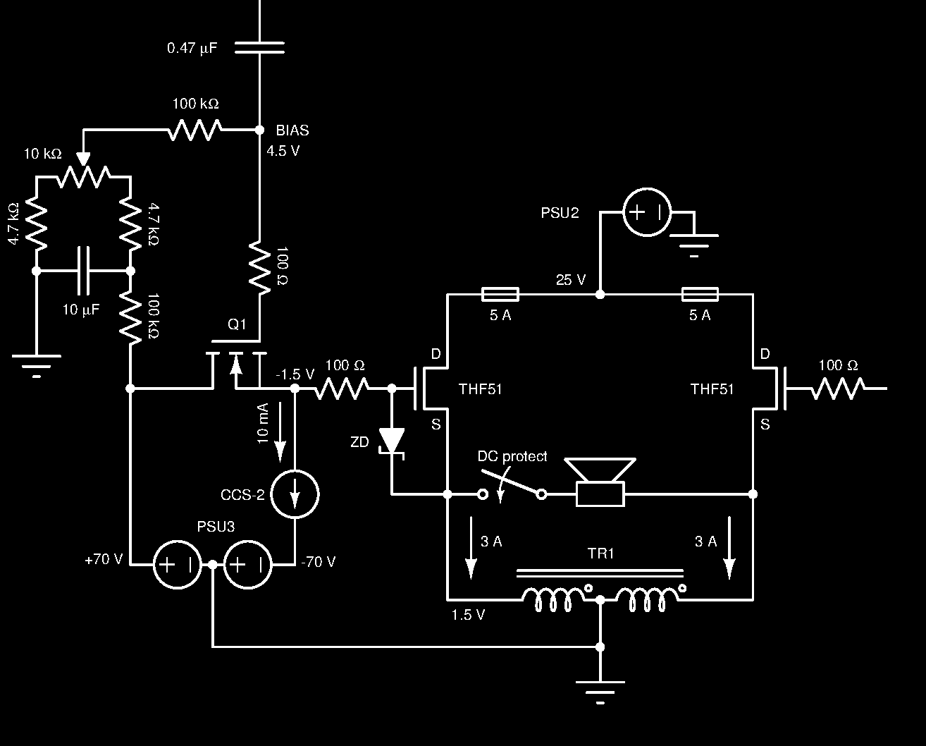

Thinking about the buffer a bit, I re-read this thread. While that was aimed at driving a power tube, most of it is probably still meaningful for driving a SIT.
Some thoughts (and questions):
- Which FET part would be a good choice? The SissySIT R.3 uses an IRF510, which has Crss of about 20 pF and lower for Vds > 10 V. The STF3LN80K5 recommended in the above thread will go down to 0.1 pF, and I already have a bunch of these somewhere. Thoughts?
- I'd operate the follower buffer on a CCS load. How much current should it be? 1 mA? 10 mA? 100 mA?
- What happens if the buffer FET fails, pulling the gate of the SIT very high of very low? Will that kill the SIT? Would it work to use a very-low power gate resistor on the SIT as a "fuse" (like a 50 mW part)?
if choosing mosfet for "power drive" I believe George did cover it all in post #7 of that very thread
buffer Iq ...... I chose 10mA for buffer in my Singing Bush ...... simply by Thumb of Mighty ZM Rule
if it fails ....... SIT must have protecting G-S zener, foor excessive negative gate voltage
put hefty fuse in positive rail and you are good
Protection just for negative Vgs? No protection needed for positive gate voltage?
What Zener voltage would be recommended? I have no clue where the limit for the Vgs voltage is with the THF51...
7V5 or 8V2 will do
SITs and VFets are , at least to my knowledge, sensitive to excess negative gate voltage
for positive - newer read and never seen protection implemented

It's a Junction Fet.
For N channel part the junction from Gate To Source is a diode, and will
protect itself at about 0.6V positive.

put zener in front of SIT gate resistor
you don't need +/-70V for buffer
use +25 and as much you need of negative rail; if you have just 70V at disposal, either put reg or cascode that 10mA CCS from below ...... practically making it cascoded CCS

Okay, maybe I need to explain why I did what I did. My ideas may be off, so please let me know if I am missing something (and what).
Zener connection at the gate:
I put the Zenter directly at the gate (not before the the gate resistors) because I was thinking to use the gate resistor as a "fuse". It the gate voltage goes too much negative, the Zener will start to conduct, and the current will flow through the Zener. If the voltage applied to the gate resistor becomes very negative (aproaching the -70 V), the current will increase and blow up the gate resistor, thereby disconnecting and protecting the gate.
Also, Nelson seems to connect the Zener directly to the gate, not before the gate resistor (example: https://www.firstwatt.com/pdf/art_diy_sony_vfet_pt2.pdf).
+/-70 V for the buffer:
As mentioned in the thread/post mentioned earlier, the buffer FET (STF3LN80K5) has very low input capacitance (1 pF or so) if it has 45 V or more across drain/source. To maintain the low input capacitance even under full AC swing (25 Vpk or so), we need 45 V + 25 V = 70 V.

still at first coffee, skipped across fact that you need full blast at SIT gates (follower)
all good
zener - in practice it can be at any side of gate resistor; it just depends what you're thinking you're going to protect
I know for one case where Pa added protection zenner later, along with additional "gate resistor" so anode of zener is sitting in between two gate resistors , cathode to source
all good
If you plan a 10ma CCS2, an LND150 (a Lateral DMOS) would give a better input capacitance characteristic and work fine with a +/- 12-24V PSU.+/-70 V for the buffer:
