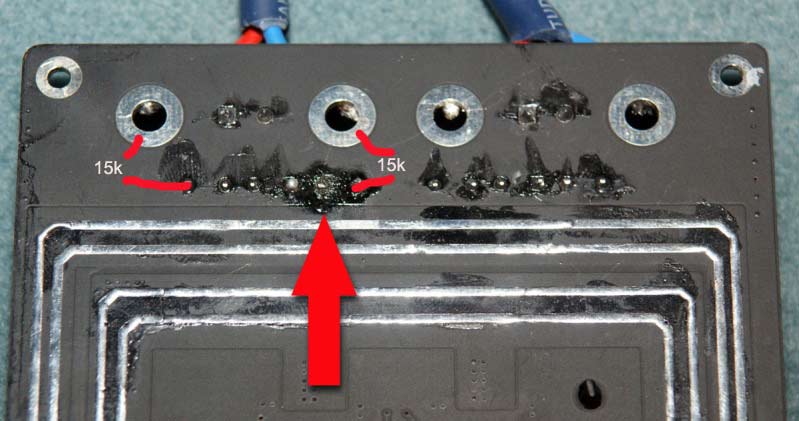

Barbieboy,,check the resistances against the ones in the picture. If the side nearest the arrow reads zero ohms then it could be that you need to clean the area around the pad pointed to, it could be grounding, or you may need to replace that cap completely and solder in a different position.

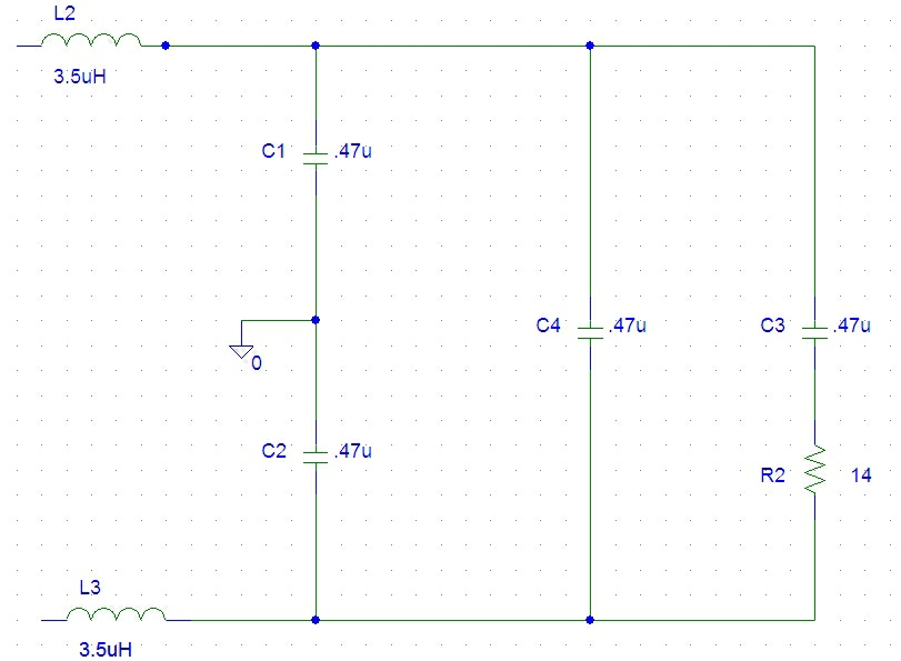

Hi Barbieboy, try adding a link as shown in 1st pic..
To check your inductors are soldered to the pads, you should have near zero resistance between the points in pic 2..
Hi and thanks Audio1st, did the link as you directed and checked the readings in pic2. Still getting the same clicking out the tweet and screeching out of the woofer.... There was zero resistance on both channels. Must be one of the caps blown ?
Please measure all caps. I think you might have burned one
Looks like I am getting no reading from C47
Measure resistance through each cap. The bigger ones should read 16K because of the circuit they are in. Although the one with the missing pad may not be in the circuit. The smaller one should read 32K.
The reason that the one pad won't take solder is probably because the pad is no longer there. You will have to run a jumper according to the schematic to the next closest pad. That is probably the shorted cap that any way. If it is shorted, you will need to replace them all so that they match. Always check the DC offset again with a resistor for a load before connecting to your speakers and fine tuning.
Thanks Scott, but is starting to look like C47 cap is the problem, ironically one that I did not remove and is the least burnt by the side of the soldering iron or them all....

Ok thanks, and thanks for the red lines to show me where to dig. Ok, the end cap C47 is giving me no reading. For the others please see my pic. The other channel reads as Scott said = small cap 32, big caps 16 and 16 out to the speaker connectors

It looks like you will need to replace c47, (680nF). Zero ohms means it is shorted to ground. Remove and remeasure the board in case the board has a short and not the cap.
Ok, just removed C47, and get zero readings from the board and the same from the removed cap itself.
On C49 getting a reading of 16. But for the same cap on the other channel that works fine I am getting a reading of 32.... I believe that should be the correct reading according to Scott.
