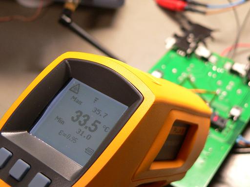

Man what a great laugh this thread is often giving me! Keep it up, those crazy heatsink pics! It reminds me of the Signetics WOM datasheet. Look at the part about 'COOLING'...
http://www.national.com/rap/files/datasheet.pdf
41hz AMP15 running at + and - 60Vdc, 6.8R 200W dummyloads (running HOT!)
Fet temperature after 1 hour running and NO heatsink.
This is class T!

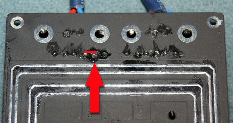

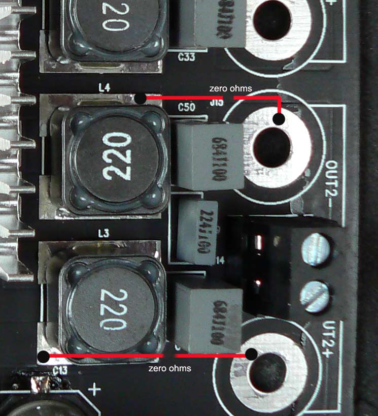

Arrrggg... things are getting worse for me with these Wurth coils.... Ok, took them all off and redid them, now one channel is fine hooray, but the other is far from happy. Getting a sort whining noise when connected to the woofer, or a Dolphin like clicking through the tweeter.... Set my meter to 200k ohms and got a reading of 15.8. The other channel that works fine is 32.0.
Any ideas ? One thing that I have noticed is C50 would not take any solder when replacing it (removed it take make room when fitting the Wurths). Please take a look at my pics of top and bot of my board.
Hi Barbieboy, try adding a link as shown in 1st pic..
To check your inductors are soldered to the pads, you should have near zero resistance between the points in pic 2..
Short
Measure resistance through each cap. The bigger ones should read 16K because of the circuit they are in. Although the one with the missing pad may not be in the circuit. The smaller one should read 32K.
The reason that the one pad won't take solder is probably because the pad is no longer there. You will have to run a jumper according to the schematic to the next closest pad. That is probably the shorted cap that any way. If it is shorted, you will need to replace them all so that they match. Always check the DC offset again with a resistor for a load before connecting to your speakers and fine tuning.
