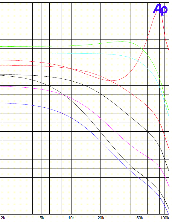

Don't forget that on these amplifiers, where the NFB is taken from before the output filter, that the optimum values of L and C in the filter varies with the load impedance. For example, a simple SPICE simulation of the filter shows that for 4R loads, the best inductor value is around 10uH, whereas for 8R loads, a value of around 16uH is better. (Obviously the capacitance values also need also to change to give the optimal load matching and the flattest response). I'm a little surprised that some people seem to think that you can tune the output filter by ear! A simple frequency spectrum sweep into the desired load is better. (There's plenty of s/w out there to do this if you have a good sound card to use as the audio interface. I use ARTA for the measurement s/w.)

Check out the graph below, which shows actual measurements of a TC2000-TP2050 amp for various loads (2ohm to 8ohm). There is a peak at 6 ohms (red line) that can be noticed with listening tests, yet the response is flat at 7 ohms (cyan line). So obviously, the load impedance is a variable. Since the impedance of most speakers will vary with frequency, the type of high frequency driver being used in the test is a variable. And, of course, the inductance value is a variable. Inductors will have different saturation levels, so listening level is a variable. With this many variables it is difficult to make meaningful comparisons of cores types or inductance values with just listening tests.

Why does your sim show such a different peak at 6 that doesn't follow the trend of the other loads on either side of it? My simulations always show a continuous trend of increasing peakiness which would show the 6 as a little more rolled off than the 7.
You want to talk about a peak, add a minimal amount of inductance, 100uH, to the load as any speaker driver will actually have, and try getting rid of that peak in your filter with any load.
A peaking output filter that is flat at 20K may be necessary for the best sound from a wide variety of speakers and will sound much better than an aggressive textbook filter with no peak which is down at 20KHz with increasing load.
It's not a sim. It's a real measurement from a circuit that has basically the same topology as the Tripath data sheet.
Why does a 7db peak at 60k have to be seen as a bad thing?
Maybe it's not, but my understanding from those who were doing the testing is that it resulted in audible sibilence. Can't verify it myself...
